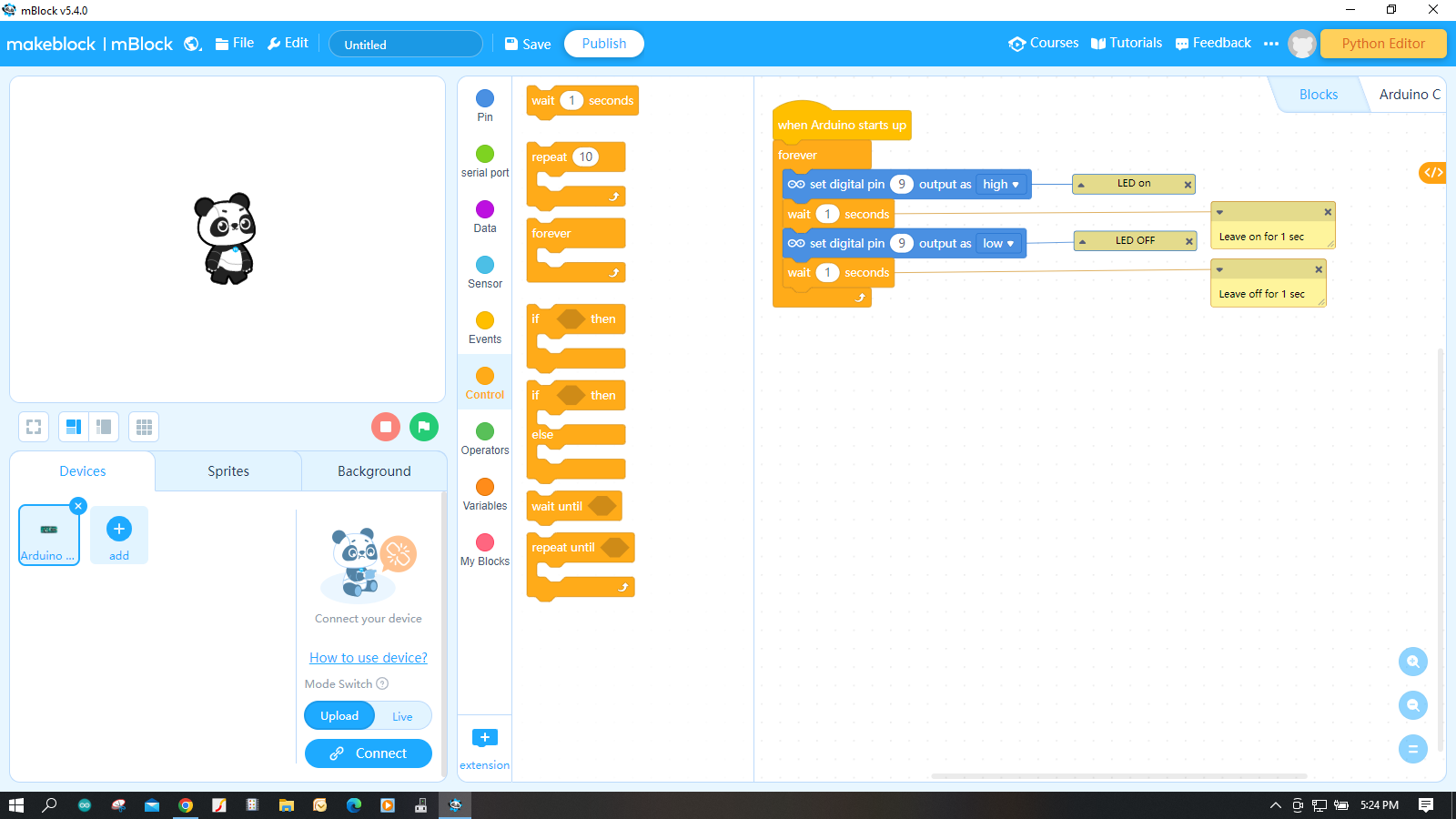

You might want to investigate micros via block programming for a future experience.
Using a $3 Arduino Nano board you can blink an led this easily -
You drag the blocks out of middle window into right window, config them, like
pick pin number to work with, and mBlock (this free program) generates Arduino
code from the blocks and programs the board. So all you have to add is an LED
and series R to the pin, do the block programming, and you are in business.
Here is a more sophisticated design, but still quite simple to create -
Even talking voltmeters become easy as you progress -
Lots of fun. Videos on web for learning.

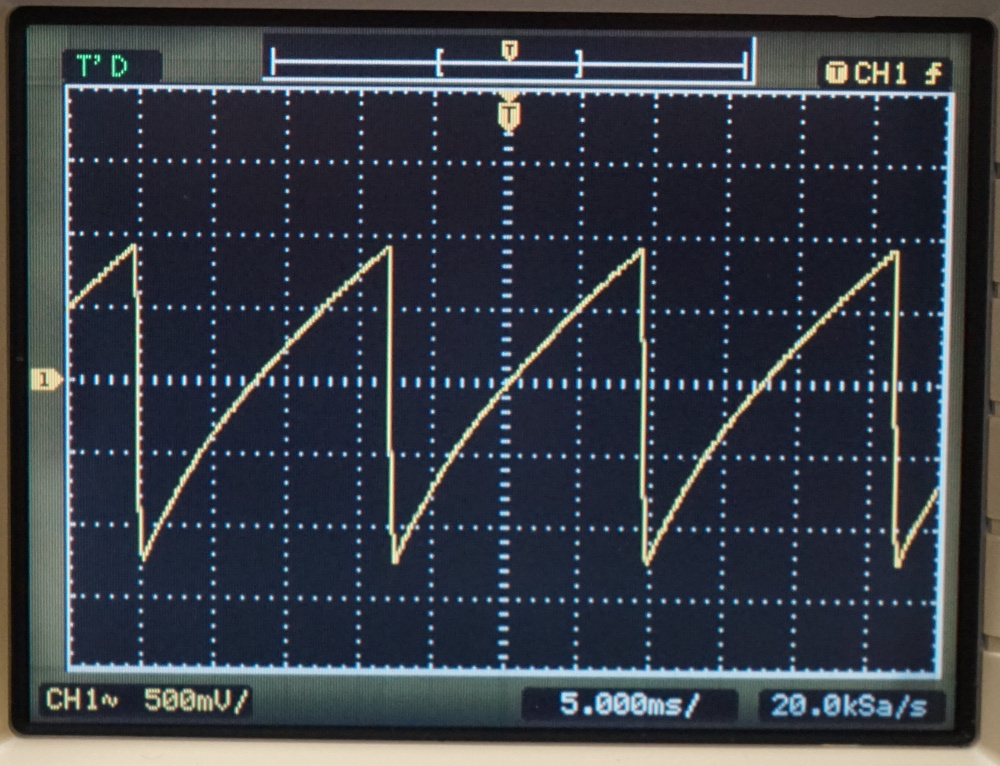

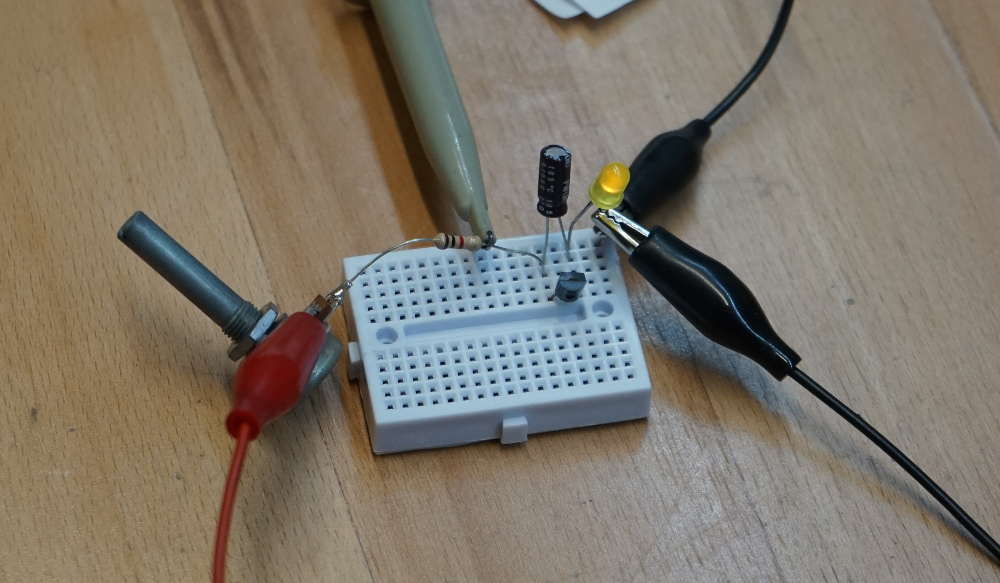

Amidst all the debate about this oscillator, has anyone tried to build it to see if it works?
Well, I have.
Look here:
On the breadboard
On the oscilloscope
So, in answer to the original query, yes it does work.
The components in the OPs parts list are OK, and he has a good chance of it working.

This circuit relies on the abrupt breakdown of Veb with V+ on the emitter of the NPN and with the collector on the low side the Vbc is forward biased such that it takes at least 7 or 8 V to Trigger the breakdown. The Not to Exceed Specs would be Vebo=5V + Vcb=0.7
This breakdown comes fast like a unijunction and a DIAC or an SCR, except in a tiny junction that cannot afford much current before the peak energy density causes physical damage in reverse breakdown mode. It works well but with severe current limitations.
3 CMOS inverters or 1 Schmitt inverter may work down to 3V and be more reliable.
