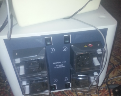

Then we have a brand new 4 head peristaltic pump system like the ebay one, trouble is you have to have various sensors connected and the pumps have 240V female plugs like the opposite of a kettle. Again not too bad, except I have to have a way to control pump speed and a way to determine when each pump is on or off. My main issue will be speed control, on and off will be via PH probes etc.

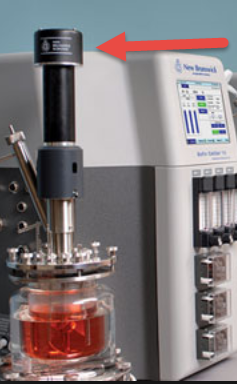

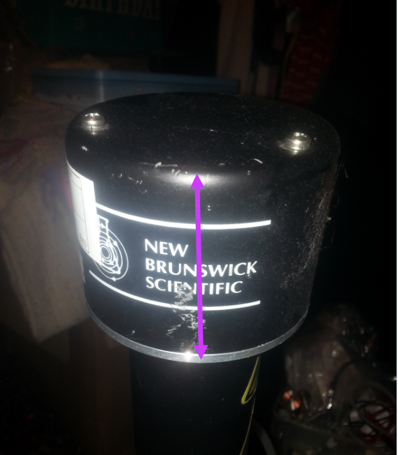

One i am pretty sure the top stir motor is a stepper, heavy duty and fairly small. I have zero idea how i would begin to find the voltage for it!!

Oh and nearly forgot....... Those 4 pumps, HMMmm nasty, need to get a rough idea how fast they turn first then decide.
Can you do an image search, or search for motors with similar dimensions, to try and find a match? That would likely put you in the ball-park for supply requirements.
I am pretty sure its a widely used unit Alec, part the problem is brunswick dont make it, they badge it up along with 12 other people lol. I will get you a picture downloaded later, i took some last night. I will hunt the net as well, i have seen similar motors all over the place, the stems are all a bit different but the actual motors are the same. Its just the couple unit differs depending on reactor used.

got this off the net, i will take a better one later.
Found a brochure, the actual main control unit is different, but everything else for the 1.3 ltr is the same. More importantly the direct drive motor (black bit on top) is the exact same one. What is confusing is the specs, it says 110V -220V, the problem is parts of the system are 110V and parts are 220V... dosnt say what the motor is, i think it says the motor can be both, but its real expensive to get wrong...

It has 8 pins, i will take the top off and look at the connections, its def a stepper.

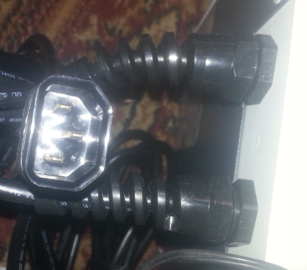

Attached is the motor section and the plug
pump unit and plug type for the pumps, each pump has a separate plug, The DSO and PH units are also brand new, these i am likely to replace and just use the sensors.

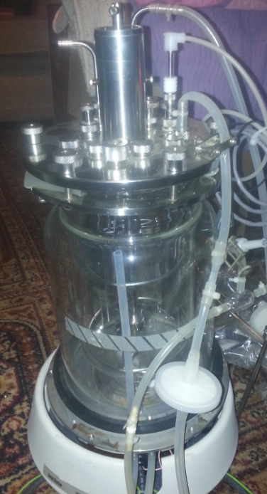

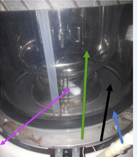

Ok this is the main heat unit with the stir bar section, this is a separate stir unit designed to stir the water jacket.
Pink arrow is the stir bar, i suspect this is low voltage, normally like most hotplates they are simply a rotating magnet. Something almost like a pcfan with a strong magnet on one part!
Black arrow this is the base of the heat plate, i have taken alot of the reactor apart to show these details. The blue arrow shows the outer water jacket, this is attached to the inner jacket and they are fused together. The bottom is supposed to come off, but mine needs a yeast soak.
Green shows the inner reactor where the magic happens. this has all kinds of sensors and level detectors in and things like air and gas sparges etc etc etc.
The two pipes at the bottom of the pic are the outer jacket feeds, while the jacket is heated by the plate, it allows fast evac for quick chilling ect, in my case i will have 6 reactors connected in series, 3 of them heated by this unit, two of the other reactors have heating coils of stainless steel so the water from the jacket will pump in and out the the jacket via these other coils, the pump for this is a tiny 12V one and not an issue for now.
This is the unit 4/5ths stripped back to basics, just to give you an overview of it.
