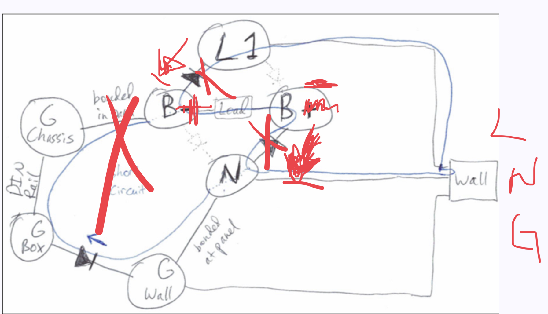

I am posting a thread similar to an old thread that Crutschow chimed in on with good advice; our application, however, *slightly* differs from the OP.
We ran into a similar "spark" issue when we energized, via a standard 120VAC wall outlet (service line at building) an AC/DC power supply /bridge rectifier that is installed on a piece of trailered equipment for off-grid use. We noticed that the trailer equipment assemblers jumpered N and G within the box on the trailer, so basically another jumper downstream of the neutral-to-earth bond at the breaker at our building.
We are going a bit back and forth about what to do. Here are some of the known facts:
- When we remove the jumper from N and G in the trailer equipment box that is downstream of the breaker box in the building, but upstream of the AC input to the bridge rectified power supply, we do not have issues with the power supply performance, or any sparking.
- When the jumper is used, it sparks.
- We use similar AC/DC power supplies on other equipment, where G from the AC input and V- from the isolated DC output are chassis grounded. I have not had issues with these, presumably because I do not jumper N and G.
My questions are:
What is the right approach here? Do we continue to not jumper N and G? As far as I understand (and I say that loosely) NEC prohibits secondary neutral-to-earth bonds anywhere other than the service panel / origin except in special circumstances with secondary equipment.

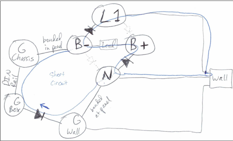

Or do we jumper N and G (seemingly a needless echo that they are ultimately jumpered somewhere else) and just place a diode between the chassis ground of the trailer and the ground of the wall outlet? (See pic) I have never seen this approach done on any oil&gas / industrial installation I've worked on.

if i got your drawing interpreted properly, you have a diode between L1 and B-(which is tied to ground)... that alone is enough to create a "fireball". L1 and N should go to the AC input terminals on the power supplies. if there's a frame ground for the supply it should go to the panel ground. the AC ground from the wall should also be tied to the panel ground. don't assume N is N at the wall outlet, as it's a common error made in outlet wiring to have N and L reversed, which is one reason NEC says not to tie N to chassis in the equipment. you can verify proper wiring with one of those outlet testers from home depot, it will tell you if N and L are reversed and whether or not G is grounded.

Also, your diodes are making the pole you labeled "B+" the negative DC pole. I think you need to flip your diodes.
Sorry for the confusion. The two diodes (one between B- and L1, one between B+ and N) were scribbled on there when we were analyzing current flow during one of the swings of the AC voltage. Those do not contain diodes. The third diode, between the Wall and Box grounds, was the proposed idea to prevent a short from L1 to N/G (N/G because it is jumpered in the current wiring which correlated to the spark.)

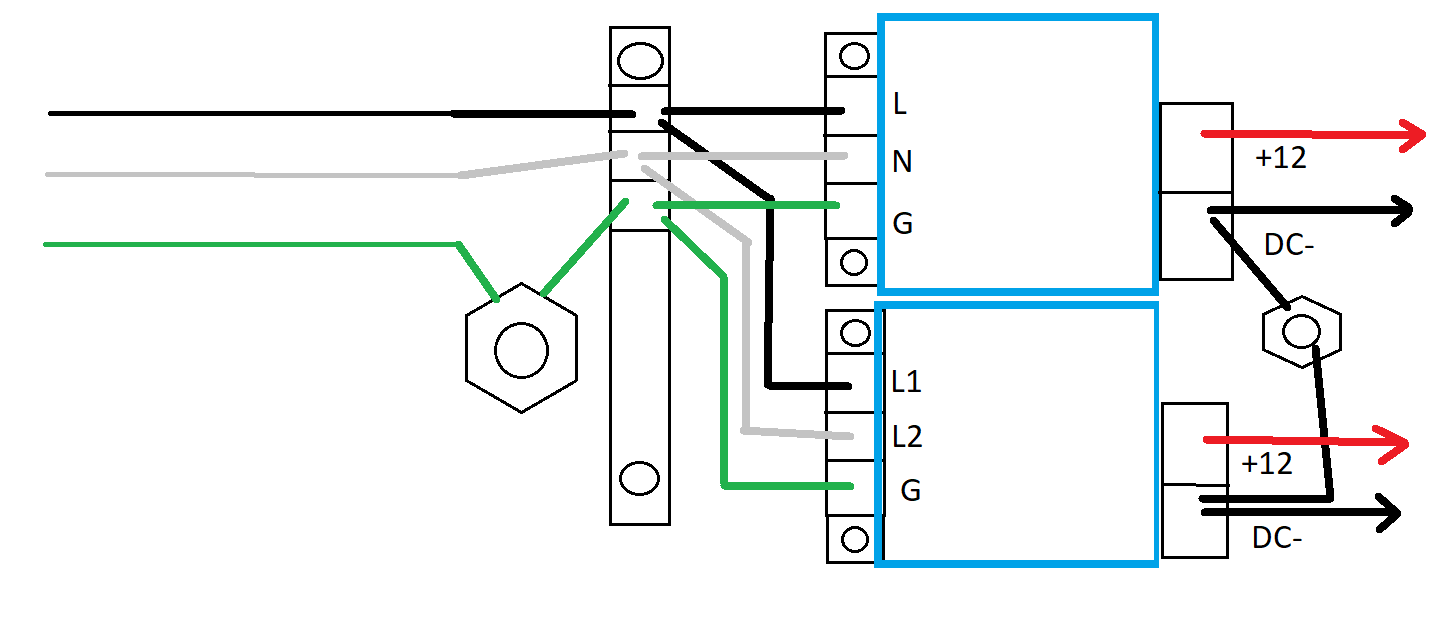

in the example shown here would be the proper way to wire a panel with two power supplies. two common methods of naming the input terminals are shown here. the incoming AC power is at the left. the incoming ground wire goes first to the panel ground, then to the terminal strip. the incoming hot and neutral go directly to the terminal strip. the AC breakouts for the power supplies go from the terminal strip to the power supplies. notice that the neutral (shown here as grey, but USA color code would be white) does not connect to the panel ground. similarly, the DC outputs have the negative terminal tied to chassis ground and power wires go to the equipment being powered. power supply AC inputs may sometimes not have a ground terminal, as it may be connected through the chassis mounting of the supply.
in industrial equipment the green incoming ground wire is a couple of inches longer than the hot and neutral. if the cord ever gets accidentally pulled loose, the ground wire remains connected after the hot and neutral break off.
That's exactly how we wire our equipment, minus a few of the termination hardware pieces used. This configuration has traditionally worked well for us, with no disruption to the performance of the power supply. It is when we take the grey/N/L2 and green/G and jump them together in the equipment box that contains the power supplies that we see "fireballs." While I maintain it's not suitable for sourcing power from GFI equipped sources nor NEC-kosher and wouldn't recommend doing it, we are trying to understand why that's happening if N is ultimately bonded to earth ground reference at the breaker.
