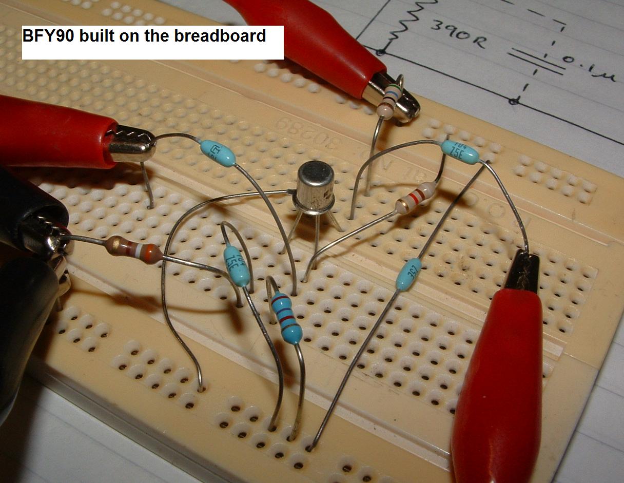

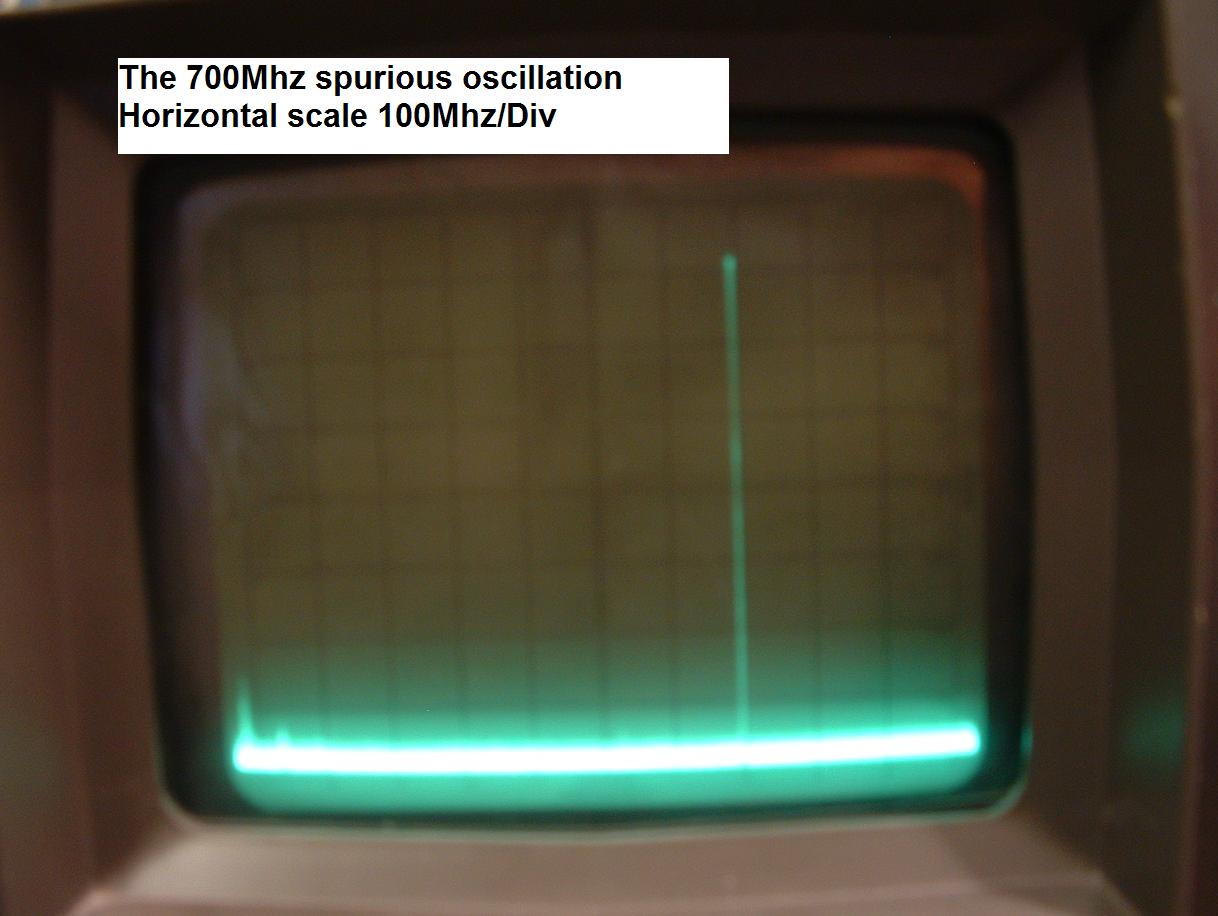

I first built the circuit on breadboard and got a bit of a surprise, something was very wrong, it would not amplify even at low frequencies, I then discovered that the thing was oscillating quite well at about 700Mhz, even with the emitter bypass capacitor removed reducing the gain considerably, it still oscillated.
Still working on the breadboard, I replaced the BFY90 with a 2N3904, and re-installed the emitter bypass capacitor.
The 700Mhz oscillation was gone and there was some useful gain at low frequencies, dropping to unity at about 5Mhz.

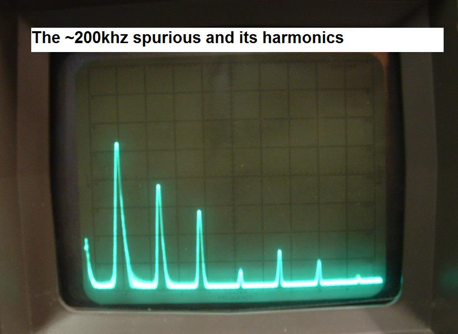

But now there was something odd at low frequencies, the "amplifier" was also oscillating at about 200khz.

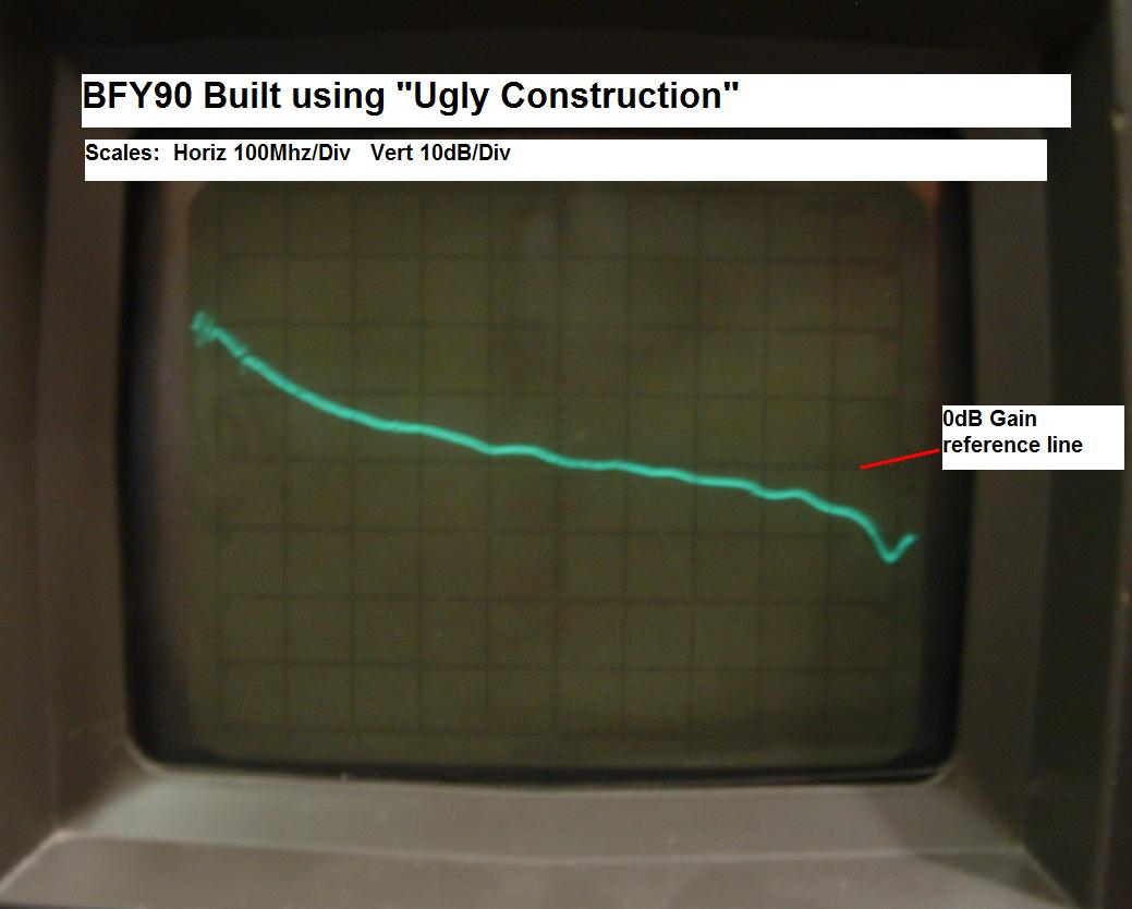

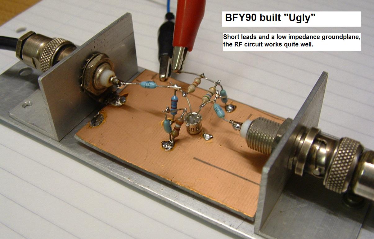

I now built the BFY90 circuit on a piece of copper clad circuit board.
No etching or anything like that, just plain "ugly construction", (see the photo) a very effective way of building RF prototypes.
The support with the BNC connectors is a test jig which I use for things like this when I want to test a circuit or a component at RF, the BNCs make a convenient way of connecting the test equipment with low stray impedances.
The amplifier was now stable, no spurious oscillations, the gain was good, rolling off to unity at about 500Mhz.

1 A circuit which works reasonably well when built with a good RF technique, will give problems on a breadboard.
2 RF circuits don't work well on a breadboard.
3 Even "low frequency" circuits can have high frequency spurious oscillations.

A GREAT presentation. Gonna promote this to article! GAUD, I miss my old HP141T w/ tracking gen. from way back in the '70's. I just loved seeing that solder-ball in the sixth panel! A bit of nostalgia there when I was just a tech.
There's only one thing majorly bad about breadboards that I'm aware of, and that is that at RF frequencies they have a lot of capacitance per strip and a lot of capacitance between strips at higher frequencies. At the really high frequencies the breadboard can actually be looked at as an antenna array, soldering deadbug style or wirewrapping is quiet practical and easy to do though.
By the way, that built 'ugly' is built right if you ask me =) Circuits don't have to be pretty to work well, and if yout put a power plug on that thing and put the case on it's about as good as it gets for isolation.
