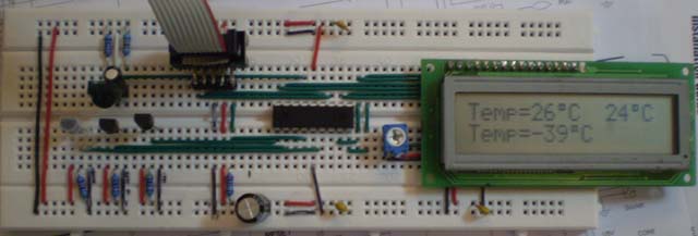

I use breadboards all the time and have no problems at all. I suspect your breadboarded circuits are unreliable because they look more like a birds nest than a circuit.
Attached is how I build a typical breadboard circuit.

I use breadboards all the time and have no problems at all...Attached is how I build a typical breadboard circuit.
Mike - that's a very neat construction indeed. Mind if I ask for some pointers:
* What brand of preformed jumpers do you use? I tried the Elenco ones and could never get them to fit, so instead just use flexible wire.
* What brand of breadboard?
* How do you connect up power, signal, scope probes, and things like speakers which don't fit into a breadboard? I use alligator clips attached to jumper wires which I insert, and so I end up having 4 or 5 of these hanging off the board.

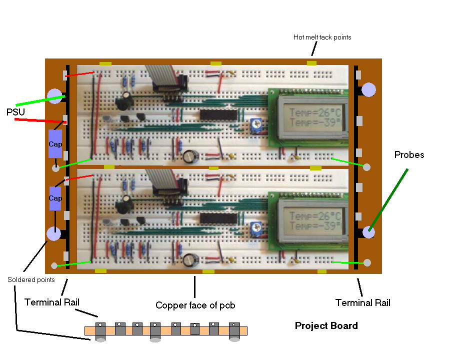

I fix my project boards to double sided pcb [use off cuts]
Cut the pcb so you have about 1 inch oversized on the project board, that is a 1 inch pcb border.
Solder 0V/Gnd wires to the pcb and push the other end of the wires into the project rails you plan to use a the 0V rails.
You now have a grounded back plane.
Use short lengths of terminal strips, the type you normally screw to a panel and has vertical tags to which you solder wires.
Solder the terminal fixing tags to the pcb [ all on the top side of the pcb!]
Use the 'free' terminal tags to connect long twisted wires to your bench power supply.
From these tags solder power wires and push the free ends into the project board lines that you are using as power rails.
Now solder on the terminal strip electrolytic and ceramic decoupling caps, using the pcb as 0V/gnd.
I usually mount two project boards on one back plane pcb, sometimes 3.
This gives a firm base for holding the project boards together, especially when connecting wires from one project board to another.
I use these boards for work from mVolts analog signals, digital logic/PICs upto 20MHz with NO problems.
I hate to admit this but my project boards have been in regular use for about 20 years, bought from Jermyn industries.
Always use clean, short lengths of TINNED solid copper wire for the interconnections. Use old telephone wire.
DONT force in oversized component leads.
If the passive components you use are on 'strips', cut off the end bit of wire thats covered by the strip..
Some strips leave a tacky residue on the wire, you dont want that in your sockets.
OK.?:)
EDIT: at the other end of the pcb I solder another terminal tag strip.
I use this to wire test leads into the project board and the scope/meter hang on this terminal strip.

I make all my own jumpers from 0.6mm diameter wire. I have a few different coloured reels of wire and can make them quicker than most people can strip a piece of wire to a random length. The above board would take me around 1 hour to make which I consider time well spent as I can then be confident that bugs are in code and not hardware. The breadboards I use are just a cheap brand (wish) from the local electronics store. For connecting things that don't fit a breadboard I solder on SIP connectors or use breakout boards. In the above photo the LCD and the IDC both have connectors soldered to them.
Pretty neat, Eric. Have any pictures? (Would help visualizing it.)
As per your PM, I thought a simple drawing would help.:)
Credit for the actual project board used in the diagram goes to Pommie aka Mike.
OK.?
