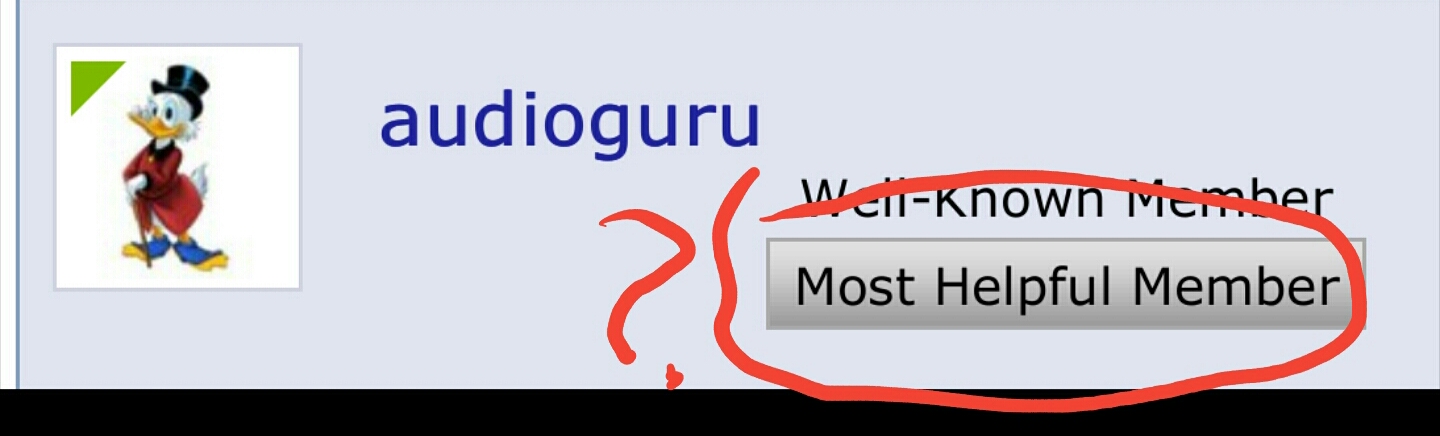

Most helpful? I've seen no evidence of that in this thread. Lots of irrelevant comments and comments that the project can't work.
I pity the poor kid trying to sort the tiny bit of useful information from the noise in this thread.
[Note to moderators: delete this if you must, but consident my point. Ban me if you wish.]
Hello,
Isnt that just harsh judgement? Not to mention rude at the very least.
I ignored your rude reply in my thread and i am betting other people will start to ignore you too if you continue to act with such indiscretion. Maybe think a little before you reply.
