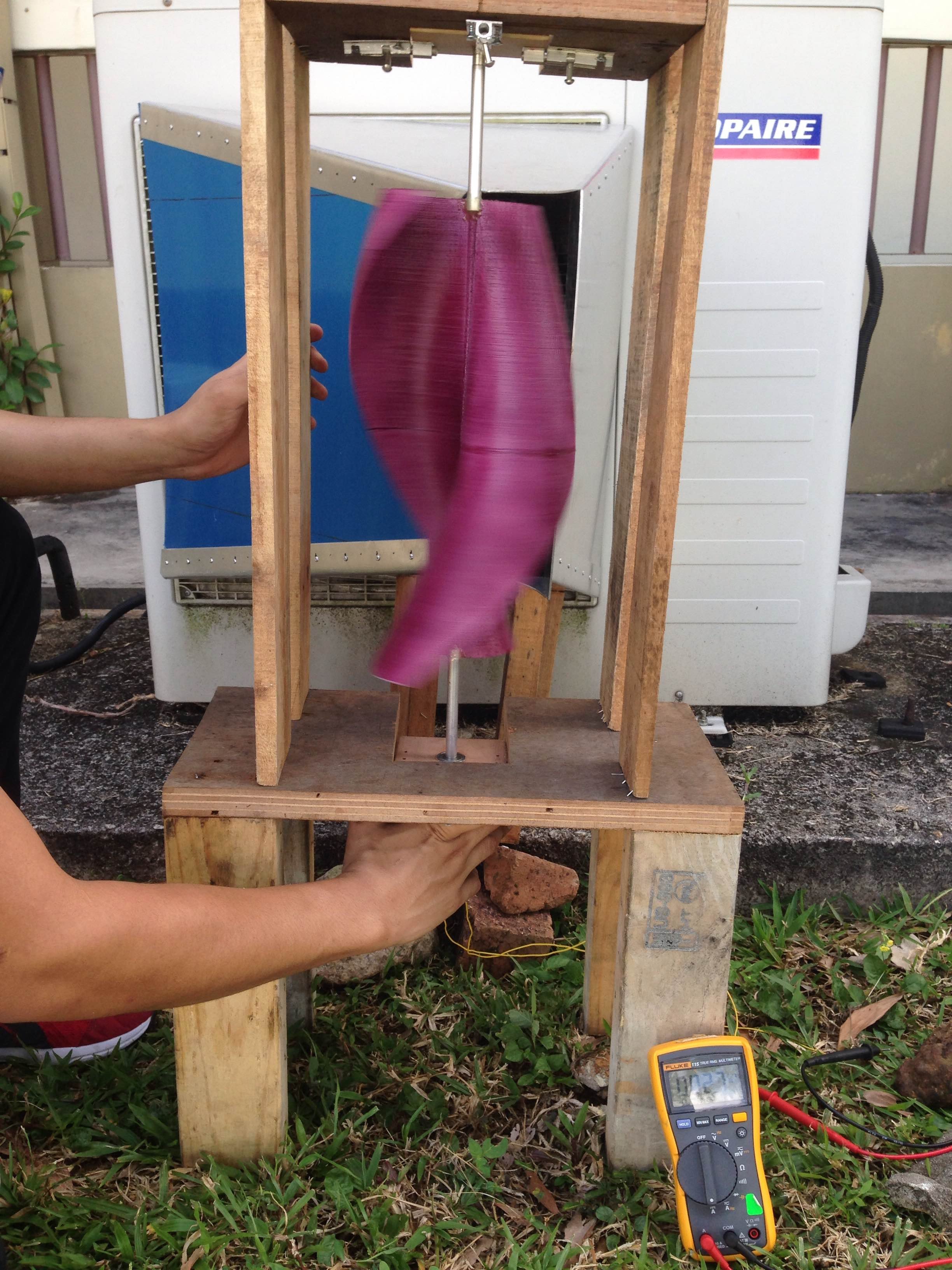

To the OP:
There are various tricks you can use to boost very low inputs like 0.5v or under up to something usable, but the power requirement has to be met no matter how you do it. If you have 1 watt in put you cant not get 2 watts output for example.
The most common trick is to use bootstrapping. That's where you use some other trick to get the boost circuit going, then feed the output back to the input drive stage and that provides an extra voltage to work with. If you use a transistor driver though you need a transistor with a very low sat voltage or a MOSFET with low Rds.
One technique would involve a start up battery that is used just for starting the converter. You can charge the battery once it starts.
Another idea is to use a reed relay as the startup switch, then switch to the low sat transistor after the converter starts, again using bootstrap.
In slightly higher voltage applications a germanium transistor might fill in either for all the conversion time or just for startup.
A hand crank startup is possible too, and is even a little comical :)
A push button single shot startup is possible too with a coil and push button. The back emf of the coil provides enough voltage to start up.
Many possibilities here, including a solar array or thermoelectric generator pile which may operate full time or just to start up.
Nursyukriah
Although there are ways to boost low input voltges up to a more usable voltage, they all require some alternate method of getting the converter started with a higher voltage, or some other bootstrapping method.
But, in looking over the power source that you were given, I think that the real problem is with the previous students choice of trying to use a brushless motor as a generator.
It is well known, generally speaking, that a brushless motor is more efficient than a brushed motor. But, those reasons apply only when it is acting as a motor. But, they do not apply when trying to use it as a generator.
A brushless motor uses electronics to drive the field coils to make the motor run. The electronics will consist of a IC that uses a position detector (Hall effect switch) to decide which field coils to turn on and off, and when to do so. But, that IC needs to be powered with IT'S minimum operating voltage (3volts?) before it can wake up and make intelligent decisions. That IC will contain output drivers, either mosfets or BJTs, to actually switch power into the coils. But again, without power to that IC, nothing is going to happen. Also, I suspect that the polarity of those output switches is going to be in the wrong direction for generator vs. motor current.
Now, I suspect that the coils within the motor are generating a voltage high enough that leakage currents are getting through the power switches and the IC. And the 0.15 volts you are seeing is from that leakage current.
Now, if your assignment is that you must use the turbine/brushless motor combo as it is, then you need to boost the voltage. And the knowledge you will learn on that path will be valuable, even if the project is, in the end, a waste of time.
But, if the the end goal is to create a useful power source, then I suggest that you replace the brushless motor with a brushed motor that is known to function well as a generator. My guess is that you will have much more voltage and current from such a combination than what you now have.

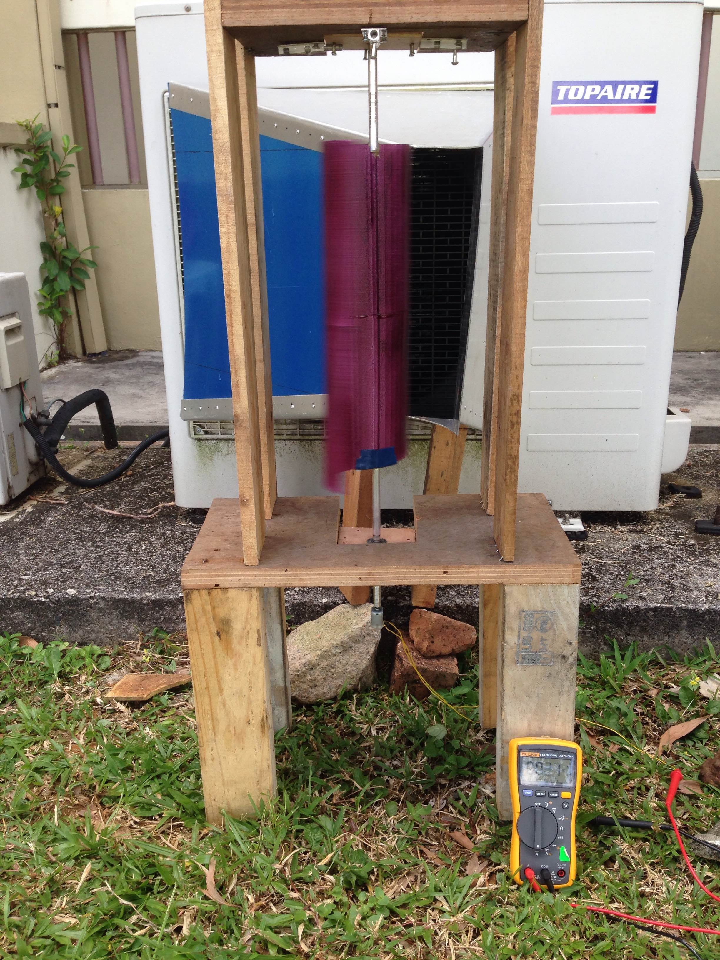

Pictures of real Existing Micro - Savonius Vertical Axis Wind Turbine (VAWT).

Sorry for getting the gender wrong. From the picture of the motor in chapter 3 and the partial data it looks like it is a permanent magnet brushed motor. This is probably the best type of motor to use as a generator. The data in table 5.2 seems a bit odd as the load resistance is different in each test. I cannot see any mention if the load resistance was varied intentionally to maximise the power output so this is something that should have been mentioned.
Test 1 Load resistance 2.64 ohm
Test 2 Load resistance 2.34 ohm
Test 3 Load resistance 1.93 ohm
Test 4 Load resistance 1.76 ohm
If you wanted to get a higher voltage output (But at less current.) then choosing a motor with a higher voltage rating and a lower RPM rating would help. From the figures in table 5.2 I think the motor would run at about 20000 RPM on 3 volts.
Les.
It looks pretty obvious to me.
The motor chosen to be the generator was a low voltage high RPM type and the rotor design is a low-speed high torque design.
Simply put to get better power and efficiency out of the device a larger low RPM higher voltage motor should have been used.
