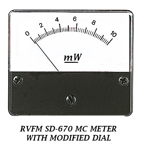

Here is a moving coil plus load to suit your dynamo (motor) output. The center of the scale (50 uA) indicates 5mW output power from the generator. You would probably be able to alter the existing dial or print a new one and stick it on the existing dial.

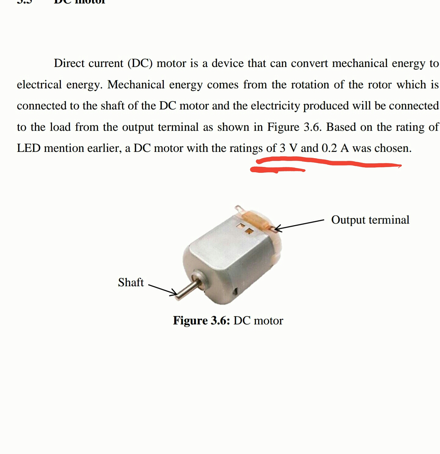

Chapter 3 of the report shows the motor. It's a common permanent magnet DC toy motor drawing 200mA at 3 volts. Radio Shack has similar motors for a few bucks. The rated speed of the motor is not given but the speed of this type of motor is typically 5000 - 6000 rpm.

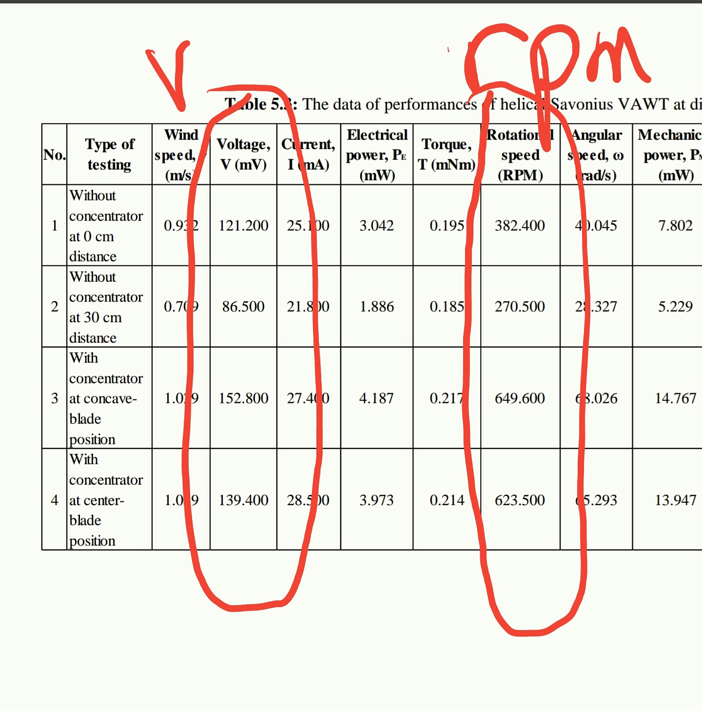

Chapter 5 of the report lists the test results, including the motor rotational speed ranging from 270 - 650 rpm.

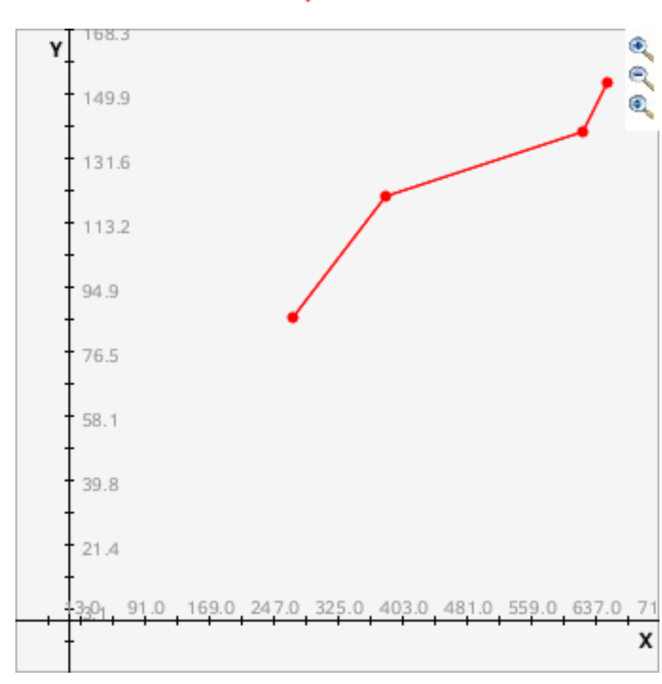

A quick plot of speed vs. output voltage shows the expected linear relationship. Output voltage is directly proportional to speed.
If the motor speed is increased to the normal operational range, a useful voltage in the range of 1 - 3 volts will be produced. How much current (and power) is available depends on the power the turbine can produce. Increasing the motor speed with pulleys and a rubber-band belt gets the voltage up to the level where lighting an LED might be possible.
