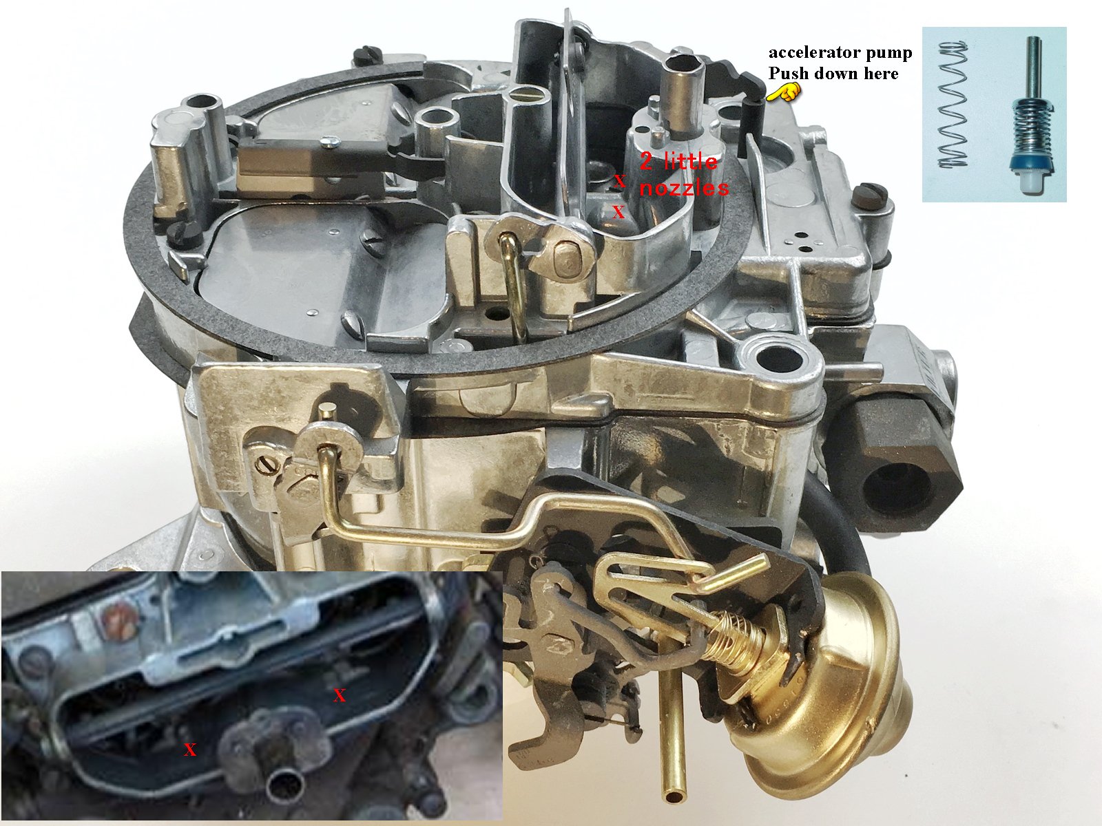

Boat engine backfire, with sound clip.

Make sure the accelerator pump is squirting. NOT with the engine running!
When you say a backfire into the carb, is it more like a popping noise than a gunshot noise? If so, it maybe a faulty coil feeding the spark plugs. Another symptom is it'll run fine at higher revs.

The coil has been changed. There is a video with sound in first post.
Maybe more a popping noise than a gunshot :)
Looking down into the carburetor, toward the front center, there are 2 little nozzles. When you accelerate from idle, they should squirt a stream of gas into the venturis. (Center rings in the primary barrels)

The new ones are but that looks like a Rochester 4 barrel Quadrajet.
There are videos on YouTube on Quadrajet accelerator pump and rebuilding the carbs.
I didn’t find one that showed it operating. I may look again later.
