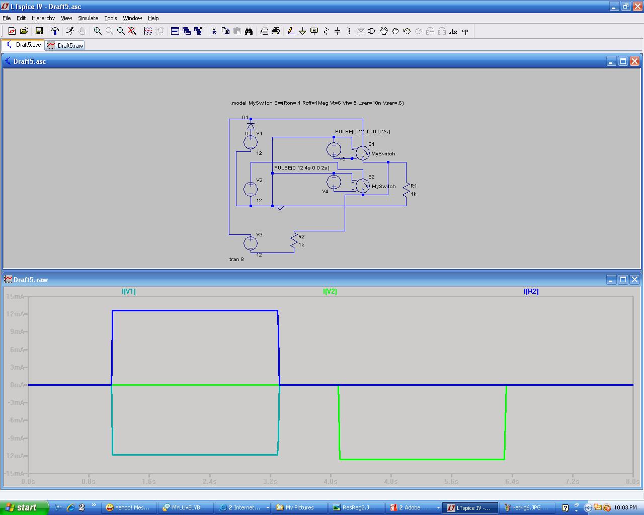

Thanks KChriste. There was an error in my scheme. The problem was that the circuit for battery3 was complete when battery 2 was being used, through battery 1. The problem is easily solved by adding a power diode to battery 1 ( see attachment ) The diode prevents current from battery 3 from flowing through battery1 when battery 2 is being used. The simulation verifies the operation.
Since battery1 is being used to start the engine, D1 has to handle the starting current, probably 100 - 200 Amps. Does anyone have a part number for D1 that will work? If not, I'll research it tomorrow.
In the attachment, battery1 is switched in for 2 seconds. Then battery2 is switched in for 2 seconds. Current through the lamp, represented in the drawing by R2, only flows during the time that battery1 is switched in.
V1, V2, and V3 represent battery1, battery2, battery3 respectively. V4 and V5 are not to be used in the final circuit, and exist for simulation purposes only.

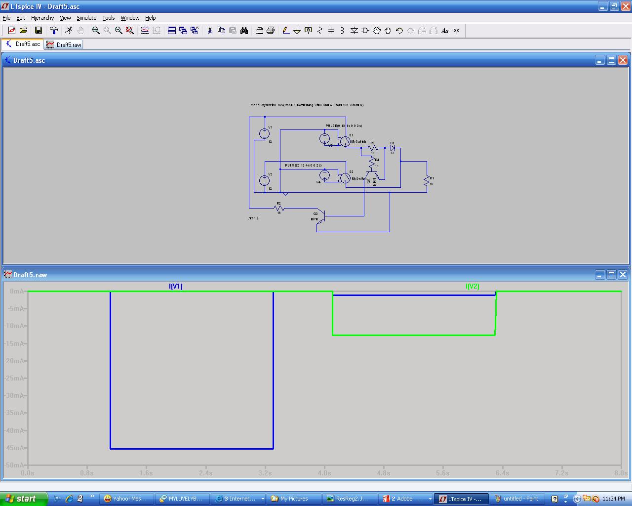

Ok, here is another idea. Current from battery1 turns on q1 and q2 via R3 and R4. The values of these resistors depend on how much current is being drawn. Q2 turns on the lamp, represented by R2. The starting current cannot be drawn through R3 and D1, thus the connection for the starter must be made at the junction of the switch and R3.
There may be a simpler way.
When then engine is charging bat 1 it will have a higher voltage than bat 2 and will be at least 0.6 volts higher as you have a charge splitter - now when you stop the engine the voltage of bat 1 will fall below this 0.6 threshold and may even fall below the voltage of bat 2 after a while as the power is used from bat 1.
So a transistor across the + terminal of bat 1 and bat 2 can used to turn on an alarm when the volts drop below .6 volts. It is cheap to make and requires no other changes in the wiring of the boat. Maybe BrownOut can recomend a suitable transistor?
