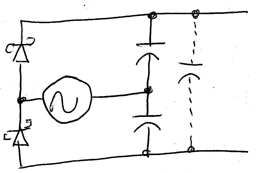

Playing and learning, an area I haven't any experience with is voltage inversion. What would be the best way to flip the green part shown here and add it to the DC effectively giving a full wave rectifier?
Ideally the method should support up to 100V and be the best efficiency possible.

I did this on my project. Good diodes. Only two so there is less loss.
Note the voltage is 2X and the current is 1/2 of normal.

Ah the classic voltage doubler :). I'm having enough trouble finding 100V fets let alone 200V fets though! A 200V buck would be even harder to find.

Quick question Ron, the voltage doubler is effectively shorting the capacitors for half a cycle, was there any outcome of the related discussion that was had a few weeks ago on whether this advisable long term? I guess it only stands for electrolytics not tantalums?
No.
When the left side of the signal goes negative it hangs up on the bottom diode and will not go negative. So the right side pushes up and charges the bottom cap. Next then the left side goes positive it pushes up and charges the top cap. In one cycle you will have the peak voltage on each cap and they add to make P-P voltage.

I'm a bit a head of you in the research, first the zeners - 3W aren't reliable. They get too hot at 20V. Shorting the generator (collapsing the field) using a triac doesn't work as the inductive nature of the thing causes it to miss it's zero crossing, same for ST's fancy TTL controlled version. Doing the same with a transistor DC side sounded ideal but the zero crossing point becomes predictive. I was switching off at ~0.01V and it was "boost"ing to over 250V. I contemplated clamping those spikes but considered it was becoming messy. The transistor was still dropping 0.7V and getting hot.
So I'm handling the full 100V, which requires N-FET's, so high side driving. I actually revisted your voltage doubler and integrated active rectification for the diodes. It's working perfectly in LTSpice and is my solution going forward.
