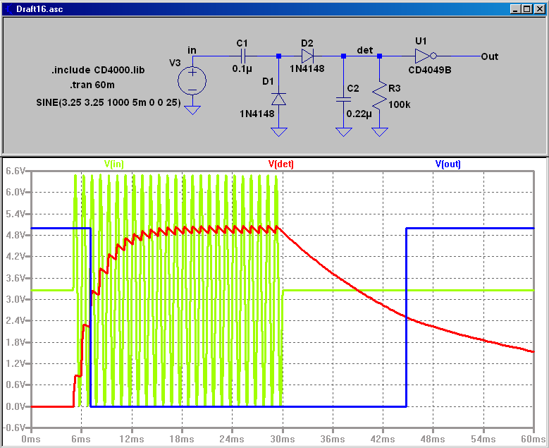

The issue now is that i need to somehow use the output of the opamp to get 5v for about 0.5 seconds.
upon testing the opamp circuit with a scope, its putting out at full gain about 8-10v peak to peak (ac) but very quickly aswel. With a diode to rectify it, I get a futher drop over the diode so it ends up only peaking at about 3-4v.

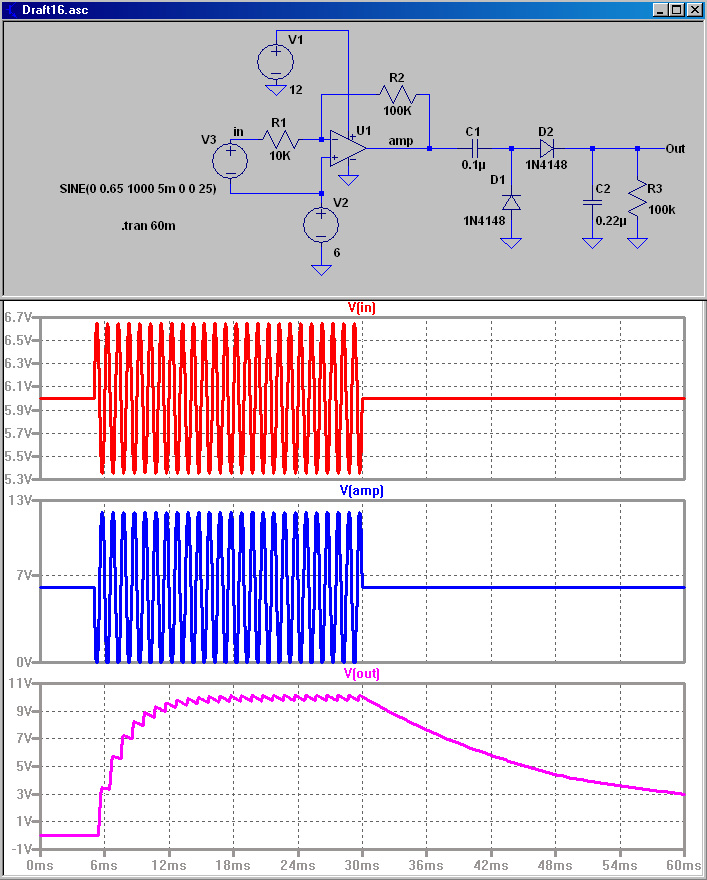

Here is an example of how to rectify a burst of signal into a level which is proportional to the amplitude of the burst. Note I'm using a "rail-to-rail output" opamp to create a signal which is 12Vpp, while the opamp is powered from 0V and 12V. (A 741 wont do that:p).
The network consisting of the two capacitors, and two diodes rectifies and filters the output with the time constants shown. Running this output into something that squares it up (Schmitt trigger gate, comparator) will turn it into a logic signal.

Hi Mike, that looks pretty much exactly what I need!

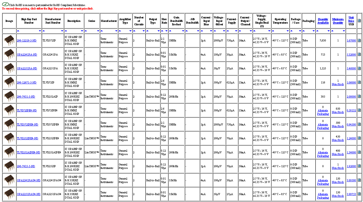

Im still struggling to find these rail to rail amps though, cant find anything on RS components. Are they likely to be called anything else?
I guess the output stage of your circuit after the amp would also work on my set up if I had enough gain :(

I searched on DigiKey for Rail-to-Rail, 2 per 8pin DIP, operating voltage >15V, made by TI, and got this page. Can only post a snapshot.

To make a ~5V logic output, the detector circuit only needs an input of ~7Vpp, so that should unburden the opamp requirements. It doesn't matter what DC level the AC signal is riding on.
I would recommend squaring up the circuit using a Schmitt input inverter or gate to square up the signal, especially if you are counting the number of times the detector produces an output.

Is CD404 the schmitt inverter gate? whats the emulation software you are using there, it looks great?
In theory then, as my circuit is outputting around 8v p2p I can use it along with your output stage? or should I look into these rail to rail types?

CD4049. If you are achieving 8Vpp, then this detector will produce more than enough to trip the inverter. Search this forum for LTSpice.
The CD4049 is not a Schmitt trigger inverter. Use an MC14584, CD40106 or 74C14 Cmos Schmitt trigger inverter instead.
The output of your ordinary opamp is about 8V p-p and rectifying it produces a peak that is about +3.3V which might or might not trigger a Cmos Schmitt trigger inverter that has a max trigger voltage of 3.6V. If you use a rail-to-rail opamp then its peak output of +5V is reduced to +4.3V by the rectifier and the Schmitt trigger inverter will always be triggered.

I dont suppose there is a rail to rail op amp that i can just swap out for the TL071 that i've got in the circuit at the moment is there lol?
There are thousands of single rail-to-rail opamps that will simply plug into your circuit instead of the TL071 opamp.

so daunting though when you go look at RS website and you get 'Your search for rail to rail returned 1986 product(s) in 20 sections' lol
