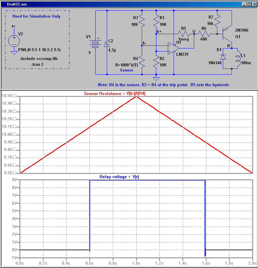

Best circuit for light / dark activated switch
The pinout for the LM393 can be found on the datasheet which can be found using your favourite search engine.
Just connect the inputs of the unused comparator to opposite power supply rails, i.e. the + input to +V and the - input to 0V or the other way round, it doesn't matter.
Erirc pointed out to me, via PM, that I'd made a mistake.
I'd missed off the base emitter resistor which ensures Tr1 turns fully off, without R7 it will leak 8mA when it's supposed to be off.
I've edited the schematic

Been away for the weekend, The illustration you kindly provided, not sure if is a PNP or NPN transistor from the diagram which would be best suited.
Thanks again
Phil
PNP.

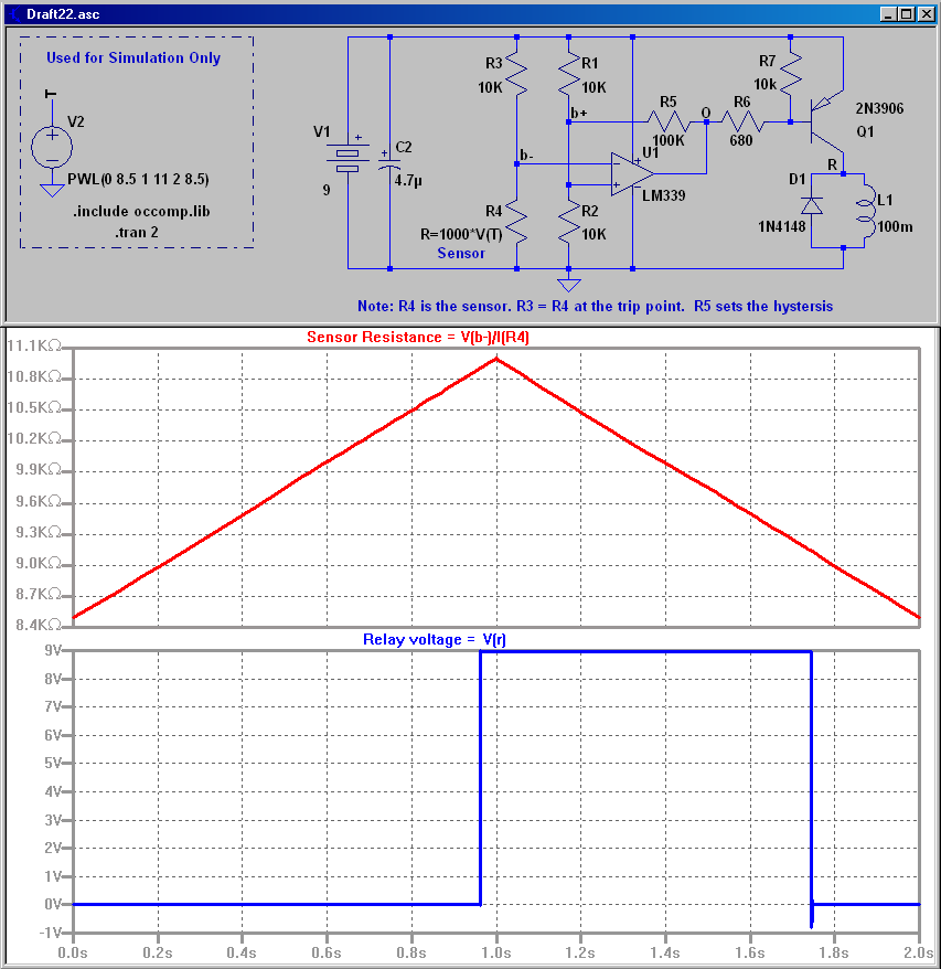

Hero's circuit still needs some tweaks. You will have a hard time finding a 9V relay. Common relay coil voltages are either 5, 6 or 12V. His circuit has way too much hysterisis. Use 1meg as the feedback resistor. Look at the attached sim. Note that with the 1meg feedback resistor, the circuit trips at 9.9K and 10.1K. With the 100K feedback resistor, the trip points are 10.9K and 9.1K, respectively.
