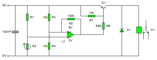

Having done a fair bit of research for my project, chicken coop opener that i want to work with light sensing action in the first instance.
I am wondering which circuit would work best, i wish to work with regular batteries eg. 9v or 6 with AA's
I have looked at the 741 op amp circuit, and also the 6v switch using a double pole relay.
Wondering which would give best battery life and effectively operate a motor for the pulley system.

I wouldn't recommend the 741 for this kind of circuit, the LM311 is much better as a comparator and will drive a small relay with no drive transistor.
LM311 Light/dark detector/thermostat

The LM393 is a dual comparator, use it to drive a low power transistor/relay.

The LM393 can be used but its output isn't powerful enough to drive a relay so an extra driver transistor is required.

You need another transistor, the maximum output current from the LM393 is only 20mA or so, a typical relay needs 50mA to work.
Here's a circuit showing how to use an LM393 to drive a transistor.

I cannot thank you both enough for helping me, and your pateince !! i did miss the need for the transistor for the circuits thanks for pointing it out. havent worked out what motor i would need just yet, need to work out if counter balancing the wooden door to allow for a smaller motor or to get one with enough guts to pull the total weight. I guess if motor small enough i could be able to rid the need for a relay. i have managed to get hold of both IC;s the 311 and the 393 as although maplin on line said no stock they did in fact have both. Hero i will have a good look at the circuit you kindly provided and will update if i still cannot get my head round it, at present not totally sure which pins to connect to on the IC.
