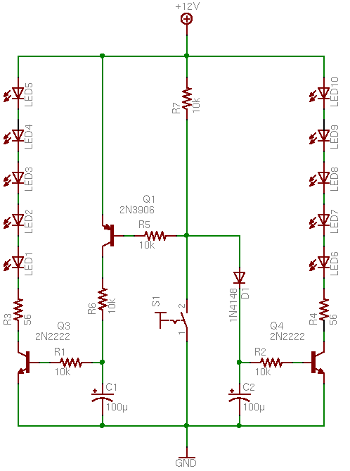

Well I have an updated schematic, works now, but same problems with the fade:
The curious thing is, 100uf caps work FINE if hooked up in the junction between r3/r5 and respective LED chains. Unfortunately it will only fade the right side of the circuit...can the the principle that's happening here be used to create slower fades with smaller caps? I assume what is happening here is the solution you have, driving the LED's with transistors.
If I just hook transistors directly in parallel with the LED arrays, is it safe to use a 16v rated transistor?
Yeah-- the way the ckt works is such that it would only fade that one side... am a bit sleep deprived so "I'm trying to think but nothin' happens" ... If we could revise the circuit so as to put a 2nd cap in parallel with Q2 -- won't work right tho... need to think it over a little...

Very simple solution (also cost effective if I can work out the kinks):
Problem is, both the red LED's and R2 run VERY hot...
Hm... how about this??
ledfader3-png.30251
I'm not a super guru with the transistors so there may be some issues...
But the idea is that the PNP gets turned on only when the switch is closed, which in turn shuts down the right side transistor and leds; the diode prevents the right side cap discharging anywhere but thru the base of that right transistor. The left side transistor is turned on by the PNP and when it shuts down the cap drains fading the left side LEDs. Like I always say "it should work" :D

Alright, before I order some parts, the LED calculator I was looking at suggested 1/2watt resistors. How is this calculated and what will happen if I go with 1/4 watt?
You can figure out wattage (power). It is given by P = I*V where I is current and V is voltage. *or* since V = I*R then P = I^2 * R
So say you have 20mA thru all the LEDs and a 56Ω resistor inline, you get P = .0004 * 56 = 22.4mW. I can't imagine why you'd need a 1/2W resistor for such a small power dissipation.
I've been trying to learn SPICE so I can model the circuit I posted to see if it'll work right or not... haven't had much luck yet. :) So I don't know for certain if it'll work. If it were me I'd prototype parts of it at a time then put it together at the end and test.
