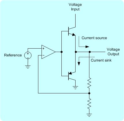

I guess the integrated battery charger circuit on the bluetooth device is 'looking' for a battery and putting out noise unless I connect one. My thought is that perhaps I need to build a regulator that can sink as well as source current and connect that in place of the battery. What do you think?
Can I just use a LM336Z5 (Fairchild) sunt reference with an adjust resistor to get a 3.7V output that can also sink current like a battery?

I was hoping someone might have an existing design I can easily copy? Such as this one, but with the extra bits added in (the site I found it on said it is simplified).
