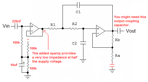

Bad output wave-form from my filter??
This is my first project on my own and is really annoying me.
My main goal is to turn an LED on and off with low frequencies with 12V and 0V rails.
I send the amplified RCA signal to the filter. There is a sine-wave on the input of the op amp. However, the output does is at 12V DC with no signal. With a low frequency, the output dips below 12V to about 0V. However, this alternation is only about 1/4 the time that the output is at 12V (20% duty cycle?).
I can't understand why this is happening and am 1000% sure I have it hooked up correctly.
I am using an LM324 op amp, 20k resistors on the filter, .01uF on the filter, and 10k feedback resistors on the filter.
Please help as this is driving me insane.
How are you powering the 324: single supply? split supply? With a single supply, you'll need a voltage divider (1:1) to eliminate the DC offset to the op amp.
Your Sallen and Key lowpass filter must be fed from a very low impedance like the output of an opamp.
An opamp with a dual-polarity supply has its input biased at half the total supply voltage which is 0V. Then its output can swing equally up and down.
I added an opamp input buffer that has a very low output impedance and it is biased at half the supply voltage. It is DC-coupled to the input of the filter so the filter opamp is also biased at half the supply voltage.
I added a capacitor to ground at the feedback of the filter so it does not amplify the DC bias voltage.

The output impedance of a transistor amplifier is too high to feed the lowpass filter. It also has an input impedance which might be too low for your signal source to drive.
Use an opamp instead like I showed. The input opamp can have as much gain as you need.
The old LM324 quad opamp is noisy (hiss), has crossover distortion and has poor response above only 2kHz. Use a much better quad opamp.

Additional you should wire the unused Op Amp's of the LM324.
Connect the Output to the - Pin and give 1/2 Supply Voltage to the + input.
The Voltage divider you can make with 2 10k Resistors and an 100nF cap.
When you left open one or more Op Amps it can be oscillating, and the whole Chip wouldn't work.

Because this filter has a gain of 2 at DC, we can use a 4:1 voltage divider to bias the very input and use a capacitor to couple from the preceding section to this new section. That should be good enough. The upper resistor of the voltage divider can be something like 300k and the lower resistor 100k. The coupling cap could probably be 0.1uf or so. There will be a small low frequency cut, but it wont affect the audio frequencies.
I dont see any simpler way to bias this thing, although there are probably other circuits that can be used too.

So to the O.P. (stl_jones): This really cannot be due to your transistor, so I'm guessing there's a capacitor involved somewhere that's either charging or (more likely) discharging during that long 1/2-second delay. Any capacitors in your circuit? is it the circuit in this post? can you post a schematic with component values?
My guess is that there is more to the circuit than you have shown us in your schematic. Having said that, in any case you need to go back and build the circuit in post #4 if you want to get a signal out.
