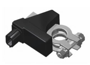

How about working with https://www.rockauto.com/en/moreinfo.php?pk=6309246&cc=3444592&jsn=447 battery current sensor. It snaps around the battery cable on newer vehicles. Orientaion matters.
