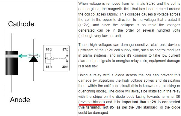

Diodes. Not necessary for proof of circuit. A 1N4001, or 1N4002 wired across each with the BAND side toward the positive voltage.
Pay attention:
According to DIN 72552 the coil should be fed with +12V to terminal 86 and grounded via terminal 85, however in practice it makes no difference which way around they are wired, unless you are using a relay with an integrated diode (see more info on diodes below).

KISS, did you actually read the URL I included? "Relays will generally operate just as well regardless of coil polarity, however it does come into play for one important reason. Since a relay is an electromagnetic device, the coil generates what is known as flyback when it deenergizes." That is why it needs diodes. Also, there are five schematics each showing the various steps of the opening and closing.
"A 1N4001, or 1N4002 wired across each with the BAND side toward the positive voltage," tells me nothing. I need the name/number of the Very Specific location.
That tells you everything.

It's not really a "flyback pulse". It essentially means 12 V stays at the relay terminals until it decays. It can decay through something that can be damaged which is usually a transistor. All, I meant to say was, the diode is not required for testing but improves reliability in the long run. It makes sense to make the external diode the same as the diode placement used in a relay with an integral diode.
The diode is small, so it can be soldered to the relay Faston's. For those doing it the hard way with individual wires: https://www.walmart.com/ip/Painless...9971&wl11=online&wl12=198936377&wl13=&veh=sem
So, a 1N4001: **broken link removed**
