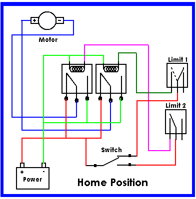

The amount I’ll pay for a complete functioning automatic spoiler is $500.00. If you can also utilize the original dash switch I’ll include another $100.00. The deadline for the completed/functional spoiler is no later than March 29, 2018.
The spoiler should automatically open at 62 mph and close at 42 mph. The SRT6 comes with an exterior non-movable wing. It can easily be removed and the working, automatic spoiler can be directly bolted in. Meaning no additional equipment/fasteners are needed to install the functional spoiler (and dash switch) I have - of course along with whatever ‘equipment’ you have ‘designed’.
I have included a number of comments in the past regarding the spoiler on this forum, so please check them out before asking any questions. There are also photos of the equipment and what little I know about the spoiler’s workings.
I do have the spoiler and switch and about a dozen generic switches - none of which will open and close the spoiler. I can make the spoiler open and close by switching the two wires on the motor.
I am illiterate in electronics. I will add, with no more than a toe in the water, I understand a lot can be done with varying voltages.

BobW, trust me the very torquey motor starts out clockwise (depending on how you're viewing it) until the limit switch stops it. Then turns counterclockwise to lower the spoiler, again stopped by a separate limit switch. I assume the difference between your auto headlights is this arrangement has a small gear at the end of the motor which turns a much larger gear. This gear is attached to a longish rod, which turns gears at the ends opening and closing the levers attached to the spoiler.
My thinking to just get them to open and close was to follow diagrams for power windows. I'll add that I installed power windows in my Alfa Alfetta GT which came with wind up windows. As long as the battery is completely charged, they work quite well.
But jumping to what I feel might be the most difficult spoiler part is the opening and closing at specific speeds. I'm sure the speedometer can't and shouldn't be hacked. But is there a nifty electronic device which can be triggered using very specific voltages? If it had the means to physically turn the voltage up or down, it shouldn't take long to dial it in.
supper simple - comparator, and looks like people have already said that in your previous post. The OBD was also mentioned as a way to get the speed, which I think is a good idea.

Info gathered on the web suggests steps when extending. Excessive current when deploying causes it to retract to home.
A schematic is here: https://www.electro-tech-online.com/attachments/spoiler_schematic-jpg.102834/ There's another schematic (except SRT) which has a 200 ohm resistor for the switch, a high side driven diagnostic LED (unknown Vf), a high side Illumination LED (unknown Vf). Unknown voltage applied to switch, but I think it might be 5V. would need to extract the page. Attached as Alternate_Spoiler_Schematic.
If the controller (except SRT model) had a 200 ohm pull down resistor in it, then you would have 0V, 1/2 Vcc and Vcc as thresholds with 0V being OFF. Down = 2.5 V and Up ~ Vcc. It would also make 12.5 mA a good number for wetting current. Thresholds of 1/3 and 2/3 Vcc with three windows should work fine.
The wierd limit switch arrangement causes problems too. Based on the schematic only, the switches open when at a limit and are pulled to ground in between the limits. Not confirmed independently.
Even for a simple controller, the limit circuit designed wrong could cause the motor to briefly turn on at say every engine start.
We never got from Biba critical information:
1. The value of the internal switch resistor. There is apparently a LED in that switch too and possibly illumination. The switch on the (except SRT model) which i assume Biba has is wired differently. The spoiler switch MIGHT HAVE 6 terminals with 4 being active.
2. At least the operating motor current. Motor resistance is harder to get.
This https://www.pololu.com/product/2452 and a few xtra parts would help get a reading assuming < +- 15.5 A is probably a good max number. You need a 5 V supply. Possibly a cell phone USB adapter.

My concern seems to be the same as Biba's right now. Any overrun without motor protection is likely to do damage. That was and is my biggest concern. The automotive environment with power supply dips and swings is another.
Some order of magnitude current draw, I think, is essential to proceed. There's 40 extra lbs of downward force on the spoiler. That's a big number.

Your probably referring to "current". We really need the "order of magnitude" value. It can determine the physical size of the box. How many amps does the motor draw when moving?
The switch: Apparently there are two different switches. One seems to an UP/Down with a resistor fitted, And one has UP/DOWN/Malfunction/Illumination fitted.
I would think the latter is for the fully automatic spoiler. The resistor is listed as 200 ohms for the latter and unknown for the former, but probably 200. Illumination may have to be worked out, but one can make the malfunction LED work without damage by not knowing if it's a 12 V LED or a 2.1 V LED, a 5 V LED with an internal or external resistor.
Protections: Motor, limit switch breaking and bodily harm (a body part getting stuck). That's part of the OEM controller's job. My understanding is the spoiler is safer in the up position. So, if it tries to retract and runs into resistance, it goes up and stays up (malfunction).
if it tries to go up, it goes up in stages, so if someone happens to be leaning on it, it moves a bit and stops, so that person gets out of the way. My understanding is it would return home and indicate a malfunction. SO, let's assume the operator is not a moron and just interface the limit switches for manual operation and you rely on only a fuse for overload protection. Let's further assume the bright operator won't jiggle the switch and would stop before changing direction. That can blow fuses.
There's the mention of a chime that dings when fully retracted manually, that Biba says doesn't exist.
I believe manual deploy may be a momentary push. which would go through the normal protections, but a brief pulse is all that's necessary.
I also get the impression that manual retract requires on the hold the switch until a chime is heard. If the switch is released, it goes back up,

To re-cap:
MANUAL/AUTOMATIC: Really has safety (property, people, motor) as it's goal. Even auto-deploying > x mph and retracting <y mph is a safety issue (better control of the car when deployed at the proper speed) and probably better mileage when it isn't needed.
FULLY MANUAL: 1st goal is make the limit switches work. 2nd goal, make the OEM switch work. 3rd goal (may be unrealistic) Don't rely on a simple fuse for overload protection. 4th goal (possibly unrealistic) Playing with the switch won't blow a fuse.
CONCERNS: motor protection, property damage, people damage, (creep/erratic operation), connectors
Creep/Erratic operation: Reading on the Crossfire forums suggests that the sign of a bad battery is erratic spoiler operation. That you need to avoid. "Creep" is defined as the circuit somehow interprets the limit as valid in the wrong way and say advances the spoiler "more closed" when really it was not supposed to move. This could easily happen at "crank" if your not careful with the design.
Connectors: Are just an easy way to interface with the current gizmo. You can always parallel your own spliced connectors.
IMMEDIATE NEEDS:
1. Order of magnitude current draw?
2. What switch?

I've had a copy of this diagram below and tried it in the past, but couldn't make it work. Okay, a ($50 if you use Paypal; $25 if I have to send a check) for someone to read through this article - RobMyerProductions/bows.html. Even if you have in the past please make another run through. What I need is verification of the following:
I had both SPDT relays wired the same - from the top 85 86 / bottom 87A 30 87 - correct?
A diode needs to be wired in - what would you suggest for the diode (be specific & color of the colored stripes would be nice). Where are they wired in specifically - meaning not a name, but a location for both ends?
Switch - is a single pole single throw or double pole double throw? I'm guessing a single pole single throw since that's the only switch I don't have.
