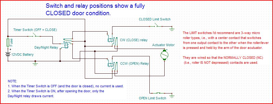

Hey cowboy, i was looking at your schematic and was wondering what the symbol was under the dpdt relay or is it part of the switch? I looked up symbols and it looks like a shock relay. Not that i even know what that is if that's right.
If you're referring to the arrowed item below:
then it's just a stylized representation of the coiled wire forming the electromagnet.
is this a component of the relay or is it added to the circuit. I am going to radio shack to purchase the dpdt relay and wanted to know if i needed any other components other than the fuse. thanks
Cowboybob, i would like to thank you for your time and knowledge. It worked just as you described. Timer on = full extension of actuator / Timer off = full retraction of actuator :):):) My chickens will be safe now.

This is the origial system schematic:
As your actuator has built in limit switches and is "automatic" (in whatever context) it would be useful if you could post a schematic of the unit. Or at least its brand and model #.
It probably only needs a reversal of the polarity of the DC source to effect the reversal of its action. That would make the schematic I posted incorrect for your needs.
I can post a simple polarity reversal schematic, if need be.

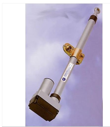

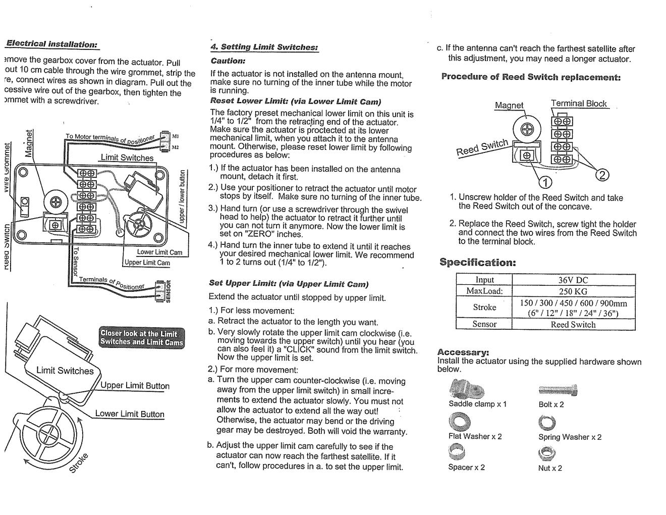

• 36v dc linear actuator with adjustable limit switches. I can’t really find a brand name on it. I got it off Ebay here in Australia. Note that the actuator is supposed to be for moving satellite dishes, the ‘sensors’ on the schematic are irrelevant.

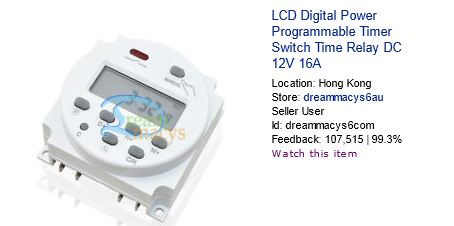

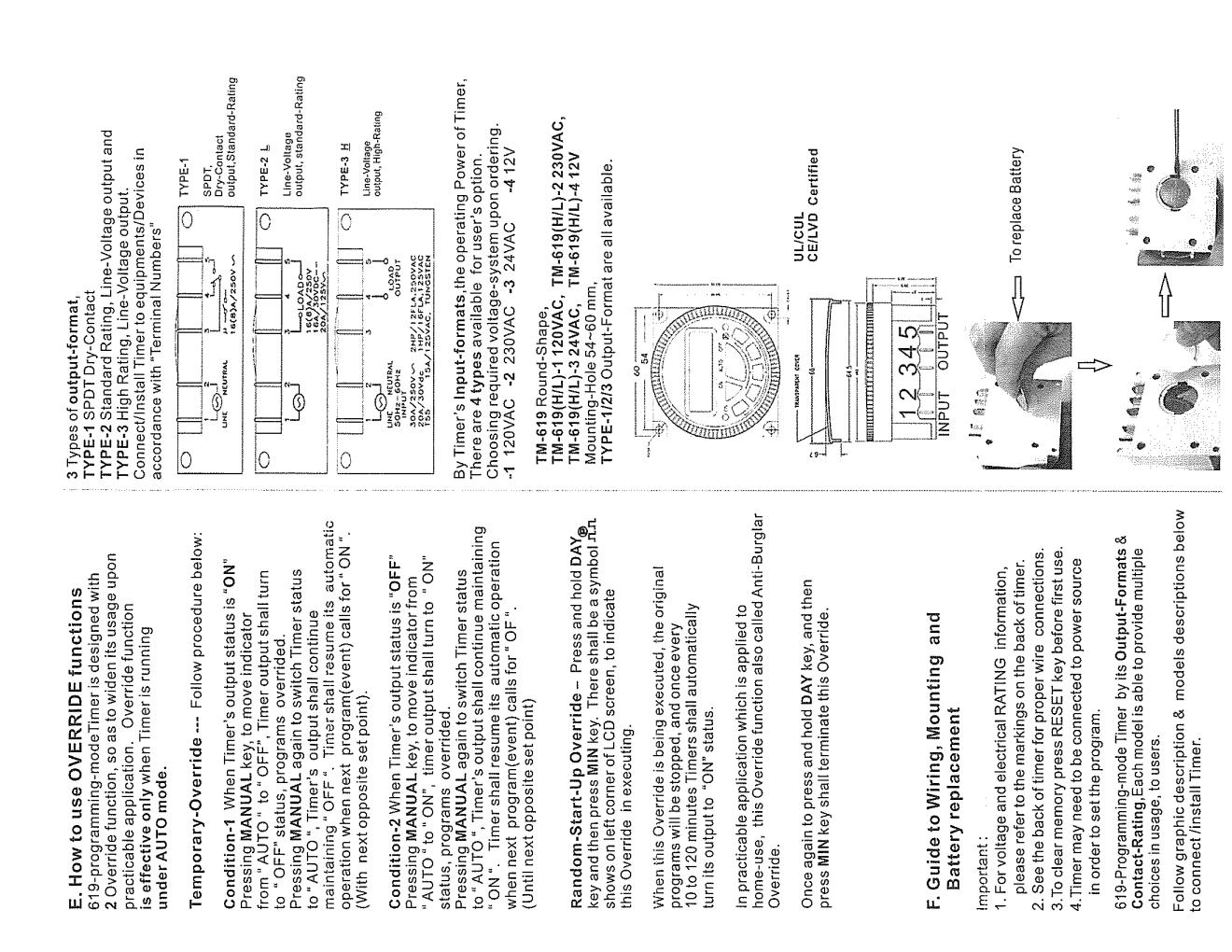

• 12 volt digital timer with manual over ride inbuilt.

Having seen the wiring of the terminal box, you can, indeed, use the schematic I provided. You can use the "reed" switches provided for the "limit" switches in the schematic that I posted earlier.

Note1: The actuator "opening" and "closing" is effected by reversing the polarity of the DC voltage applied through the attached controller box circuit and then to the motor.
Note2: You'll definitely need a fuse in one of the lines (doesn't matter which) coming from the PS to the controller box of the actuator. I would suggest a "fast blow" glass type of no more than 3-5A (the probable max current output of your PS) and buy several. You'll probably need them.
Arrange the wiring needed to get power from your PS to the controller box's input power leads.
Note3: Since you don't (can't, actually) know for sure what polarity is needed to operate the actuator in a direction that will be the reverse of its current position, you're just going to have to guess at the polarity needed and see what happens.
If you are wrong about the polarity, the fuse should blow since a motor that cannot turn (it's at a "dead stop") will be, for all intents and purposes, the equivalent of a dead short. This, of course, presumes that the PS can supply current in excess of that needed to blow the fuse (can you sense some circular reasoning going on here??).
Reversing the polaity of the leads powering the controller box should make the motor turn. If this is the case, then we can go on from there.

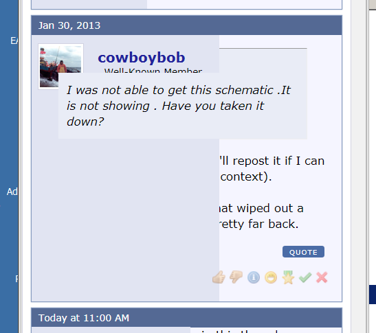

I was not able to get this schematic .It is not showing . Have you taken it down?
What post was that in, april? I'll repost it if I can ID it (or figure it out from the context).
There was an ETO HD crash that wiped out a bunch of attachments going pretty far back.
Maybe this duplicates the problem:
Maybe all ubumartin needs to do is go full screen or grab the right margin and open it.
Are you on a mobile device or PC?
