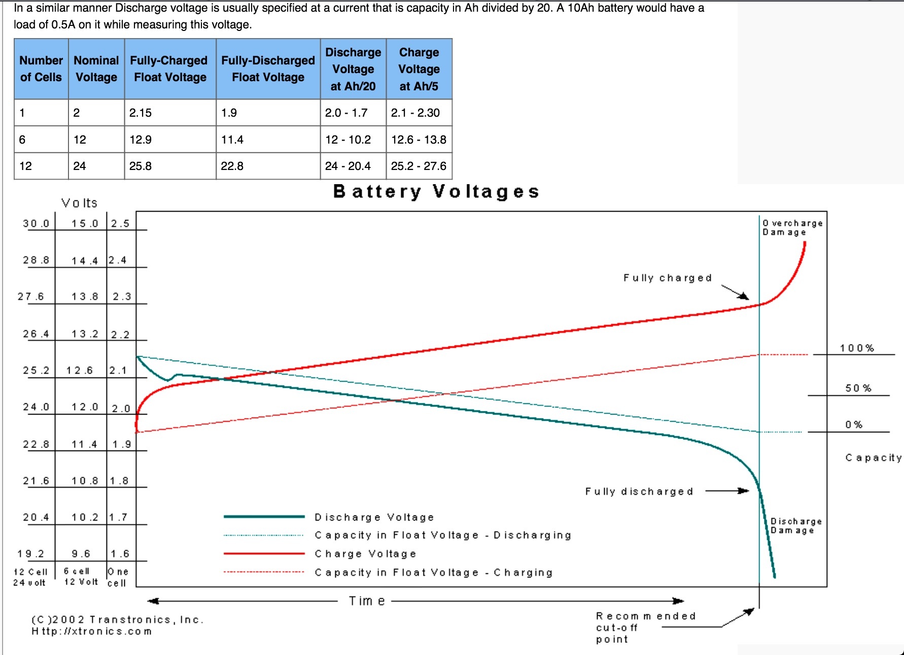

Your requirements do not specify load, surge voltage, battery age, model and are inconsisent with a good design. The design previously given can meet your requirements with some filter delay to prevent false triggering or constant cycling with a badly sulphated cell (high ESR)
You require a reference voltage of 12.5V and 8% positive feedback for hysteresis of +\-0.5 V and any MOSFET power switched either low or high side with RdsOn much lower or <2% than load resistance for cool switching.
Note graph difference between charge and float is 0.9V for 12V SLA using Ah/5 rating. This will vary if your rate is different.
