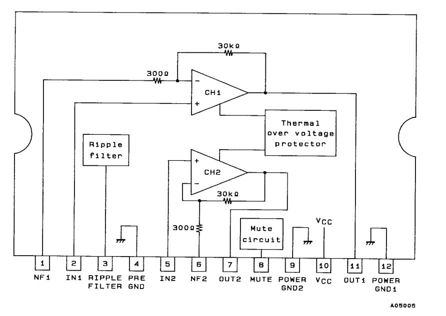

I am trying to build a small desk-sized audio amplifier. I salvaged an old stereo cd player from the 90s and got an appropriate transformer (0-25V secondary) and an audio amplifier chip, the Sanyo LA4282 (Datasheet)
I have separated the block diagram in the attachment.
If you will notice, pins 1 and 6 are labeled "NF"
I am not sure what this means but they do allow one to connect to the feedback network - sort of. The problem is there is always the 300Ω input resistor in the way.
I would like to attach a feedback network for bass, midrange, and treble adjustments, such as a 3-band Baxandall equalizer network. (I read about it **broken link removed**), but any equalizer network will do. I have not researched them exhaustively yet.
The requirements of a passive Baxandall network are low source impedance and high load impedance - in the feedback loop, this seems perfect! The output of the power amp will be low impedance and the input should be high.
The problem is I am always going to connect my feedback network in parallel with the existing 30k/300 gain network, so I don't think it will work.
Would it be possible to do this or would I have to do my equalizing in a preamp stage?

The resistors built into the chip set the basic gain of the amp...Look at the typical app circuit..it shows 1 pin decoupled with a 100mfd cap...
Your tone controls can go before the input of the amp...An active Baxendall cct will minimise insertion loss, maintaining the input sensitivity of the amp..
Yes that makes sense. What opamp would you recommend for an active baxendall to keep the best sound quality possible?

Doesnt have to be a JFet op amp....anything like the 741 will do..
IMHO, garbage grade amps like a 741 do not have enough slew rate for good transient response, so I don't recommend them for audio applications. I liked the LF356 because it has good slew rate, it's unity gain stable, and it's low noise. There are lots of good op amps, but I don't think 741 types are good enough for audio use.
