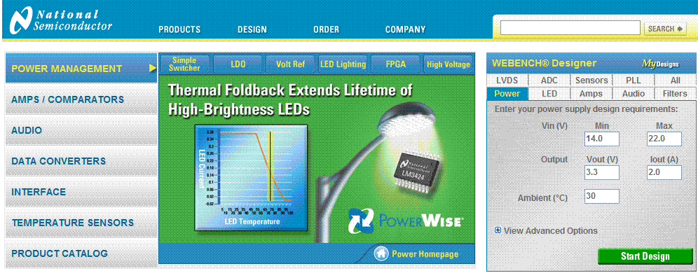

Schmitt Trigger,
I went to the National Semiconductor website and used the tool you suggested. It looks like the LM2588 is going to do what I need. What do you think? The only downside is as best I can tell Mouser does not carry any of these parts and they are my preferred supplier. They are in Dallas and I'm in Houston so shipping is usually cheap and I almost always get my order the next day even though I only pay for normal UPS ground. I also wasn't successful at finding any equivalent ICs made by other manufacturers that Mouser carries. Oh well, you can't have everything I guess.

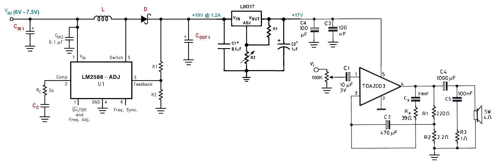

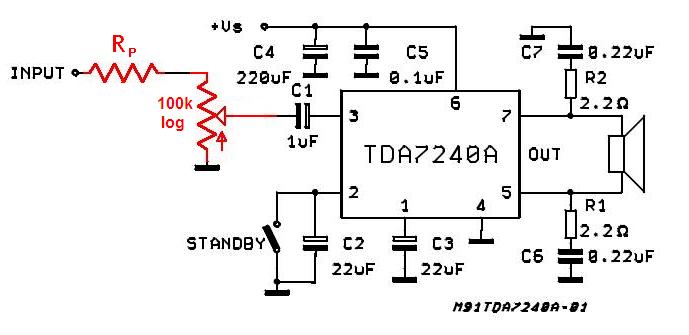

I’m having some trouble moving forward with my design. My difficulty is coming mostly in the form of determining component values for the switching converter portion of my circuit but I have a few other questions too. I downloaded the switchers made simple software from National Semiconductor and also tried their online tools but for the life of me I still couldn’t figure it out. Here are my questions:
  1. The current plan is to connect the voltage going into the switching converter directly to the car’s battery, however this voltage will not be constant. The battery voltage of the car varies between 6 and 7.5V depending on engine RPM. Is it necessary and/or beneficial to place a voltage regulator in between the vehicle battery and the switching converter so that the converter sees a nice stable voltage at its input?
  2. I’m unsure, because of my inability to use National’s software, what component values to use for the switching converter. I attached a schematic of my preliminary circuit. The components shown with red labels are the ones I’m unsure of.
  3. It would also be helpful to get some feedback on the circuit itself. Is there anything you see that’s outright wrong? Are the other component values I’ve chosen (the ones without red labels) appropriate? Any comment you have would be helpful.

Get rid of the LM317 voltage regulator because the switching converter regulates its output voltage. Set it for 15V then the TDA2003 amplifier will produce 5W into 4 ohms.

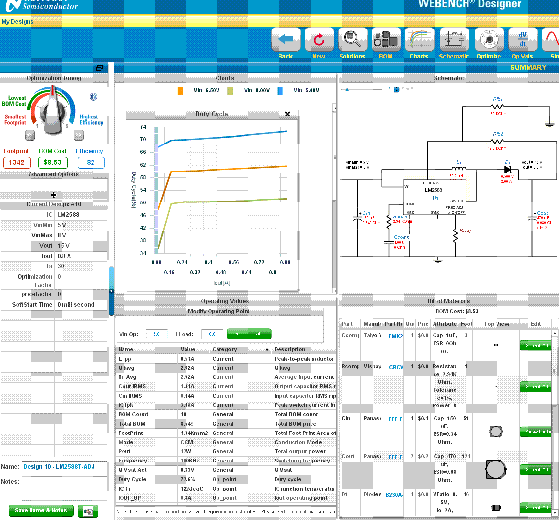

  1. -The Nat Semi's software WILL PROVIDE you with both an annotated schematic and a Bill of Materials which lists the value AND full description of each component.
    See the attached file of an example circuit which I had run previously.
    -Also as Audioguru mentioned, you DO NOT require an additional linear regulator after the switching regulator. Yes, there will be some ripple, but it will be at least 15 to 20 times higher than the highest audible frequency. Very straigthforward to filter, if required.

The switching converter does not need its input voltage regulated.
The ratio from no distortion to 10% clipping distortion is 0.7 times. So 6.5W at 10% distortion with a 15V supply means that the amplifier begins clipping at 4.55W (simplified calculations). The difference in volume between 9W and 4.5W is small. You will not hear the difference between 4.55W and 4.5W.
Amplifiers have a power supply hum rejection spec where the ripple is attenuated. It should be very low at the output of the amplifier.

Thanks for the advice. I'll ditch the LM317, change the supply voltage to 15V, and also forget about placing a voltage regulator at the LM2588 input.

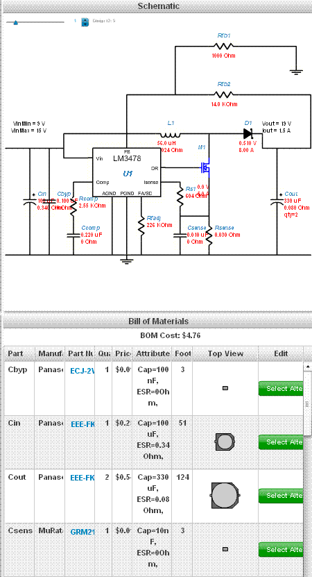

Schmitt Trigger,
I'm sure that the software will provide me with the info you stated, but I just can’t figure out how to work it. The problem I keep running into is I can't figure out how to load the adjustable version of the LM2588. Whenever I select the LM2588 the schematic and component values are for the 12V version and I can figure out how to change that. Maybe I'm slower than the average bear but I’ve seriously spent hours trying to figure it out. I know it's asking a lot but if you have time would you mind seeing if you can run the software for the following conditions:
Device: LM2588-ADJ
Input Voltage: 5 - 8V
Output Voltage: 15V
Max output current: 800 mA
For the current requirement I looked at the data sheet for the TDA2003 and found that for a 15V supply across a 4 Ω load the maximum power output would be 6.5W. Also from the data sheet the maximum power dissipation looks to be around 3W. So:
6.5W + 3W = 9.5W, I = P/V = 9.5W/15V = 633 mA.
I just bumped it up to 800 mA for a little buffer. Does that seem reasonable?
I would really appreciate your help with the software. Thanks in advance.

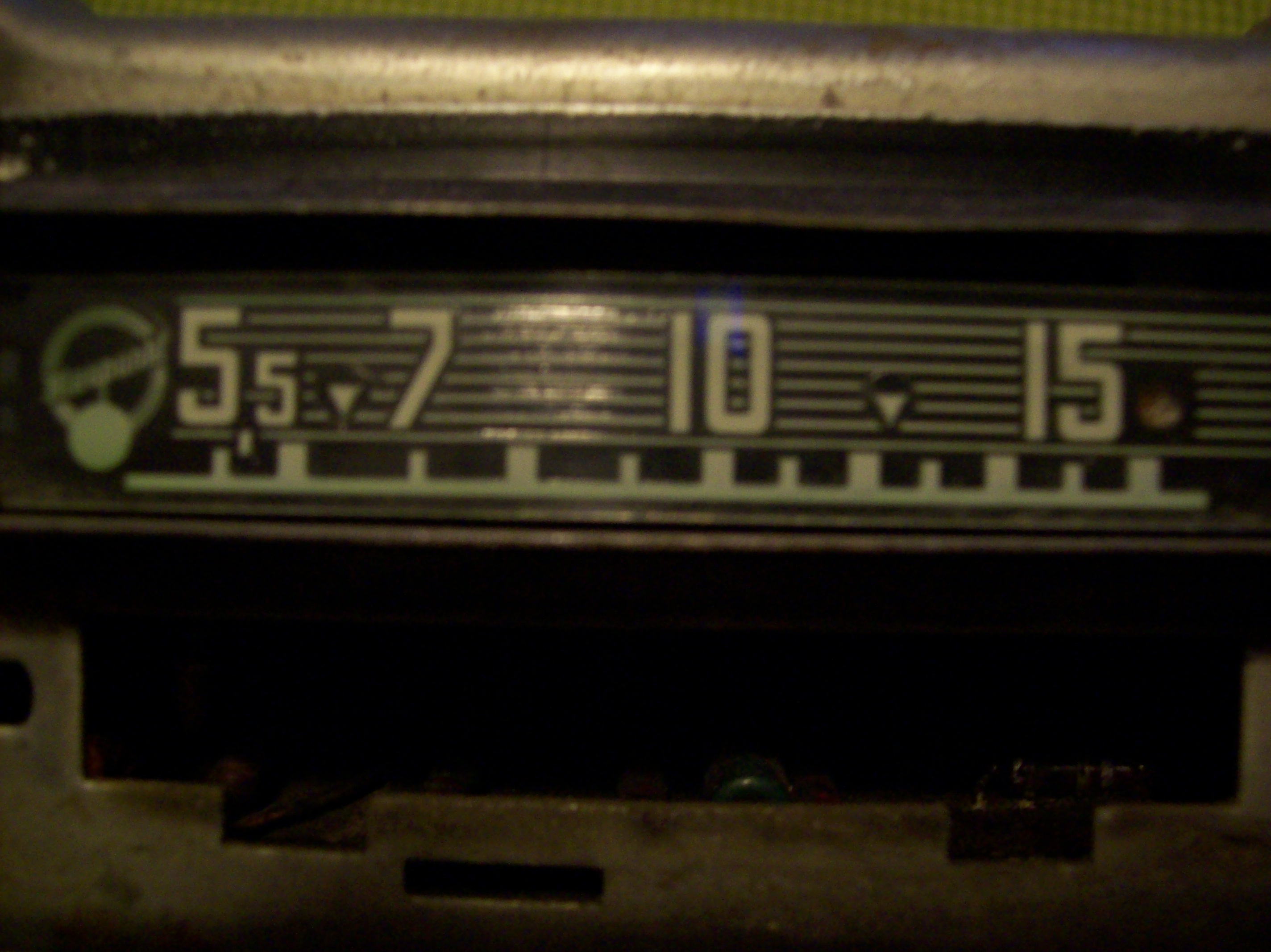

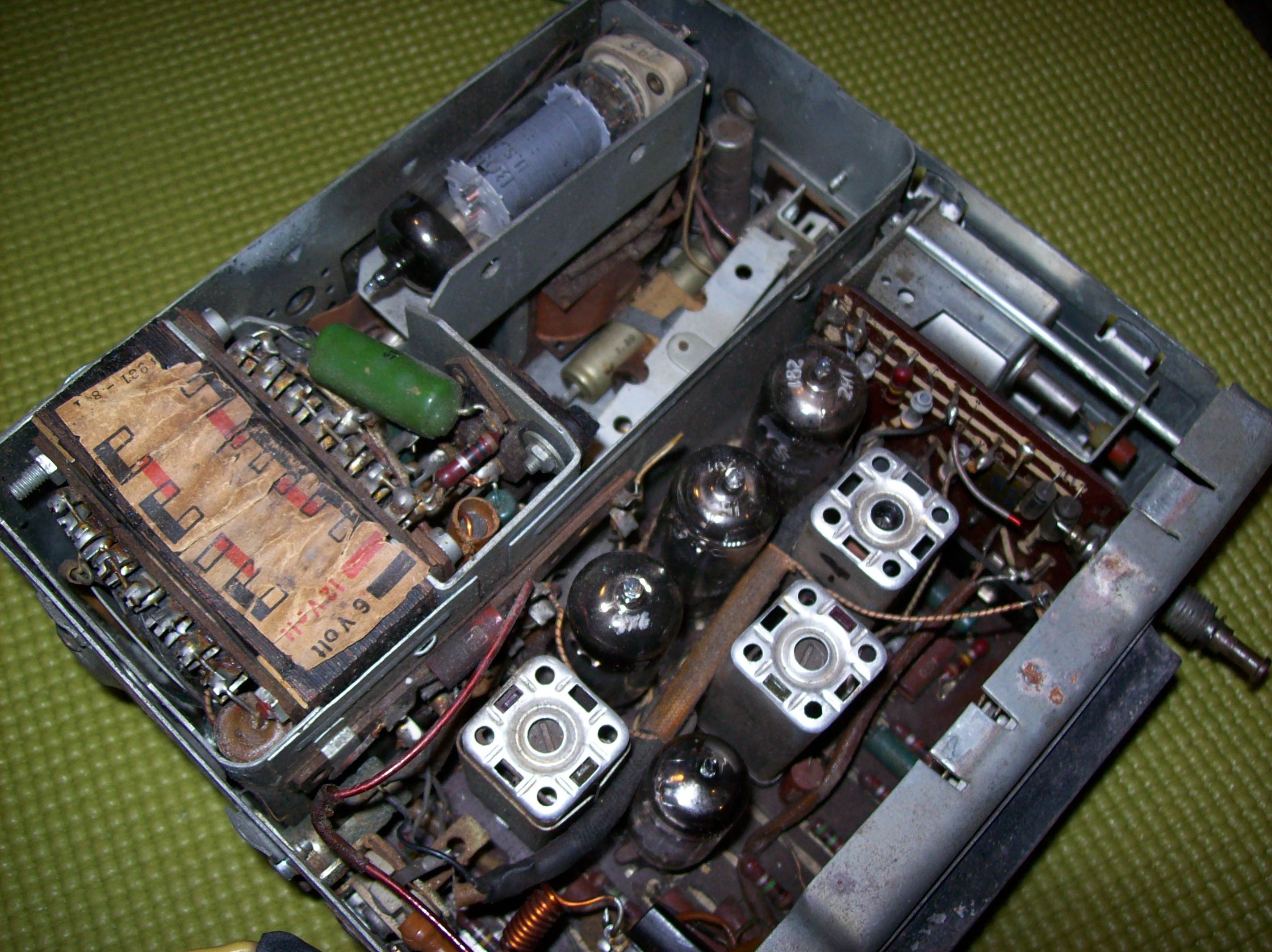

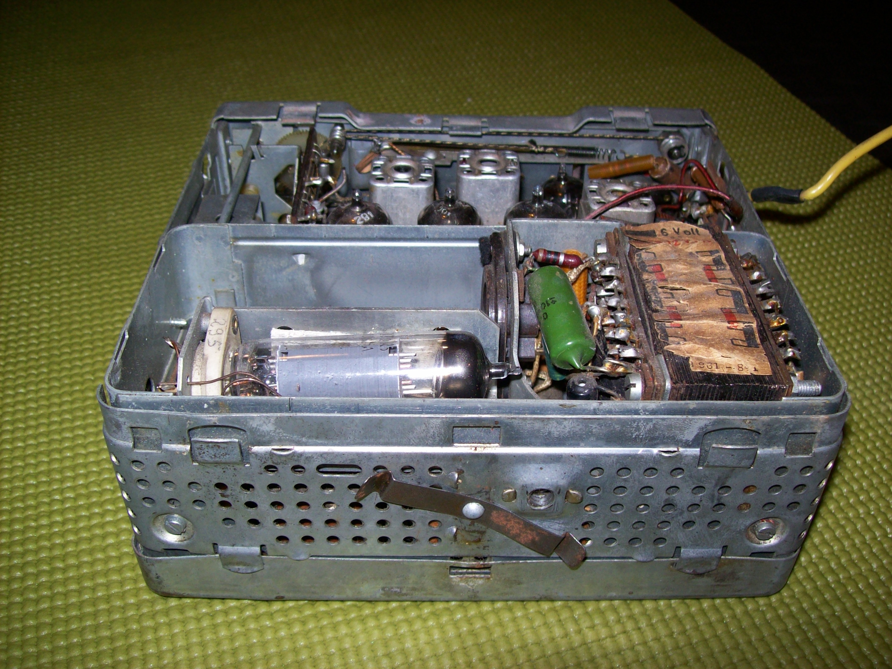

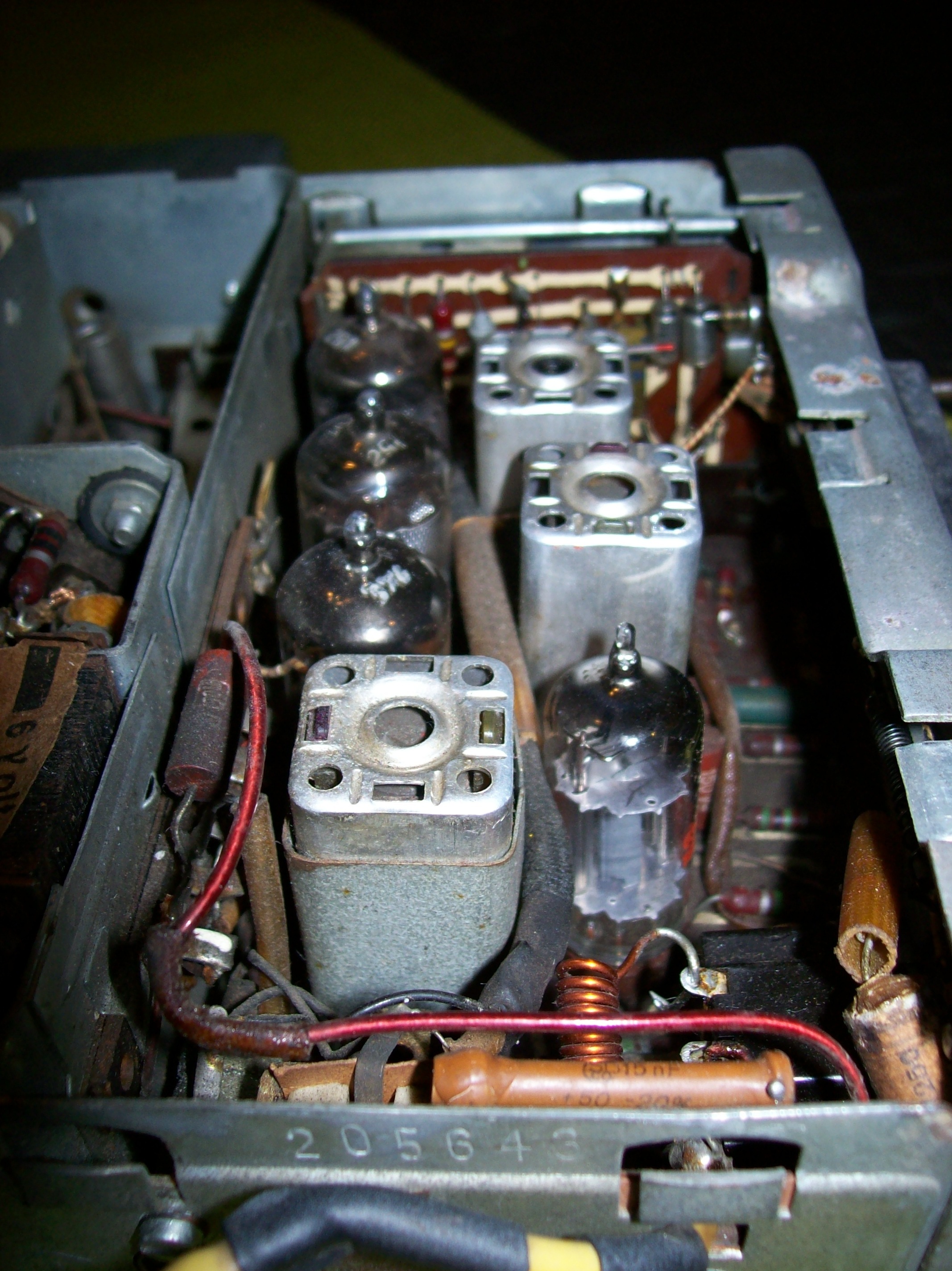

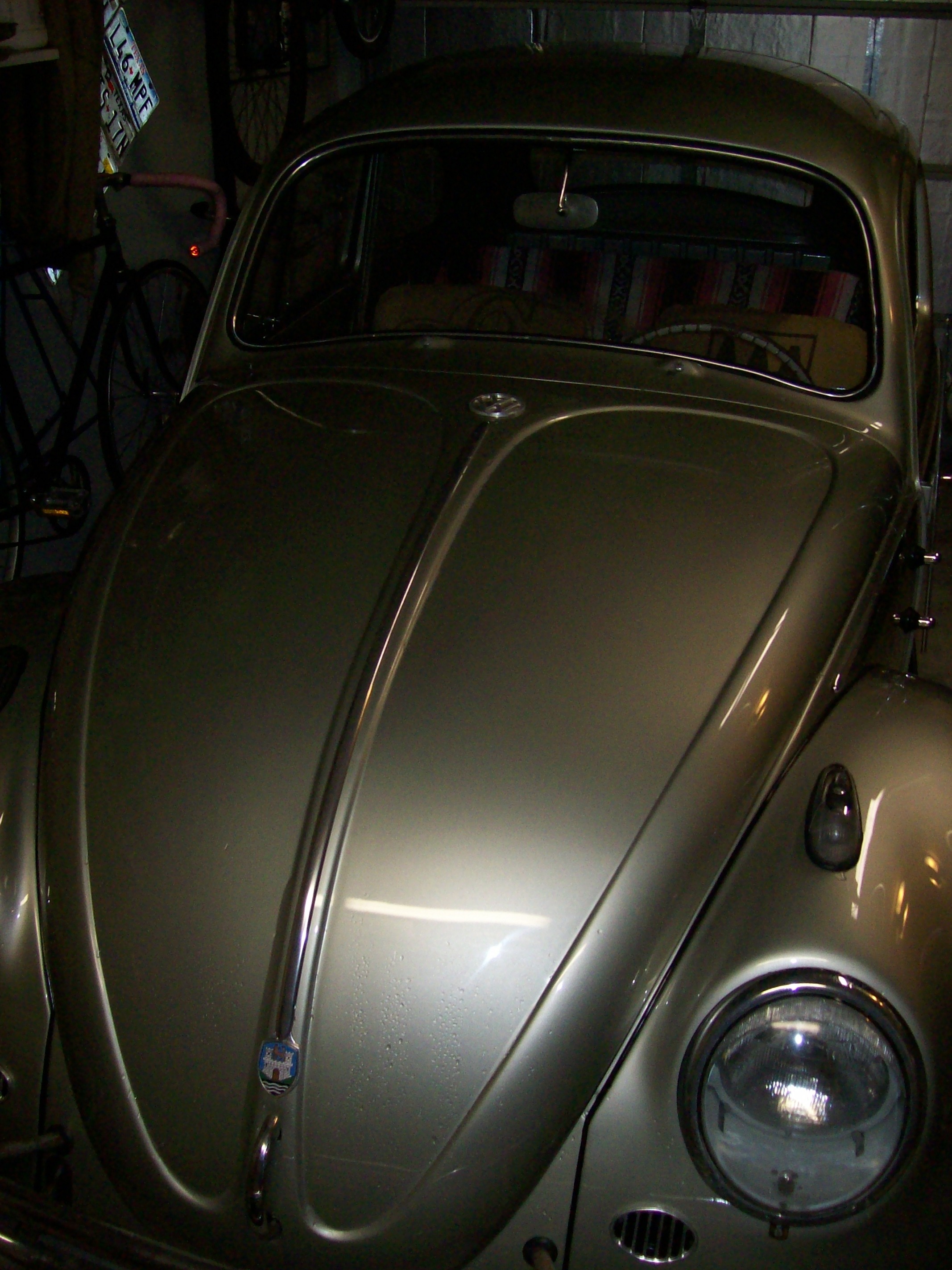

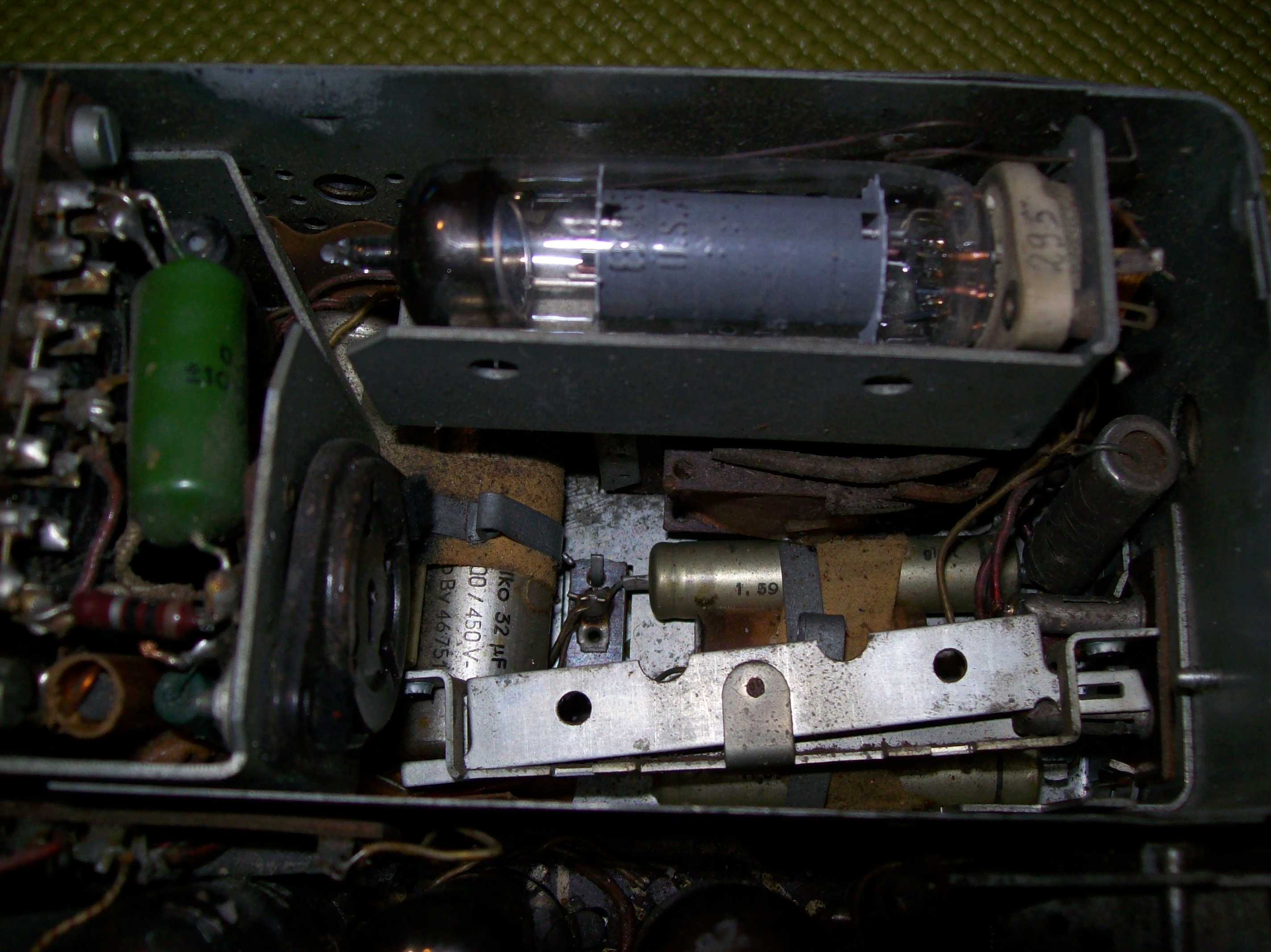

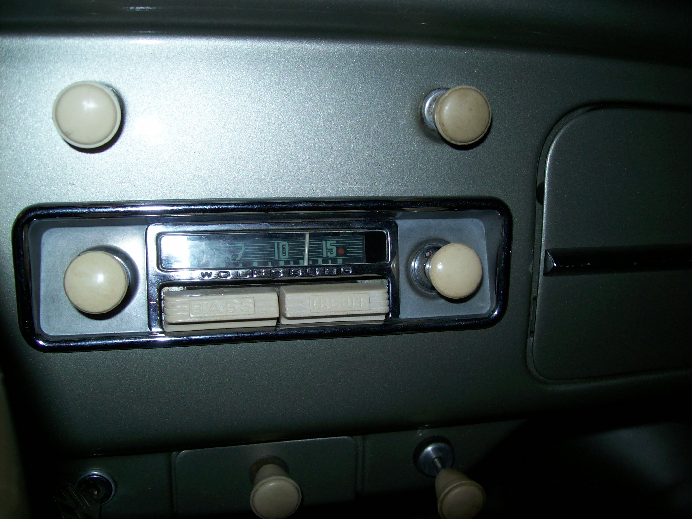

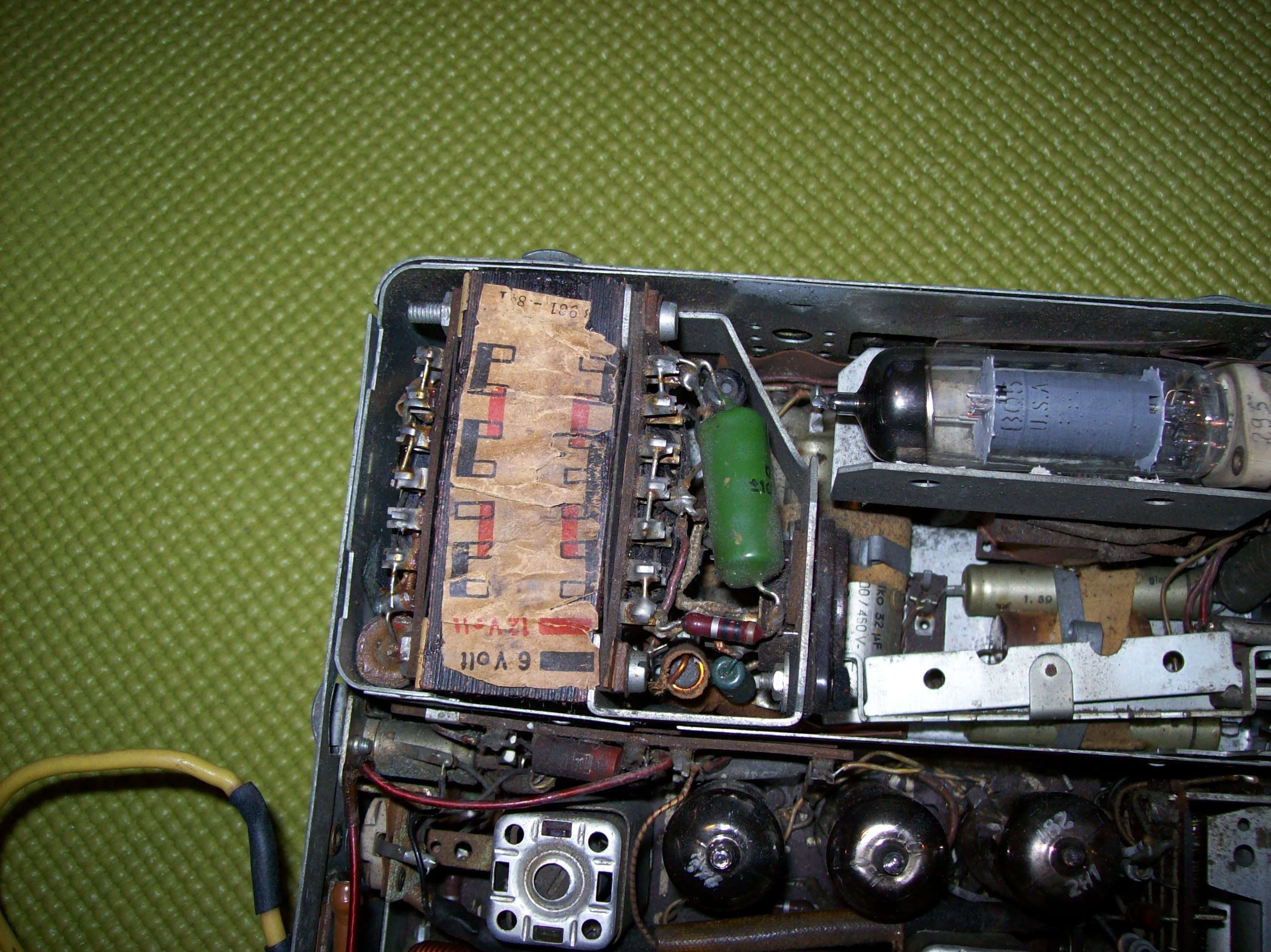

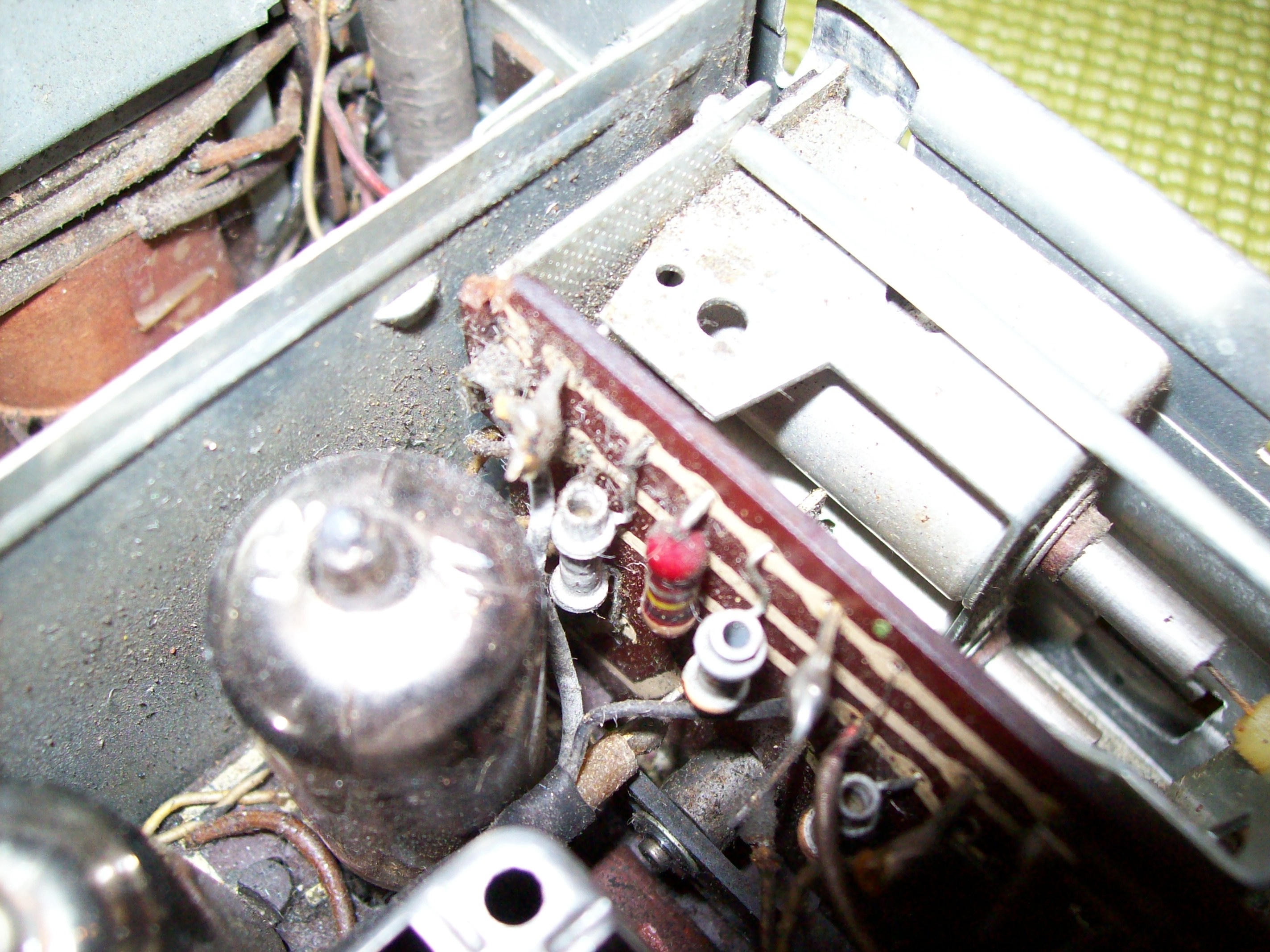

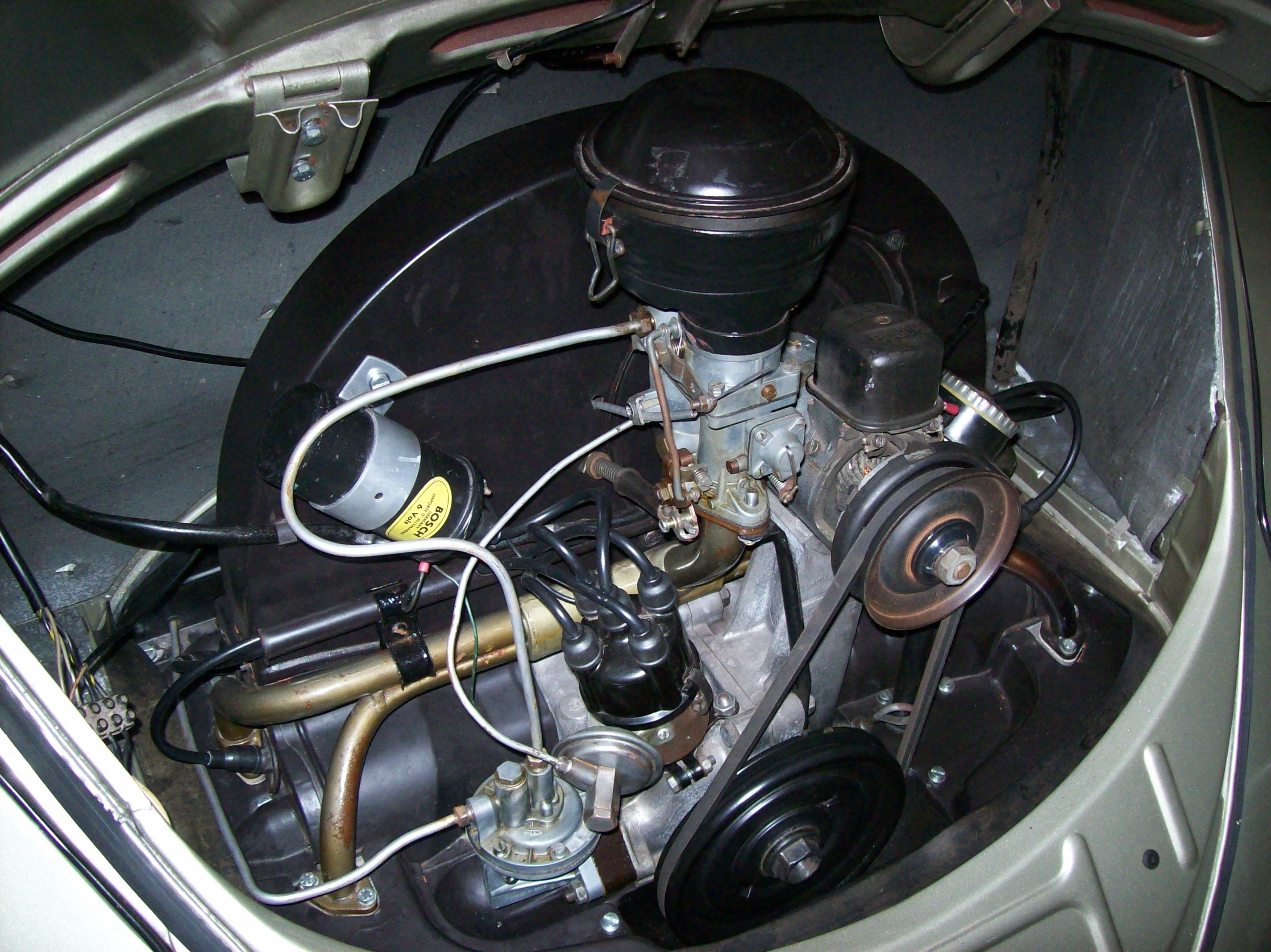

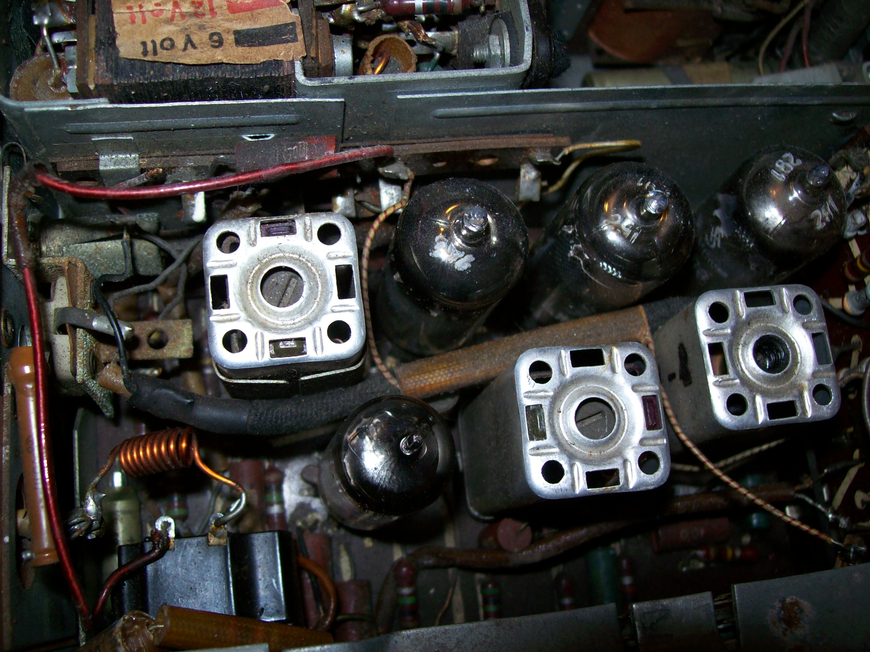

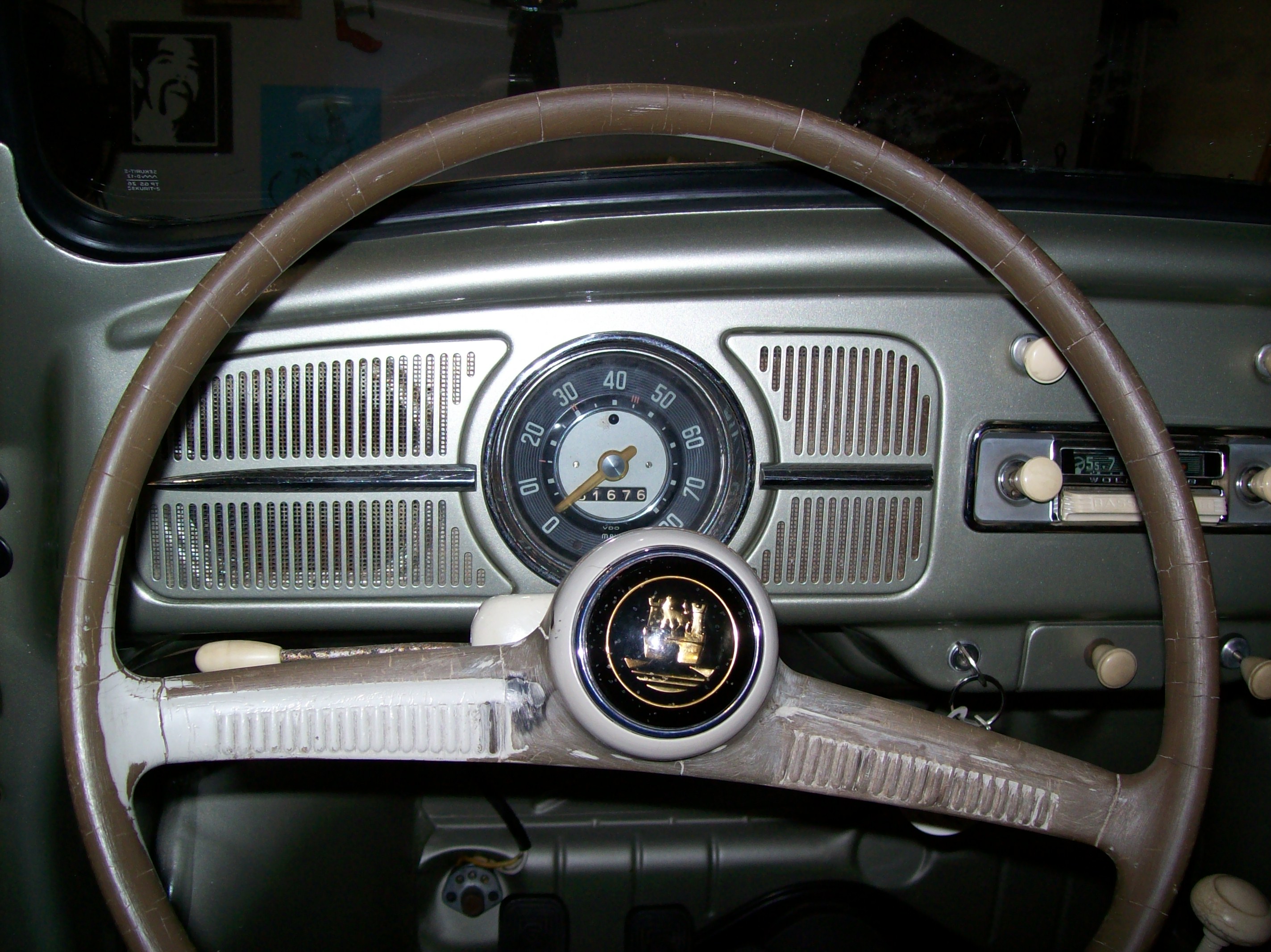

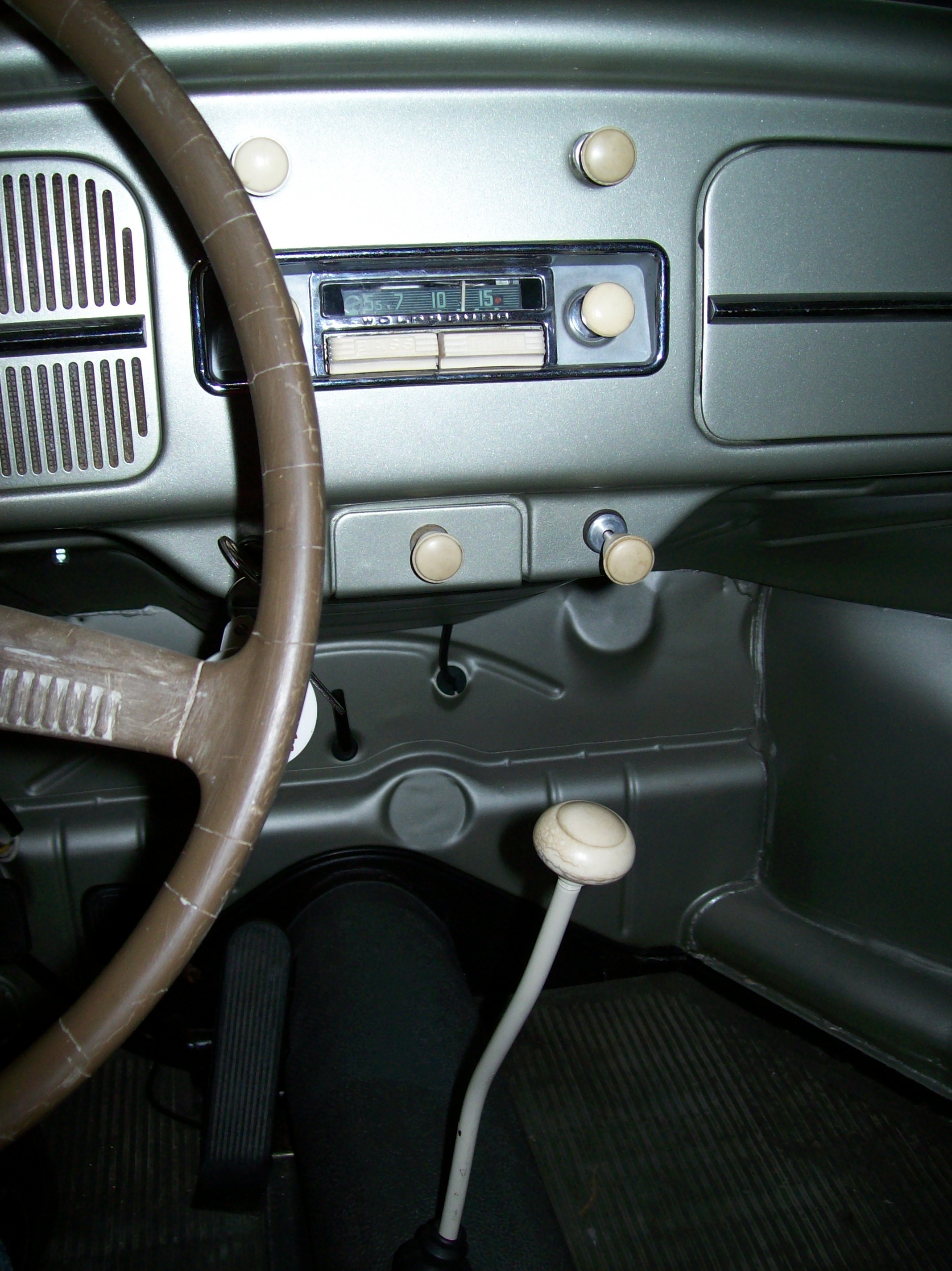

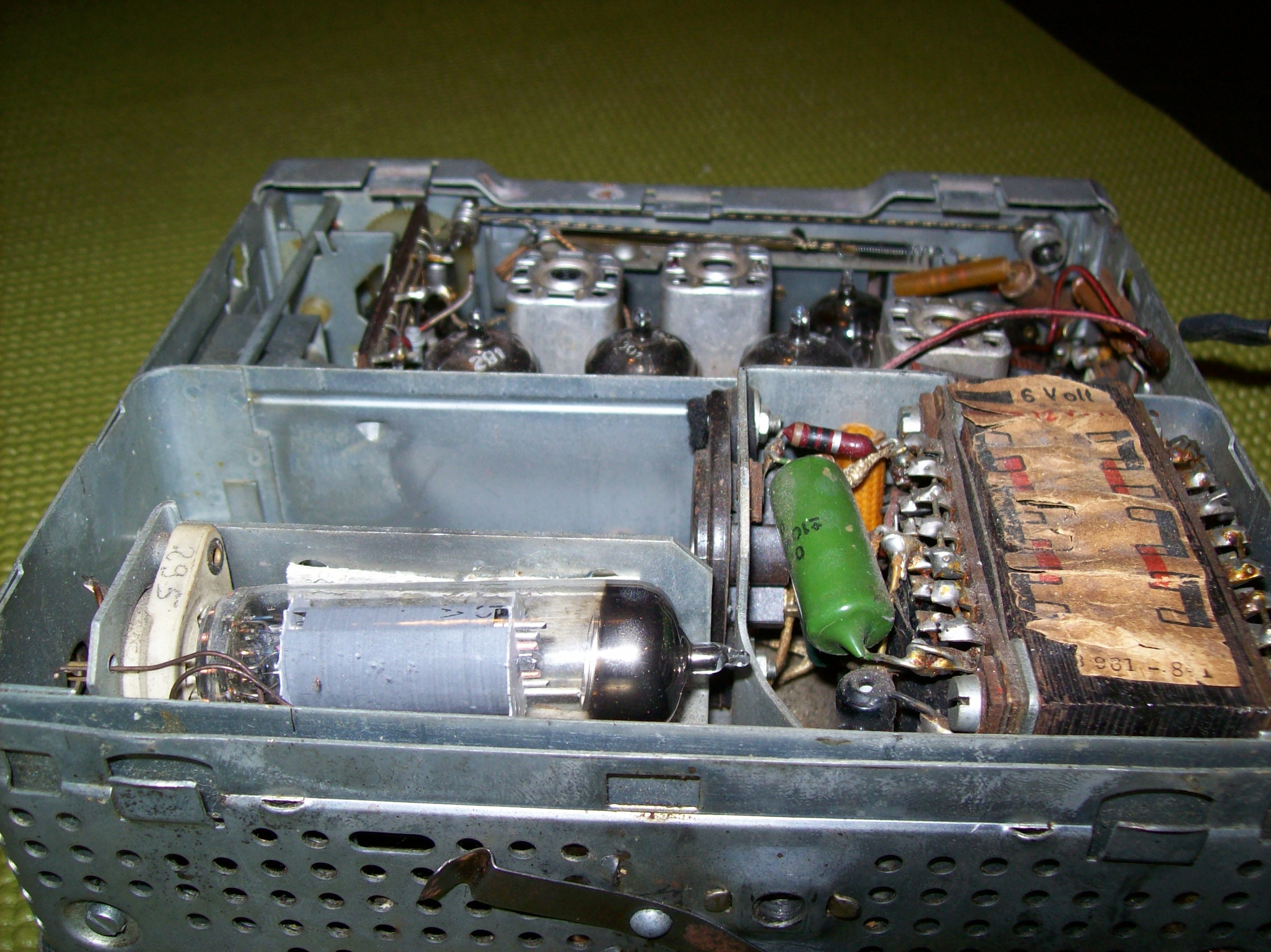

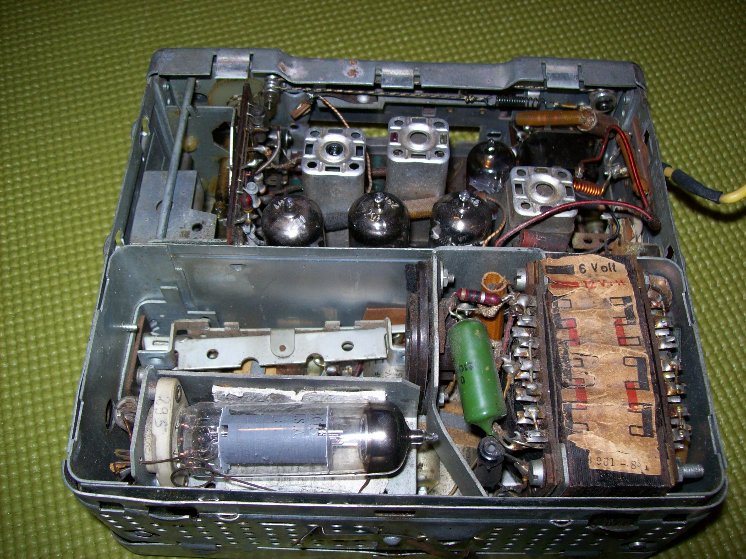

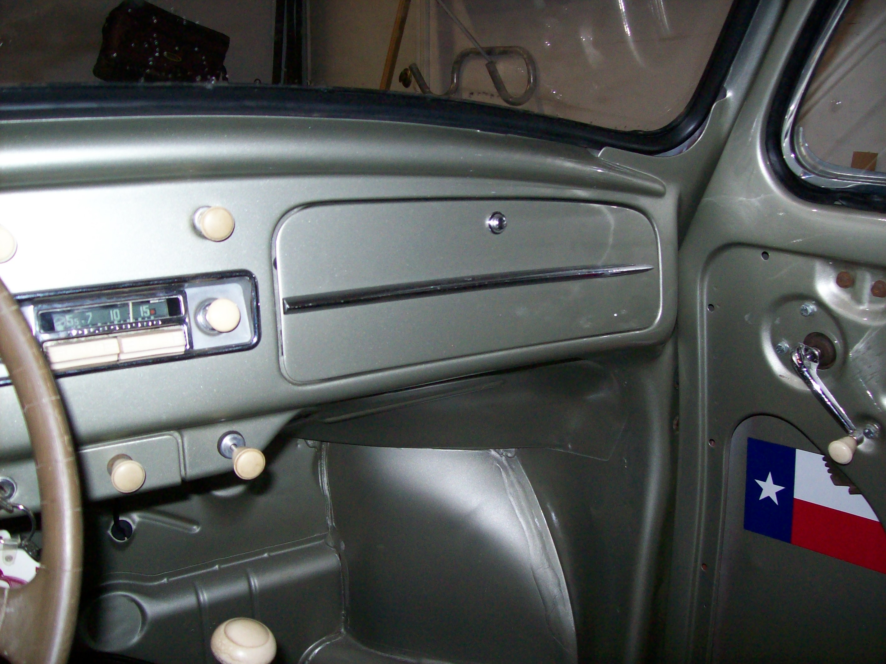

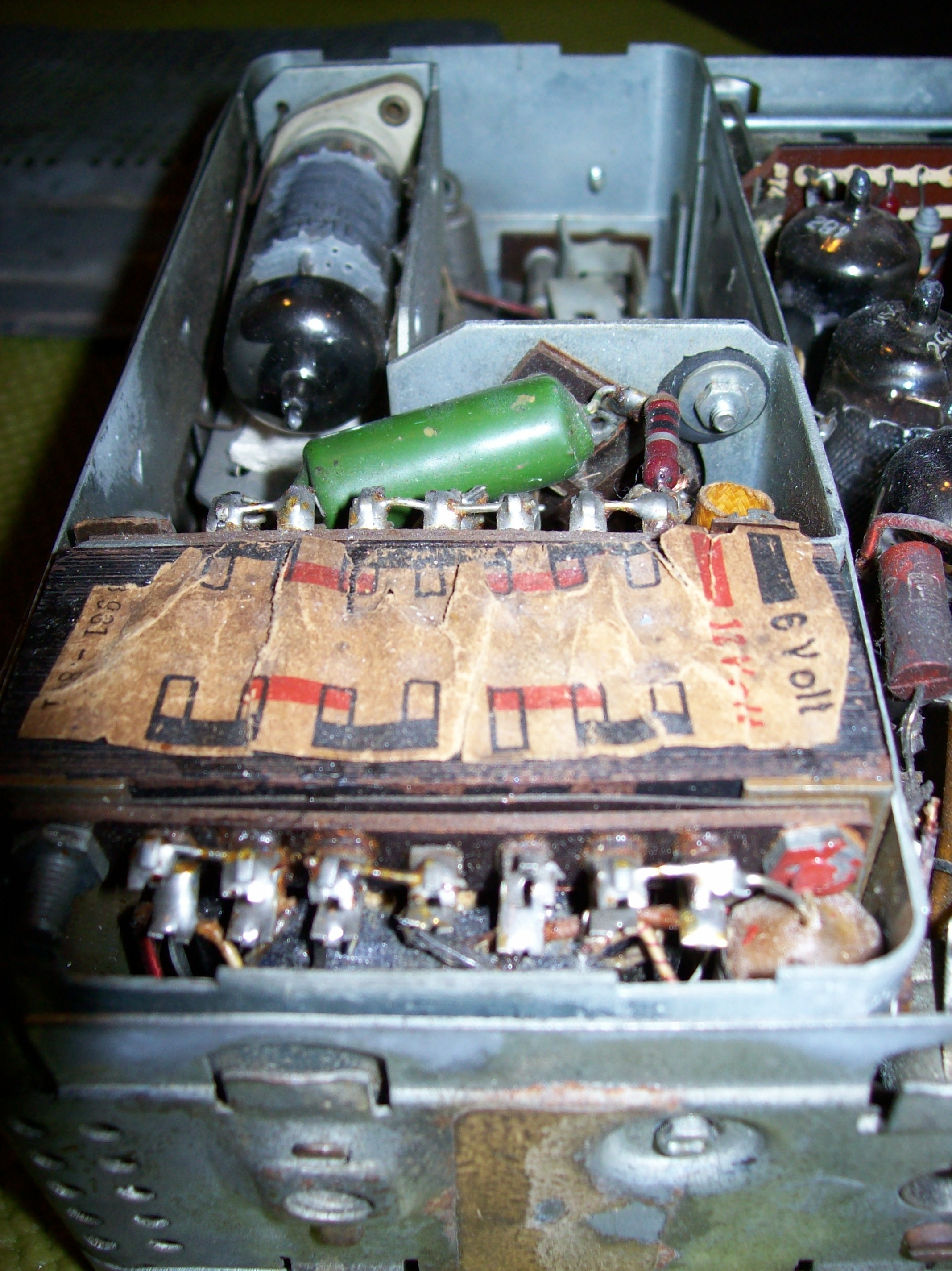

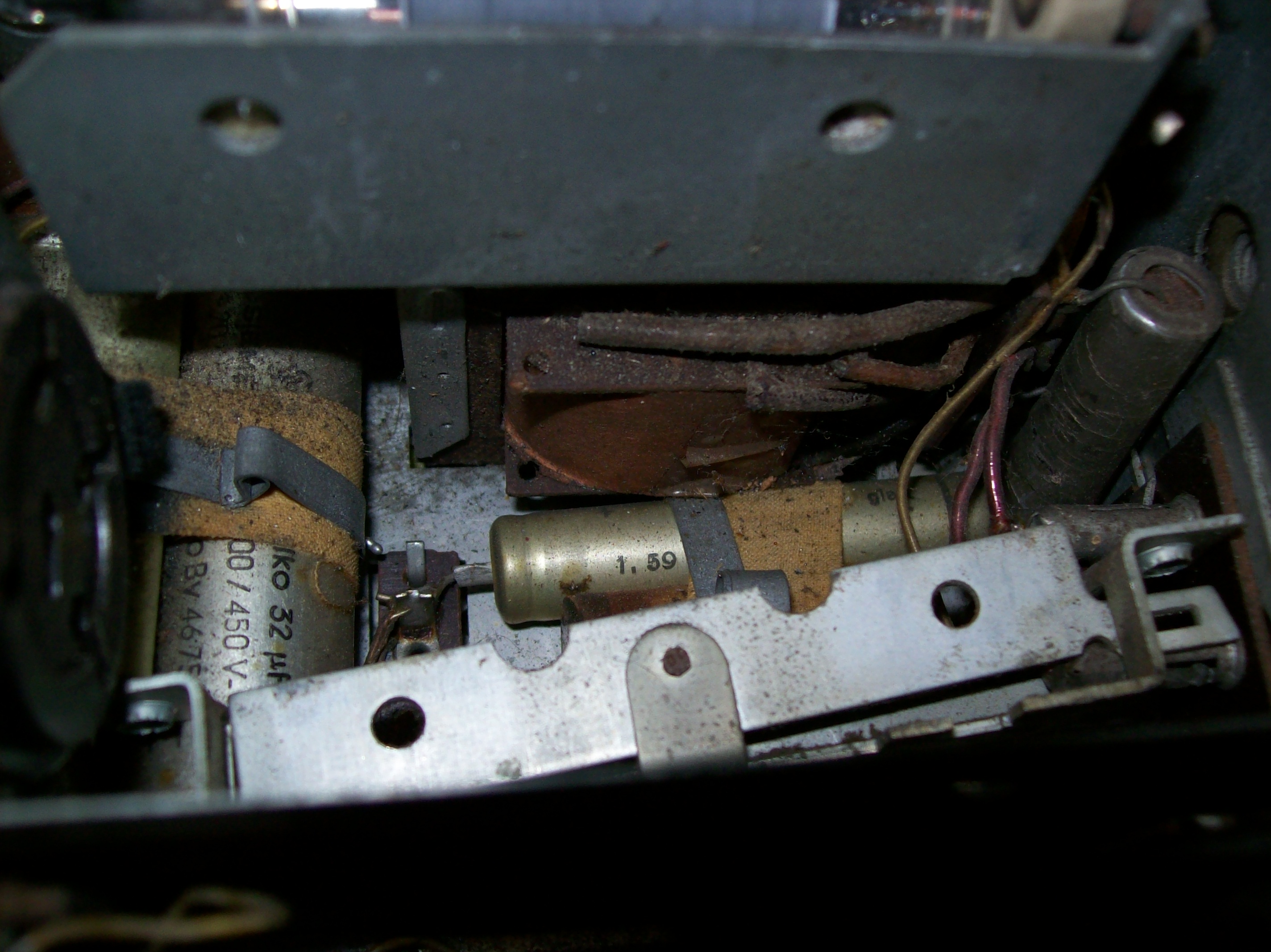

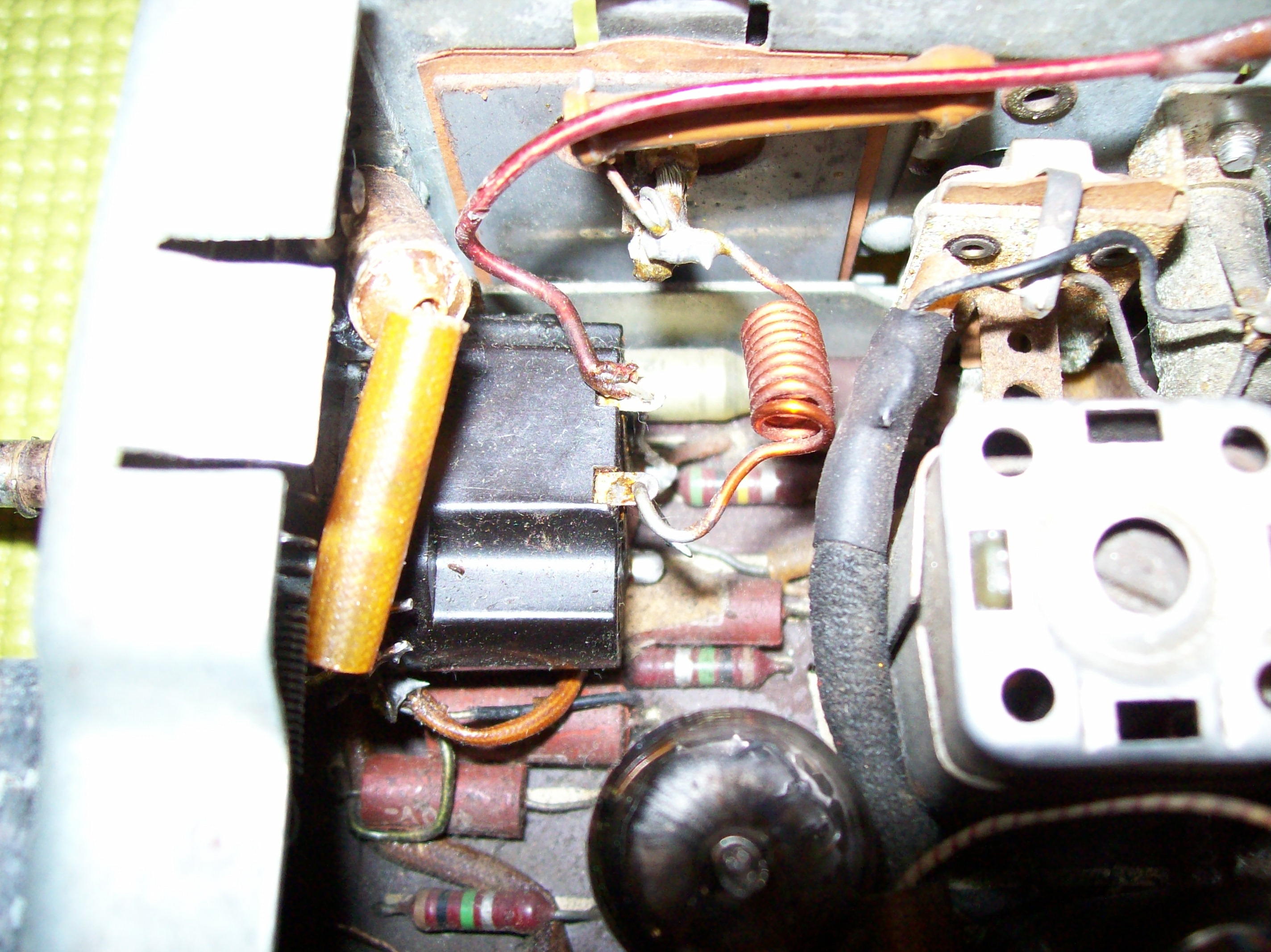

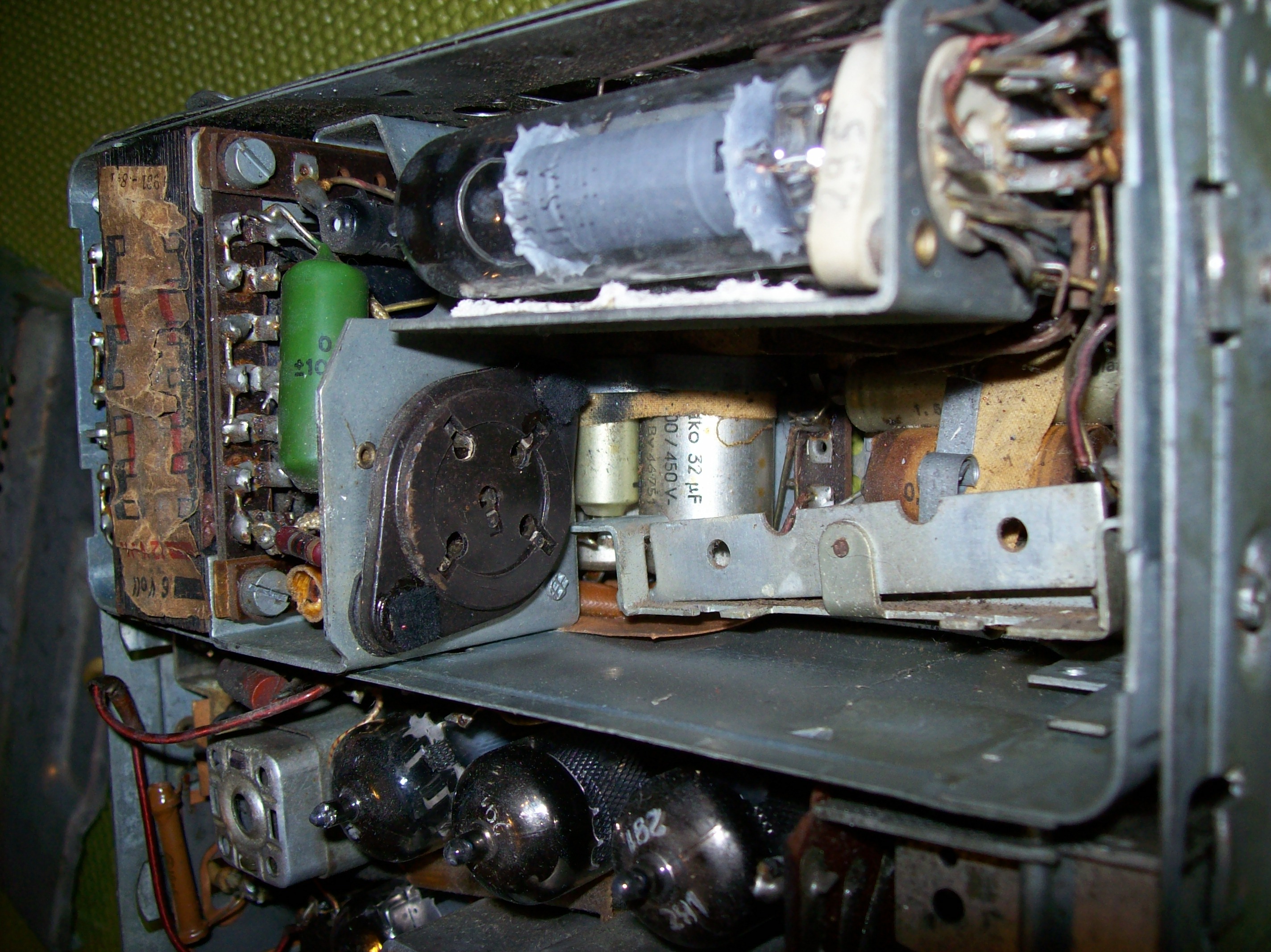

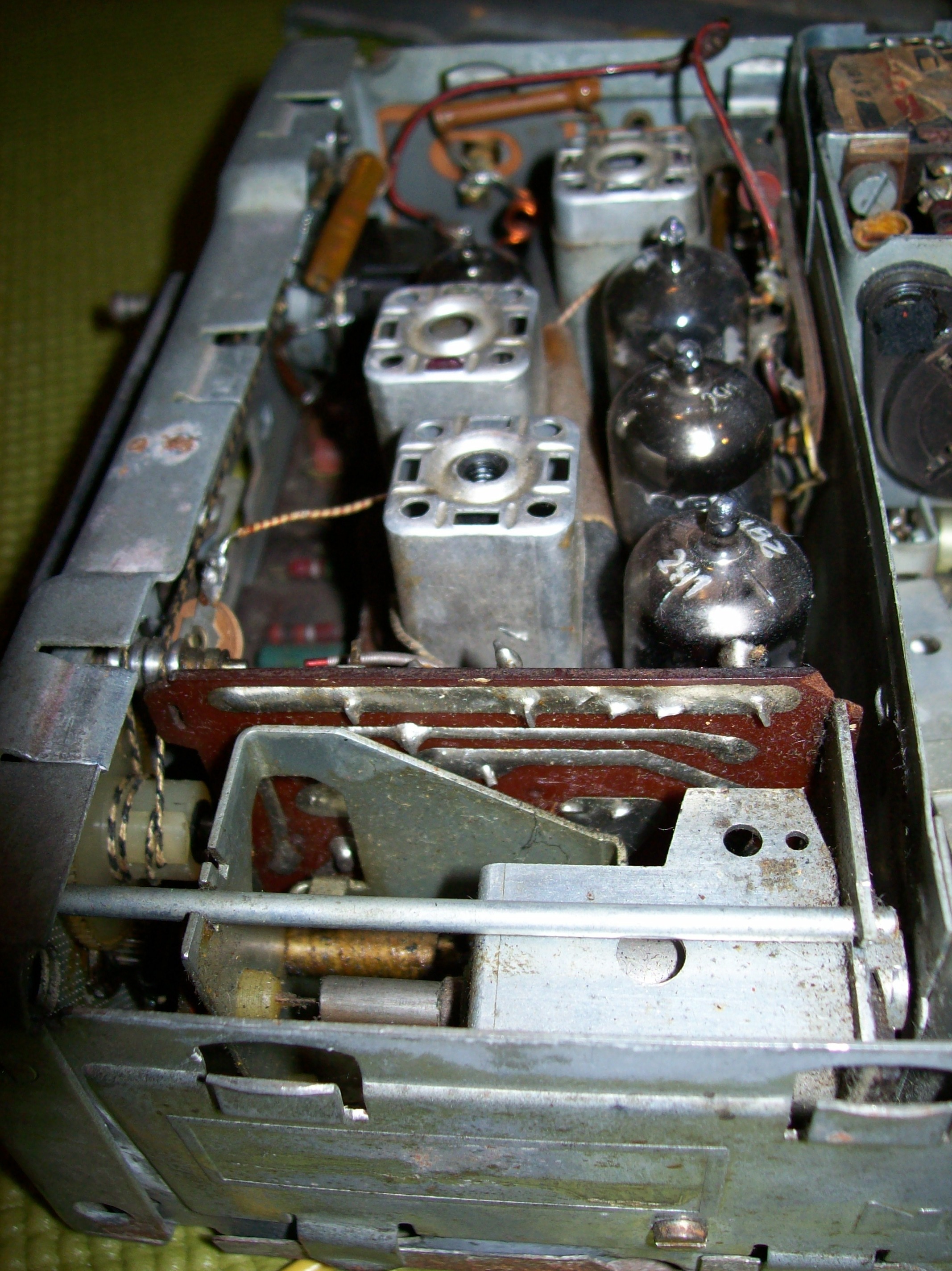

Also, as promised here are some pictures of the VW radio. There are actually pictures from two different radios here. The working radio is installed in the car and my friend didn't want to take it out because he said it is a major pain in the a$$ to get it back in. However, he has a second non-working radio that he used for parts. It is almost complete and is just missing one of the tube amplifiers. I hope it satisfies your curiosity. Enjoy.
And last but not least:
The plan seems too complex and somewhat wrong for the task.
If it will stay with one speaker to keep originality, the MP3 source can have both earphone or better line-out channels merged and fed to the radio volume potentiometer with a selector switch.
Is that a vacuum tubes radio ? Is it 6 V ?
The 5V MP3 power source can be obtained from the 6V VW electrical with a couple of 1A Si diodes in series to bring it to around 5V. A 7805 is not a good choice. Perhaps a 2950-05 if you really want regulation.

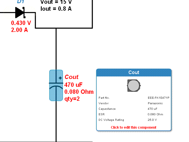

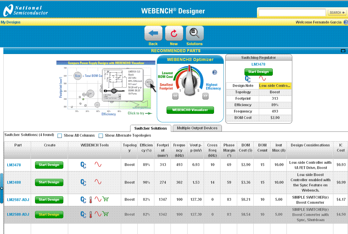

VNE147:
I already simulated it, and the solution is included on figure STEP 3, but I really want you to learn how to do it; because you may want to play around with the component selection, as some of the components you may have the need to substitute, and you can run the simulation again and see how the performance is affected.
So here it goes, in three easy steps:
On National's web site, on the WEBBENCH DESIGNER box, enter the apropriate voltage and current parameters see figure STEP 1. Click "START DESIGN".
If you have not decided upon your preferences, the next screen will ask you whether you want an HTML or Flash-based design. The Flash is much better, so select that.
Then a screen will appear with the recommended devices, see figure STEP 2. Highlight LM2588-ADJ and press "START DESIGN".
The computer will think for a few moments and Voila! you get screen shown in STEP 3. There it is, your solution. On the "Bill of Materials" you can scroll the component selections. In case you want to substitute. Click the "Select Alternate Part" Button, and the software will automatically recalculate everything and display that for you.
Also, in the schematic itself, if you point the cursor on any component (STEP 4), it will provide you with full details on that particular component.
It is really easy!

schmitt trigger,
I followed your instructions, sort of. I have to use the html version because I'm at work and we're restricted here. Anyway, I could have sworn I already did what you described but this time it worked. I mean it's pretty simple like you stated so I don't know where I went wrong before. Thanks!
