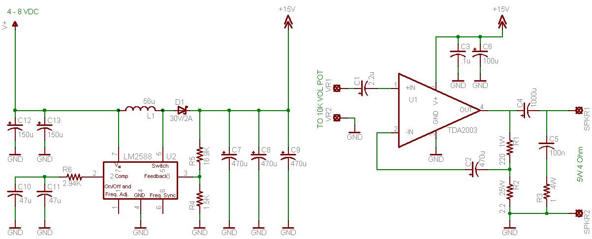

OK, so here is my schematic for the boost converter and amplifier. It is pretty much right out of the data sheets.
For the boost converter stage, I changed a few things from what National’s software told me I should do. Digikey was out of the 47 uH inductors so I’m using a 56 uH one instead. Also, the recommended value for the Cin capacitor was 330uF but I had a couple extra 150uF caps that I am going to use in its place. Also, similar deal with the Ccomp cap were I’m using two .47uF caps in place of a single 1uF one. I’m also going to leave the sync and the frequency adjust pins floating.
For the amp stage of the circuit I didn’t change anything except I was uncertain if I needed the Rx and Cx components and what the values should be.
Any comments, corrections, suggested improvements you have for my circuit are as always much appreciated. I’ll wait to hear everyone’s inputs before I design the board. Thanks.

Couple of things: from the component datasheet DO CHECK that you can leave the sync and the frequency adjust pins open, or whether you have to tie them to gnd/Vdd.
Although higher inductance is usually not a problem in a SMPS, I would still simulate it and compare it against the performance of the original value.
Also...The 56 uH inductor, what is its current rating as compared to the 47uH?

The data sheet shows boost converter application examples where the freq adj and sync pins are left floating (refer to page 22 in the data sheet, link below). However, the schematic generated by the software shows the sync pin floating and the freq adj pin tied to ground through a Radj resistor of undefined value. Not sure what that's all about.
The substitution of the 47 uH inductor with a 56 uH one was one of the options offered within the software when I clicked on edit component. The differences between the two inductors are:
L= 47uH / 56uH
R= .022Ω / .024Ω
I= 6.5 A / 6.2A
P= .377 W / .412W
Thanks for the prompt response, let me know if you need any more info.

Ok, got you.
The Radj is only used if you want to modify the base frequency. I would advise, when you create the layout, to leave an empty placeholder there. So you can either leave it empty, or if the need arises to use the resistor, you can solder it without resorting to an ugly dead-bug.

OK, good suggestion. I'll leave a place holder for a resistor just in case. Maybe I'll even do you one better and leave a place holder for a potentiometer. I think I have a few extra 100K SMD pots lying around.
Still haven't heard from Audioguru or anyone on the amp stage of the circuit. I'm unsure about the Rx and Cx components. This data sheet says they are for "upper frequency cutoff" but I don't what frequency is appropriate. I assume that I would not want the amp to cutoff below any audile frequency but I'm not sure. The data sheet instructs you to calculate values for Rx and Cx using:
Rx = 20*R2
Cx = 1 /(2*Pi*B*R1)
I'm guessing that B is the cutoff frequency in Hz? Also, the application example in the datasheet shows those components in dashes. That indicates to me that they are optional but once again I don't know.
I'd like to get moving on designing the board. I guess for now I can make the board using those components and just not include them later if someone tells me they are unnecessary.
Thoughts anyone?

The table on page 4 shows B to be:
B
Frequency response (-3 dB)
Po = 1W RL = 4W
40 to 15,000 Hz
Maybe that's a different B? If it's the right B, 40 - 15K is a big range.
Do you think it would be OK to just not include those components?
The TDA2003 is pretty old. The newer TDA2004A and TDA2005 don't use those components.
OK, I'll just design the board leaving space for those components but not plan to include them at this point. Thanks!
