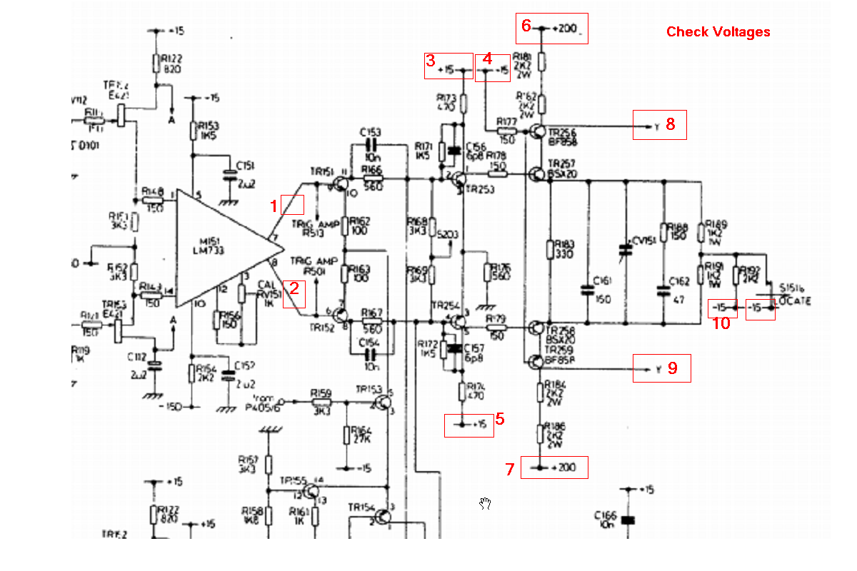

hi Al,
Look at the attached image.
Measure and write on the dwg the voltages you measure at these points and then repost the dwg.
Before you start that:
Set the X and Y shift pots to their centres of rotation.
Also the same for the brightness and focus.
Set the Sync to internal 'auto'
Set the channels to 'chop'
Channel invert OFF
X time base to a mSec rate ie: 10mS/div
Y amps to 5V dc /div
OK.?

Voltages
Hi Eric,
I did my best to get the readings you wanted, but it is very difficult to follow the diagram to the board as there are no silkscreen prints on it so some of the readings are from the resistor you wanted but I could not discriminate which end was which, in these cases I have drawn the layout and measured both ends.
Here are your values of the numbers you asked for.
1 5v2
2 5v5
3 15v
4 15v
5 15v
6 measured on R182 107v or 35v
7 measured on R186 180v or 170v
8 measured on R181 107v or 180v
9 measured on R184 160v or 170
10 measured on R191 5v7 or 14v9
10a measured on R192 14v9 both ends
The drawing below shows the board from above as does the board picture in the manual, so you can see which end the relevant voltages are present at.
Hope you can understand my less than perfect method of doing this but its the only thing I could come up with.
Edit: BTW it is the large resistors I measured (R181 & R182) that are getting hot, (R184 & R186) beside them and identical packages are still cool!
Thanks again Eric.................Al
these are OK.
1 5v2
2 5v5
3 15v
4 15v
5 15v
These two are supposed to be the same.! close to +200V
these are the Y plate voltages and should be the same for the trace to be central in the Y axis.
Al
Al,
I dont follow why you have given, for example 107v or 35v, whats that OR mean.?
hi Al,
Sorry about that, managed to see what you are doing with the OR.
It looks like TR256/7 could be sick.
A couple more voltage checks, voltage required for both ends of R178 and R179.
and R166 and R167.

Hi Eric,
R167 has 4v4 o both sides
R166 has 3v4 on left and 0v on right
R179 has 6v4 both ends
R178 has 10v9 leftt and 11v on right.
Hope this is ok mate.
Regards....................Al

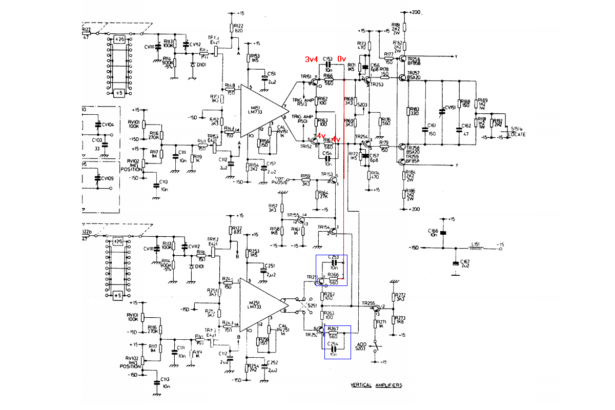

hi Al,
That R166 right shouldnt be 0V.
Look at the attached dwg, the RED line should not be at 0v, its throwing the Y plate amps right out of balance. Thats why the trace is off the screen.
Look at the BLUE boxes. Lift one end of the following components out of the pcb.
C253/R266 and C254/R267. that will isolate the top Y push/pull amplfier from the bottom Y amp.
After you have done that you may get a trace, if you adjust the Y shift.
Repeat all the voltage checks 1 thru 10 and the R166/R167 voltages.
Ideally you want to finish up with the 9/10 Y plates at the same voltage.
Lets know what you find.:)
EDIT:
If that dosnt fix the problem, then check R171/R173. if either of these is open circuit then that voltage on R166 will be 0V.
TR253 could be base to emitter short circuit.
I know its a pain, but I cant see over your shoulder, these are the tests I would do myself..
EDIT2:
As a quick check, measure R171 [1K5] if thats o/c the base of TR253 would be 0V.
These edits are as I keep analysing the dwg, its fuzzy.

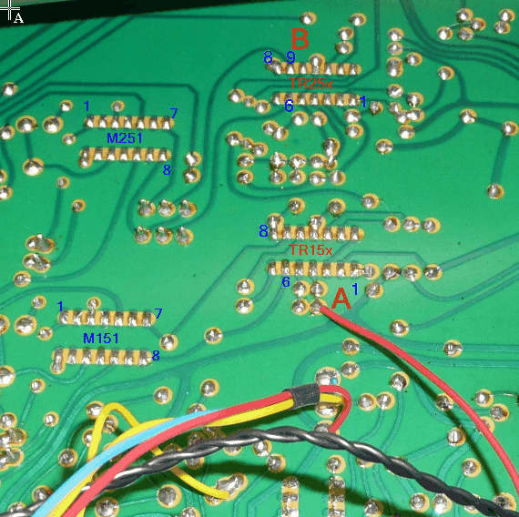

Scope Update
Afternoon Eric,
Right, I found C253 and R266. Do I remove one end of each?
Found R267 but cannot find C254 at all! I think it may be the cap directly above R267 but cannot read the number on the drawing. Hadn't they invented SilkScreening when my scope was made? ;)
Anyway just have a glance and see if you agree.
BTW I re-checked R166 and there is definately 0v on one side ( just thought maybe the probe had hit a bad bit ).
Thanks Eric............Al
Forgot to mention, the drawing shows 10 ICs and the scope has 14! :confused:

Hi Eric,
Removed C253/R266 and C254/R267 still no trace :(
Checked R171 and R173 and both are within tolerances.

I should mention thata all the ICs are socketed on the board (single sided) and I tried swapping the transistor arrays you said.
Results were R167 5v1 one end - 4v8 other end
R166 3v1 one end - 0v other end
after swap
R167 4v9 one end - 4v6 other end
R166 3v2 one end - 0v other end
So very little difference with swapping mate.
Al
hi Al,
Been thru all the photo's.:)
Traced the ic/tracks, marked on these attached images.
These should help you get a fix on the layout.
The CA's are both the same way around.
Let me know how it goes are you going to buy some new CA's
