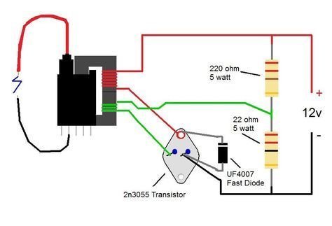

Pictures would help. These don't sound like yours but...
i wouldn't try arcing the big red wire to anything without knowing what it is.... but that oscillator should give you enough voltage on the other windings to identify most of the connections... make sure the 2n3055 is properly heatsinked too... some of the windings will be isolated, some will not. be careful around the high voltage wire as well as the focus and screen wires. the high voltage wire and the focus wires have enough voltage on them to fry a typical DMM, and the screen voltage could damage some cheaper meters.

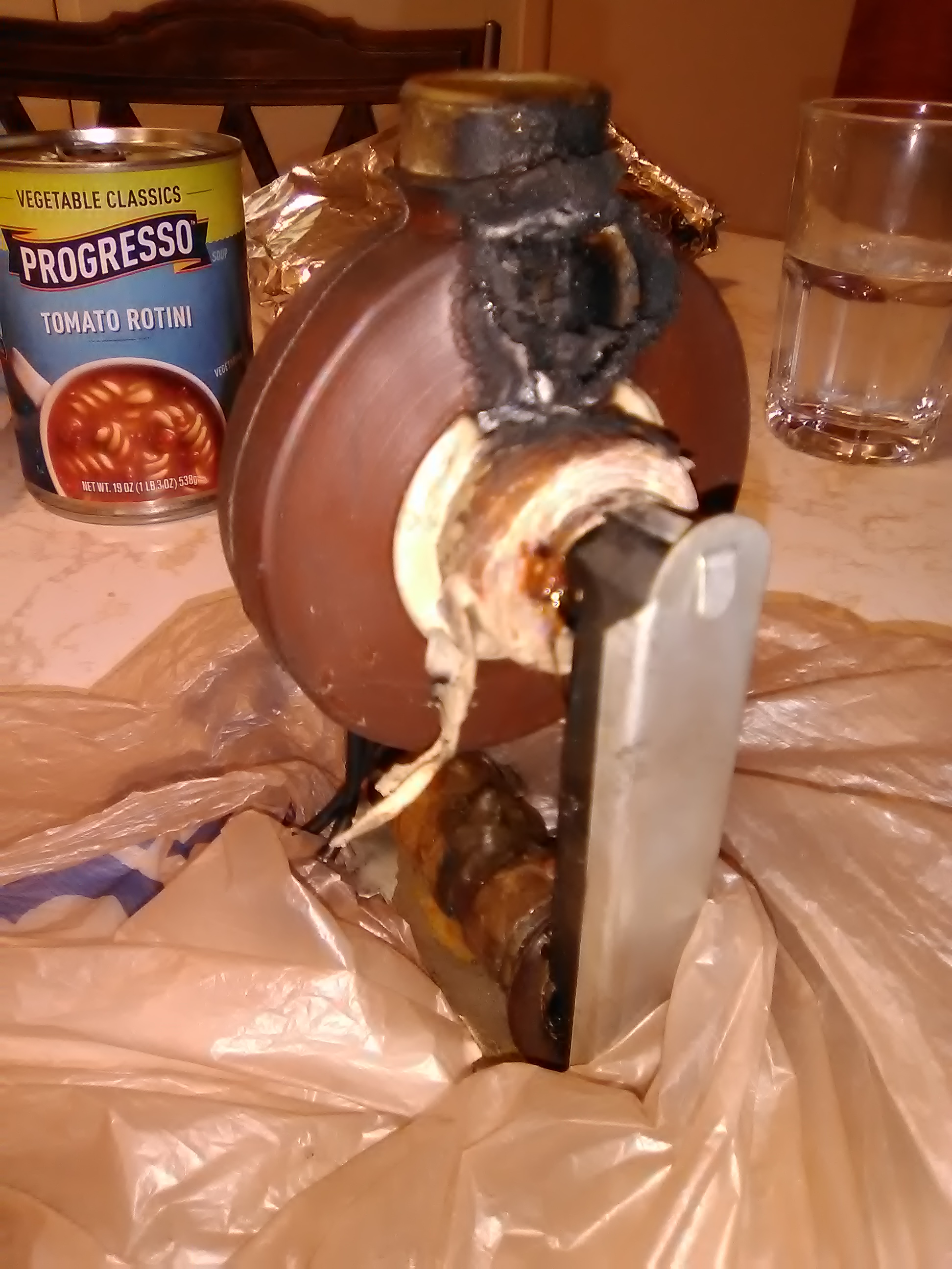

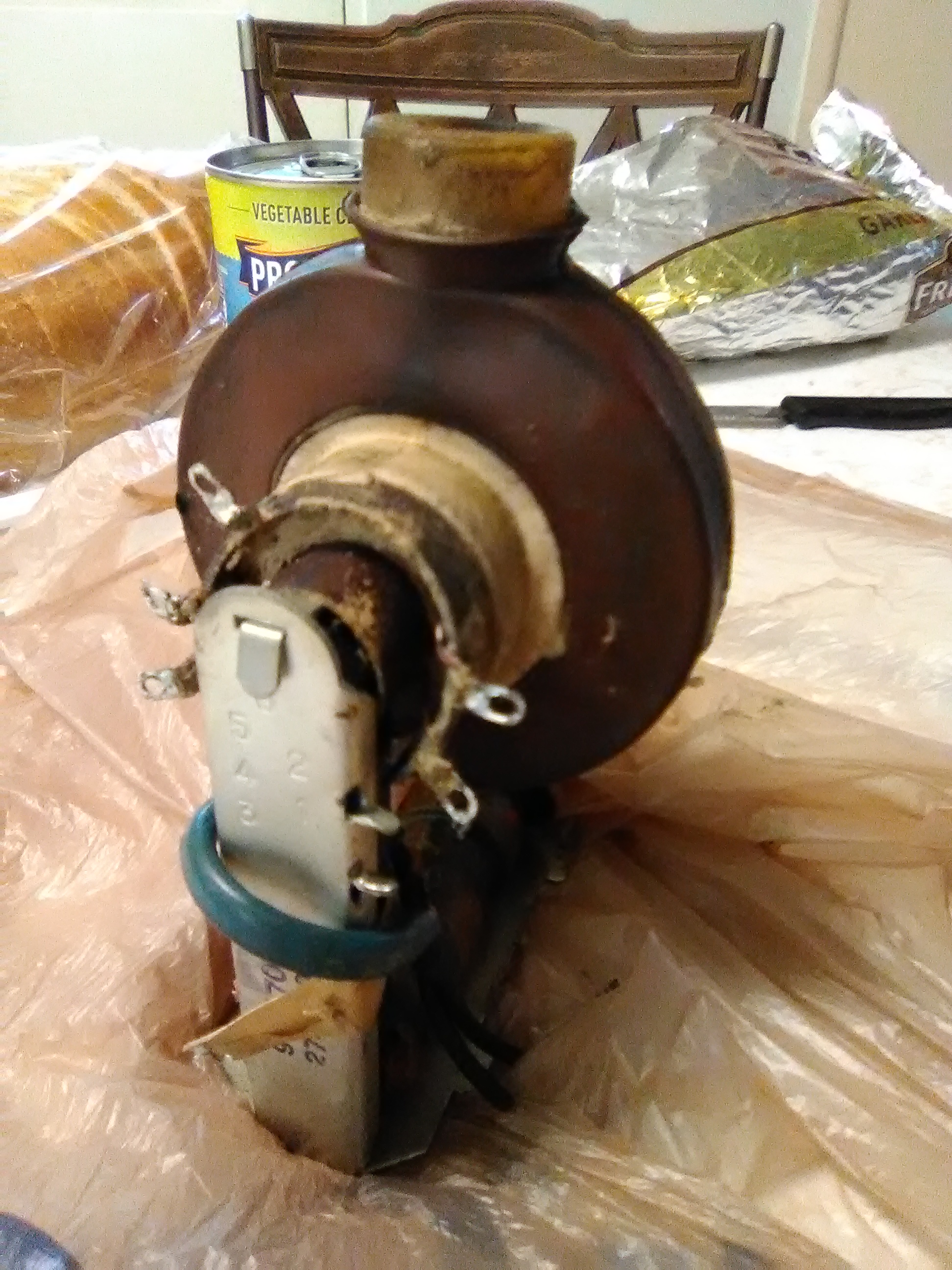

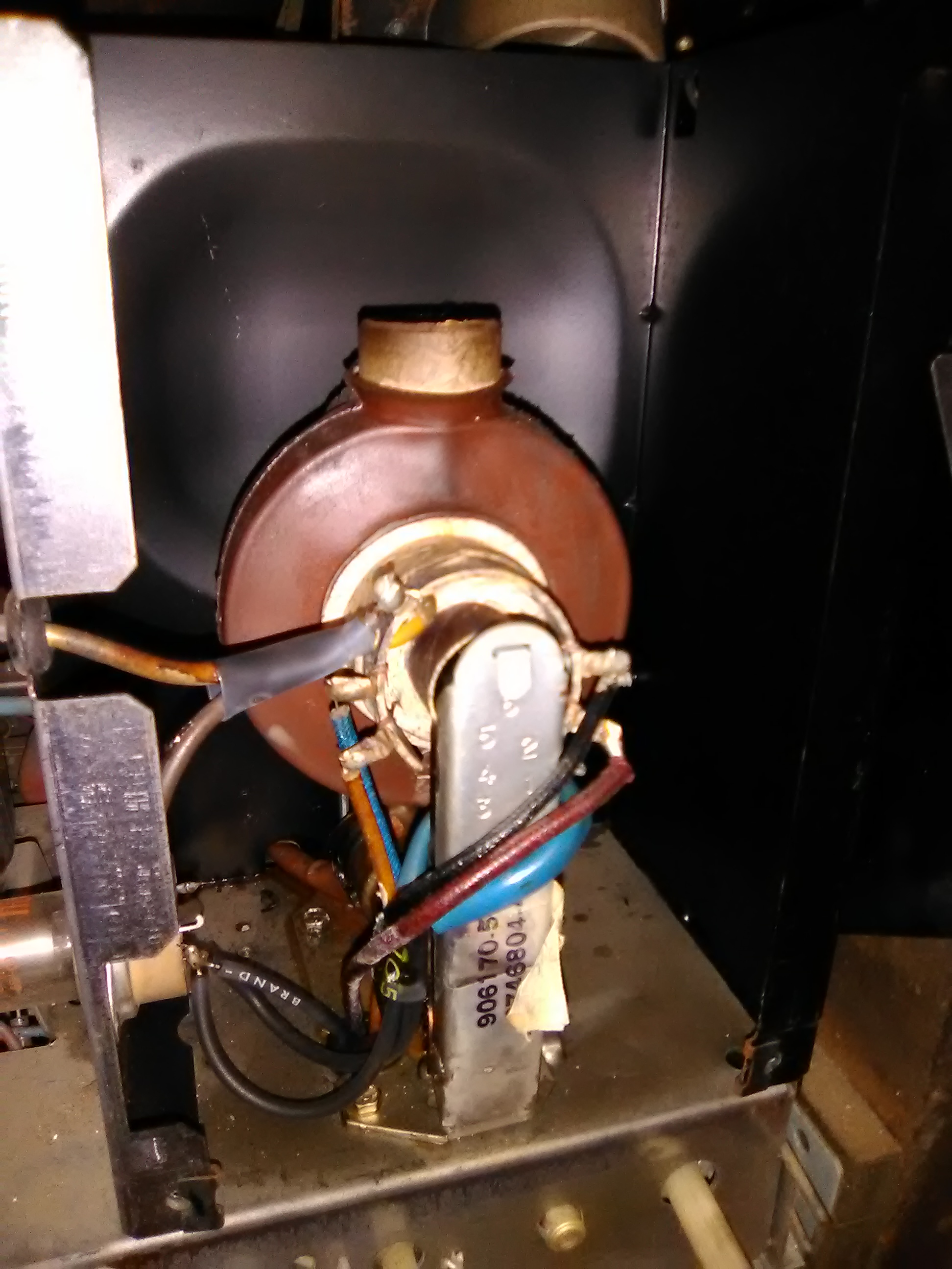

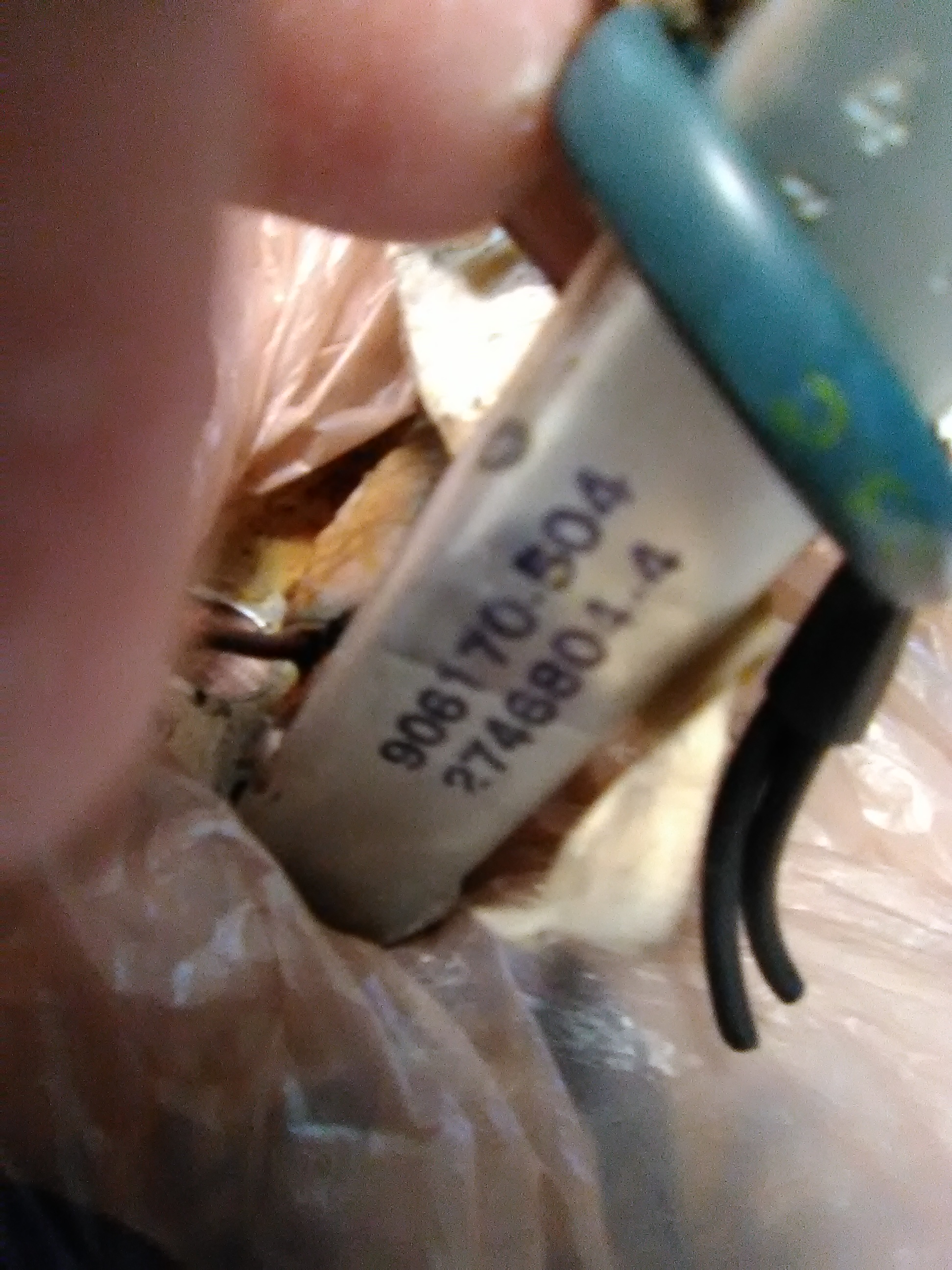

Hi and yes I would appreciate it if I was able to purchase at least one of your flybacks. I wasn't sure if you needed pictures of the one I have which was starting to burn. But I can provide them here right now.
I have a few photos of the part after I already took it out of the TV. And then I have another photo of what it looked like when it was in the TV set and how it is connected.
I'm actually starting to disassemble this television this morning to get all of the dust out. Thanks again!

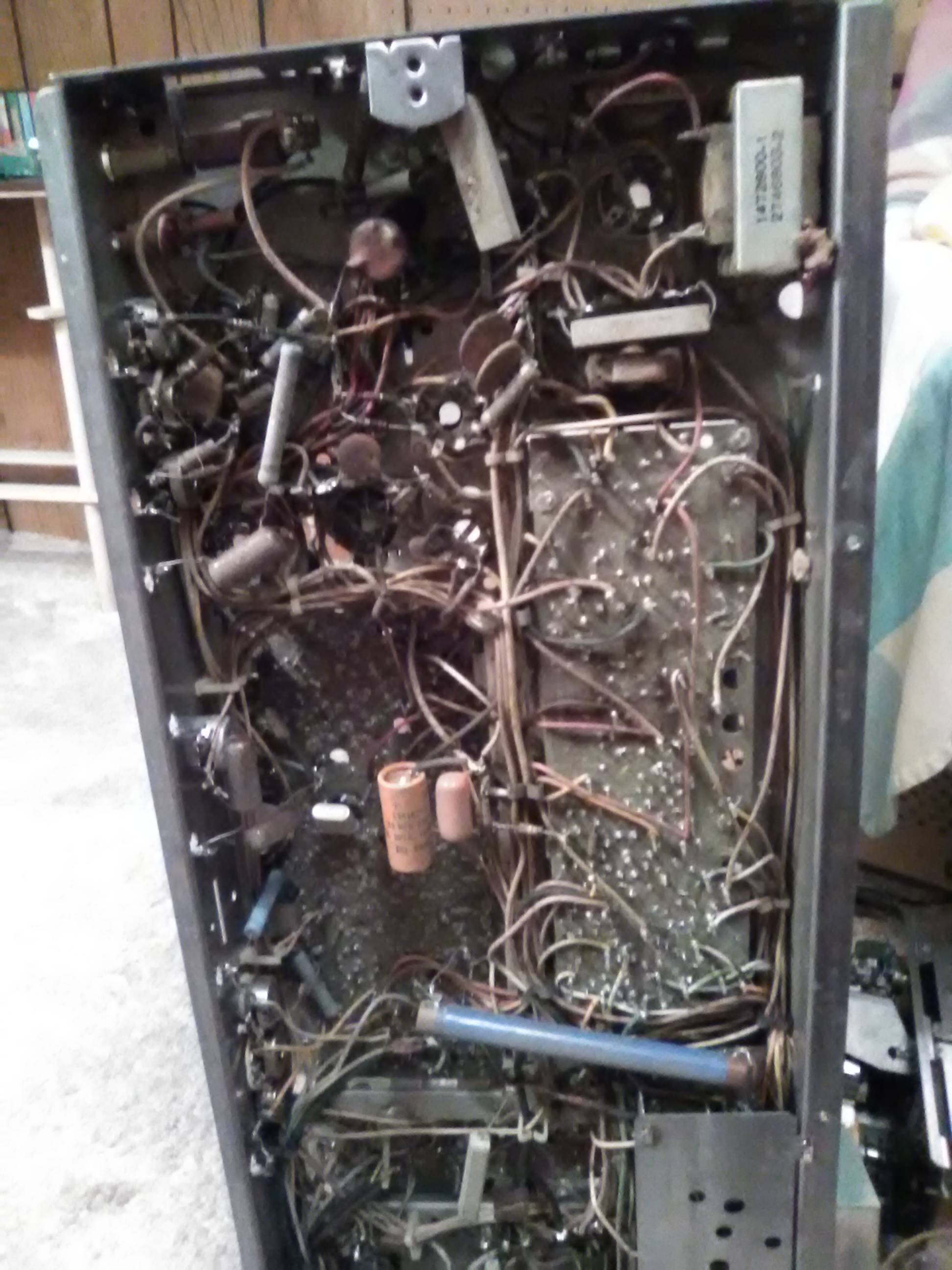

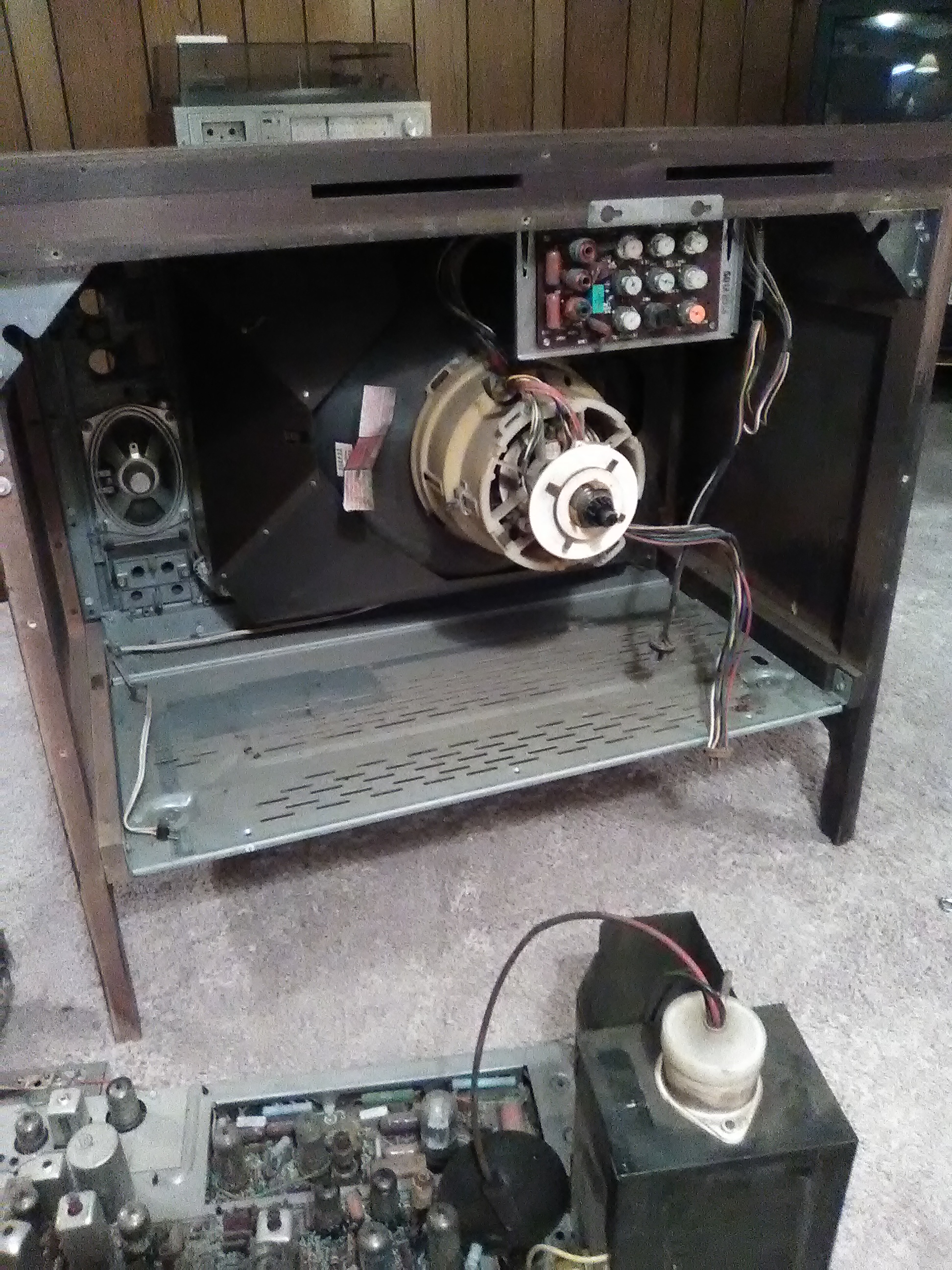

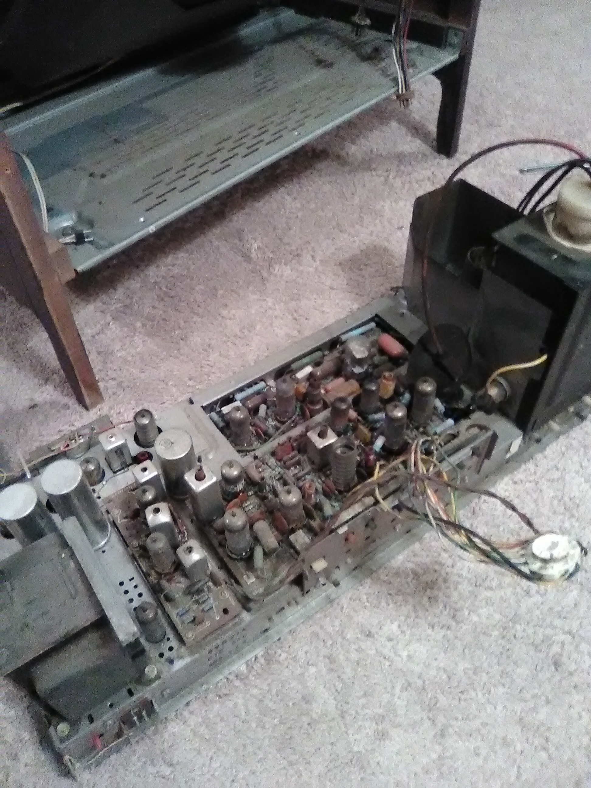

Wow, what set did it come out of?

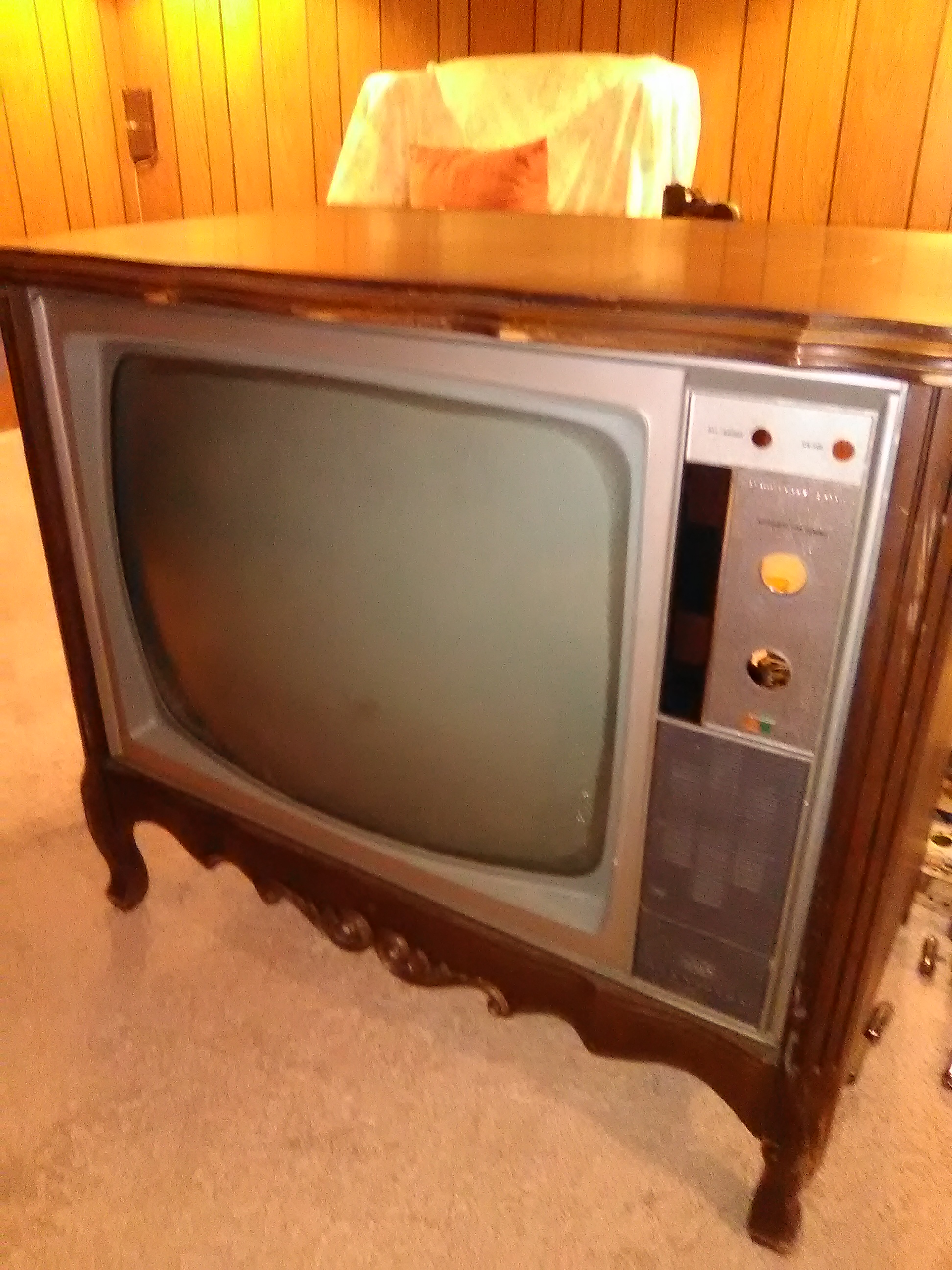

It's this one right here. I've been taking pictures of it for my Facebook page. The TV was built back in 1968. Has a CTC 35c chassis. There's a heck of a lot of dirt in here and I'm trying to get all of that out ahead of time.
I'm still going to refinish the cabinet even if I'm unsuccessful with fixing the high voltage. I bought the TV for a ridiculously low price of $1.09 on eBay. And that was just for me to secure the winning bid. I actually had to hire bids on it but nobody else wanted the TV.
It came from Nacogdoches Texas. Cost me about $116 to have it shipped over here to my house. Probably not too bad for a television that was practically free to begin with.

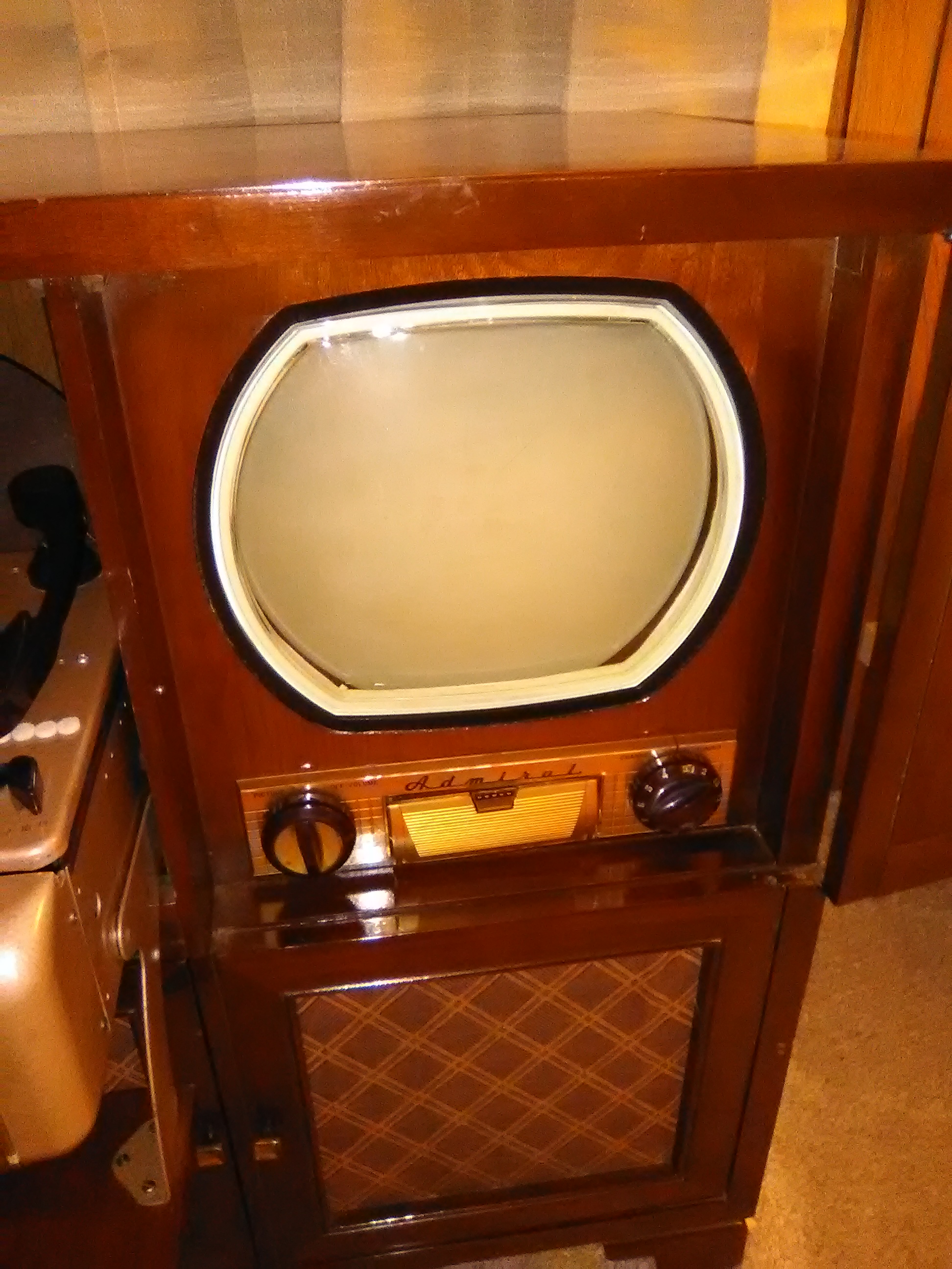

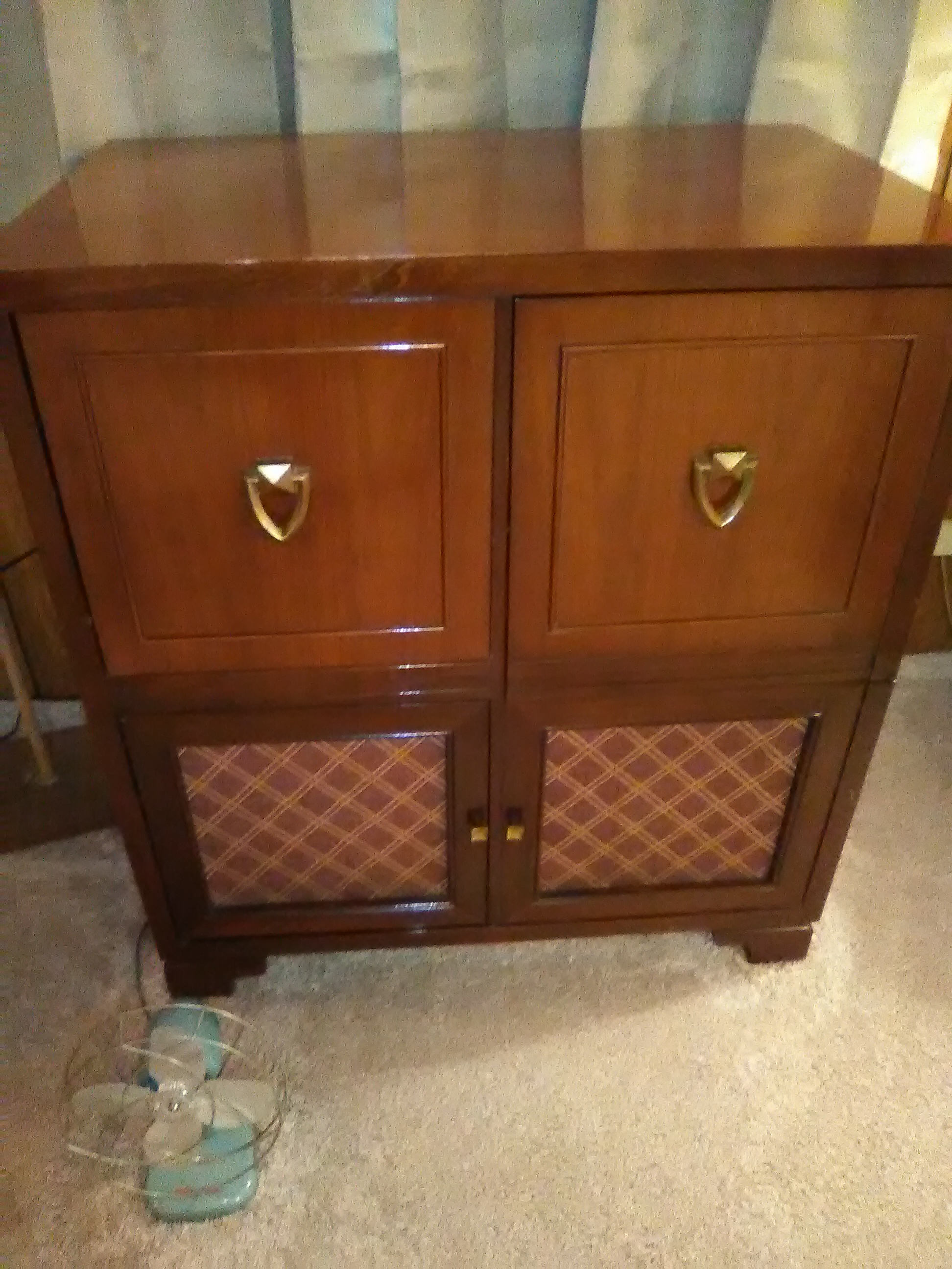

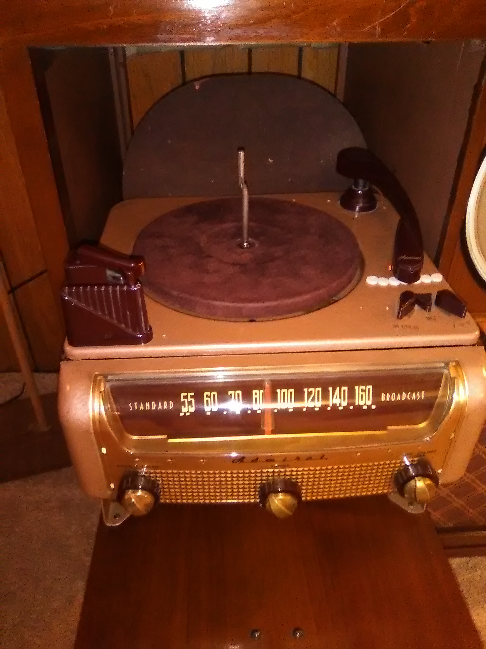

I also have this big beauty which was purchased from the Antique Warehouse in downtown Steubenville Ohio. It's a 1949 Admiral TV with an AM radio and a 3-speed automatic turntable.
I think I paid $150 when I got it about two years ago from the warehouse and he delivered it here at no extra charge. And I spent the last five months on this unit replacing all the capacitors and condensers.
Also changed wiring which had to be replaced. Replaced all the weak vacuum tubes with either good ones or New Old Stock tubes. And I also redid all the mechanical work and adjustments on the turntable.
Replaced both drive belts for the both speeds on the turntable. And installed a new pickup cartridge which will play both the albums and the 78s with no harm to the record. Also touched up the outside of the cabinet which actually has the original stain under all of the gloss coating I put on there.
The TV works perfectly other than the picture tube being a little bit out of focus, but not that bad. It's currently up for sale on my eBay account. Was hoping I would sell this for a reasonable price.
Then I could move the RCA TV in place of it if I actually get that one working.

Hi, I forgot when you asked me earlier if the old flyback I have works. I haven't tried turning the TV on with that part in there when I first got it from the other owner.
But based on what he told me, the old part was burning. And he told me there was no high voltage. I did run tests on it with my ohm meter. And the readings come up exactly the same as what's listed on the electrical schematic.
As far as if any of that fine wire could be shorted because of the break down inside, it's hard to tell.
