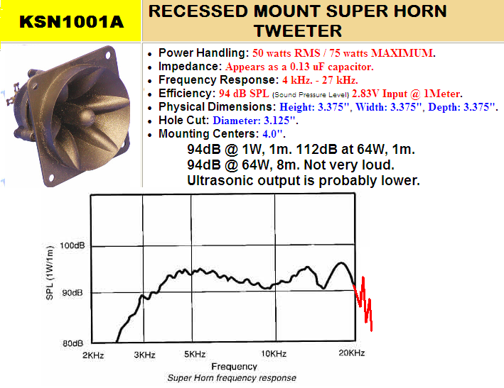

I have never used an awful-sounding cheap piezo tweeter. Motorola invented it many years ago then other companies made the same looking thing.
The sales sheet I have has a smoothed frequency response curve but I know that the peaks and nulls are actually much higher and lower. Its capacitance is rated at 0.13uF.

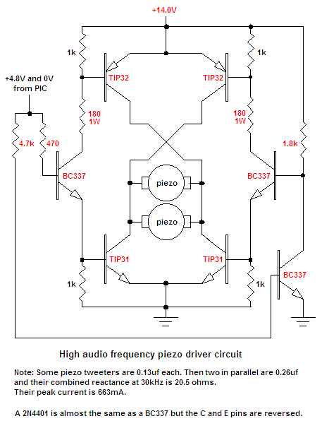

Now that you want to use two tweeters and a 14V supply then the entire circuit can be properly re-calculated.
The power in the tweeters and transistors is highest at high frequencies. I can't remember what is the highest frequency so I will assume 30kHz.
Then two paralleled tweeters have a reactance of 20.5 ohms.
With a voltage swing of 13.6V then the peak current is 663mA. TIP power transistors should be used.
The base current of the output transistors should be 66mA so they saturate well.
The base current of the driver transistors should be 6.6mA so they saturate well.
The base current of the inverter transistor should be 0.7mA so it saturates well.

I see you have 1 watt resistors for the base of TIP32. hopefully we don't have an overheating problem?
any recommendations on the larger transistors or will the tip31 / tip32 pairs switch fast enough to prevent overheating?
Will try and locate a source for the KSN 1001A tweeters.

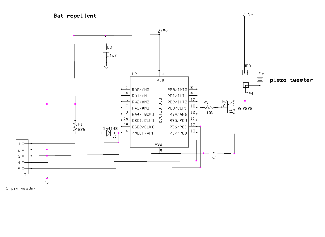

Back to a one transistor output
The present application does not need amplification so thinking of using this schematic https://www.electro-tech-online.com/attachments/bat-repellent-png.43050/ then insert an 8 ohm or ? resistor in series with the piezo tweeter to act as a load on the transistor.
The same circuit works using an 8 ohm speaker. But the piezo tweeter shouldn't put much of a load on the PIC output anyway.
Should work both ways but one better than the other?
The circuit will not work with an 8 ohm speaker or resistor. The 8 ohm speaker or resistor will draw a peak current of 9V/8 ohms= 1.1A but the 2N2222 transistor blows up with a current over only 0.8A.
The transistor would need a base current of 110mA to saturate but the 10k base resistor limits its base current to only 0.43mA. The max allowed current from a PIC output is only 25mA so a single 2N2222 cannot drive an 8 ohm speaker with a 9v supply and a PIC as its input.
On an earlier post I calculated the reactance of one 0.13uF piezo tweeter at 30kHz to be 41 ohms. Then the output current from the PIC will be 4.5V/41 ohms= 110mA which will blow up the PIC.
At 20kHz the tweeter's reactance is 61.5 ohms then its current from the PIC is still too high at 73mA.
A slightly warm transistor is not cause for concern. A heat sink would mean you have another piece of metal hanging around that you have to prevent everything from shorting.
There are two Tip-32's and two Tip-31s
seems like only one of the Tip 32 transistors got warm. At least warmer than the other one.
All the resistors are 1/2 watt except the 180 ohm which I could only get as a 3 watt. None got warm.

Not really worried about the heat, just wish I didn't have any warm components.
Still contemplating adding heat sinks just for good measure. Maybe make the unit last longer?
The silicon chip in a transistor has a max operating temperature that is way higher than just warm so yours will last forever.
Add a heatsink to a hot transistor that is hot enough to burn you or melt plastic.
Maybe your warm transistor is a counterfeit one with failed spec's (bought at RadioShack?).
All the parts on this proto type are NEW from Mouser.
It just gets slightly warm, almost un-noticiable unless one is LOOKING for a warm component

You need a complete redesign to change it to MOSFETs. Right now the amplifier is allowing both top and bottom transistors on both sides to turn on briefly at the crossover time. The BJTs forgive you because their beta (current gain) is not infinite and the current stays reasonable.
If you allow this to happen with MOSFETs they will cheerfully turn on to their Rdson which will probably be milli ohms. Current will be very high for extremely short pulses. It won't blow the fuse and the transistors might last for several days. Your radio reception might get... interesting.
If the pins on your transistors are the correct way around then a Mosfet amplifier will be only slightly louder. You and the critters will not notice the slight increase in loudness.
