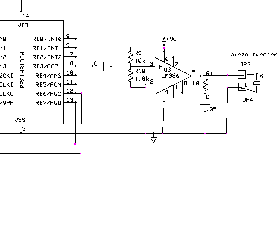

Why is the gain so high at 200? Then is its input only 0.01V peak from a microphone?
Its max allowed input voltage is only 0.4V peak. If you are feeding it 3.85V peak from a 555 or 2.5V peak from a micro-controller then the input voltage is way too high and will probably destroy its input transistors.
You need two resistors to attenuate the input to a little less than 0.4V peak and use a gain of 20.
Why use an LM386 power amplifier? A piezo tweeter or a few in parallel can be driven directly from a 555 that has a little more output level than an LM386.

The output voltage of a 555 and of a PIC are much more than the 0.4V peak max allowed input for an LM386 power amplifier. The over-voltage will probably destroy the input transistors of the LM386. So of course you must make an attenuator with two resistors.
The PIC will have an output of 2.5V peak if it feeds its signal to the LM386 through a coupling capacitor. Then the two attenuator resistors at the input of the LM386 are 10k in series with 1.8k to ground. The PIC feeds the 10k resistor and the input of the LM386 across the 1.8k resistor will be 0.38V peak.

Do it like this:

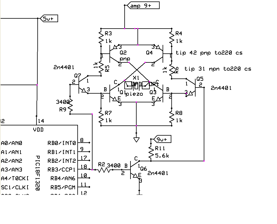

Looking at the revised amp circuit you posted, I noticed that you had to-92 cs transistors for all.
My worry is overheating as presently all the transistors are getting hot as well as the resistors.
I revised the power transistors to TIP31 and TIP42 (to-220 cs) and used 2n4401's for others.
This is ment for an automotive app thus 12-14 volts BUT think the output is really high so inserting a 9v reg thus the amp to run on 9v.
Let me know if any other suggestions
THANKS
Your cheap no-name-brand piezo tweeters have no important spec's.
I have the sales sheet for a name-brand piezo tweeter that lists the capacitance at 0.13uf. Then at 20kHz it is a load of 62 ohms. With a 12V supply, the peak current is only 190mA and the little transistors I selected have a max current rating of 500mA to 800mA.
How many piezo tweeters will one amplifier be driving?
The TIP31 and TIP42 transistors switch 100 times slower than little transistors so when driving the easy load of a piezo tweeter they are ramping (instead of quickly switching) which makes them get hot. Also, the slowly switching transistors short circuit the supply for a certain amount of time when one side is turning on and the other side is still turning off, which also heats them.

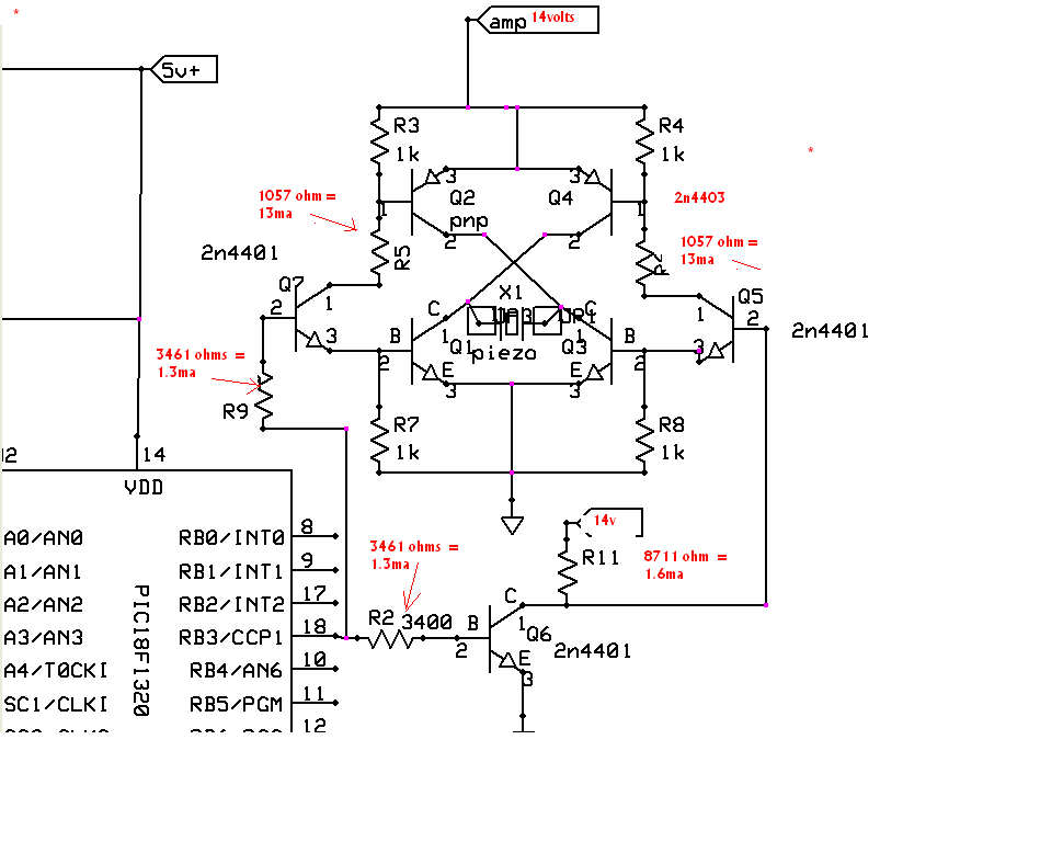

am going to hopefully recalculate to achieve same current draw on all using 4.5v input voltage and 14v power
revised for 14volts
hope this is right?
Need to order parts.
Thinking of using 1/2 watt resistors but not really needed.
I THINK I caculated R5 and R2 wrong.
When Q7 is ON then 14v to ground = 2680 ohms (disregard transistor loss) then at 9v =R5 has 13ma
with 14v R5 has 20ma
recalculating at 14v so I have 1.3ma R5 and R2 should be = 2168 each
RIGHT or WRONG AGAIN?
