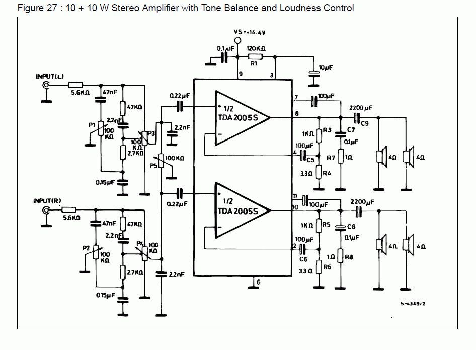

Hi there, I am doing a project with some friends and we are going to build an amplifier. It needs to be relatively simple but have a stereo output and volume control. We hope for it to run on somewhere around 12v so obviously it will not be incredibly powerful. However, we hope for it to be able to output a decent amount of sound; more than the crappy amplifier kits which are available to build normally for mp3 players. Could anyone please supply us with a circuit diagram?

I like the TDA2005 IC Amplifier it puts out 20 watts
  • TDA2005.pdf

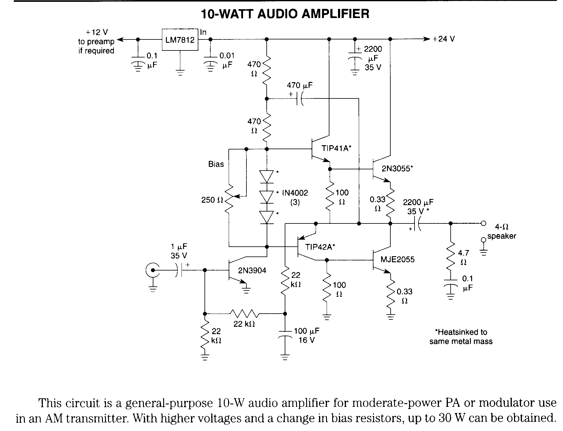

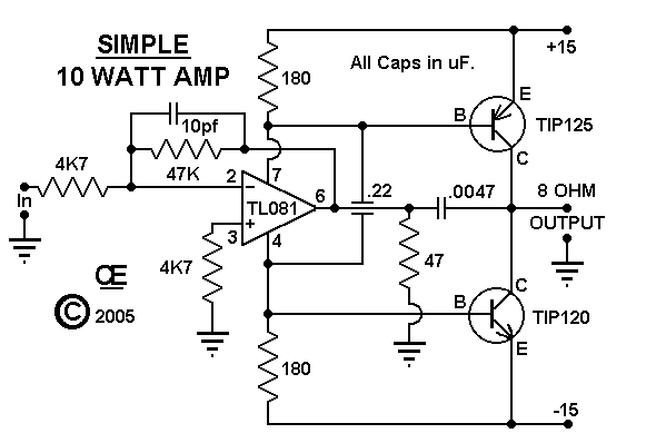

Do you mean you want discrete components Instead of IC's?
I know there is an IC
