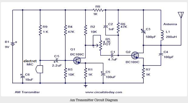

Look in Google Images for AM Transmitter Circuit and you will find hundreds of circuits like this one: https://www.circuitstoday.com/am-transmitter-circuit

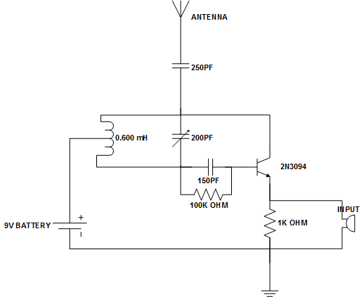

We have created our own design of an AM Transmitter with reference to the transistor modulator we learned in class. Due to trials and error with the circuit, It is working somehow but output is pretty much distorted. The range is not that long as well. We use a 200pF Variable Capacitor due to availability issue with other values. How can I improve this. The Transistor is actually 2n3904, mistype it.

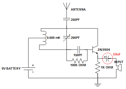

You do not show what type of microphone. Since it feeds the emitter and its resistor then it must be a low impedance, maybe a dynamic type (coil and magnet like a little speaker). The emitter voltage is causing the mic coil to be pressed against its case causing distortion. Fix it by adding a coupling capacitor in series with the mic to block the DC:

I forgot to say the range is low because either the radio has poor sensitivity or the antenna length is too short (the frequency is low so the antenna must be fairly long).
I'm guessing that you are using a carbon microphone, in which case, it will not work with the capacitor suggested by AudioGuru.
Carbon mics are very distorted (raspy) under the best of conditions.
Your transmitter has a very low power input, and an antenna that is at best about 1% efficient, so I would expect the range to be only a few meters.

Your circuit is very basic and might well generate distortion at the best of times.
To be honest if you want more range and better quality you'd better ditch the circuit, or at least modify it to one that uses 2 or 3 transistors.

An electret mic has a fairly high output impedance. The emitter of the transistor and its 1k resistor is a fairly low impedance. Then the low output from the mic is loaded down to almost nothing.
The mic needs a preamp with a gain of 20 to 100 times and a low output impedance. An opamp with an output coupling capacitor would make a perfect preamp.
Yes, something like this:
The student was probably instructed to make a Hartley RF oscillator that he showed. Then its modulation input is the low impedance emitter so it needs a low output impedance of the preamp for the electret mic.
At normal AM medium wave broadcast frequencies, a range of 20 meters is fairly easily accomplished with a 100 mW transmitter and a 3 meter long antenna as long as the antenna is properly matched to the transmitter. Proper matching is the key.
Because the antenna and the tank are connected in parallel to the transistor collector, the antenna will be inherently matched at whatever frequency the transmitter is tuned to. But that certainly doesn't mean that the circuit is optimum or the antenna is optimum. It merely means that for that particular circuit and that particular antenna, the antenna is carrying as much RF as it can at any given operating frequency.
And, there is another issue at play. At these frequencies, the antenna will have an extremely low radiation resistance, and at the same time a very high negative reactance. A 3 meter antenna will have a capacitance of about 50 pF while the radiation resistance is only a few milliohms. To get maximum range, you need to send as much RF current through the antenna as possible. The RF current is split between the antenna and the tank capacitor. The total tank capacitance is equal to the antenna capacitance in parallel with the variable capacitor. At resonance, maximum RF current passes through the total tank capacitance, but at the lowest resonant frequency, only 1/5 of the total RF current will flow in the antenna because the variable capacitor is set to its maximum value. At the highest frequency, the variable capacitor will be at minimum capacitance and considerably more RF current will go to the antenna. To maximize the range, the transmitter should be operated with the minimum amount of tank capacitance. Therefore, to operate more efficiently at lower frequencies, a larger value should be chosen for the inductor, so that the resonating capacitance can be reduced.
Of course, this causes other problems. Since the antenna is part of the tuned circuit, movement of the antenna, or moving objects near the antenna will cause detuning of the transmitter. And if the antenna capacitance contributes a larger fraction of the tank capacitance, the detuning effect will be worse. There's no free lunch. In this case, it's a trade-off between frequency stability and efficiency.
