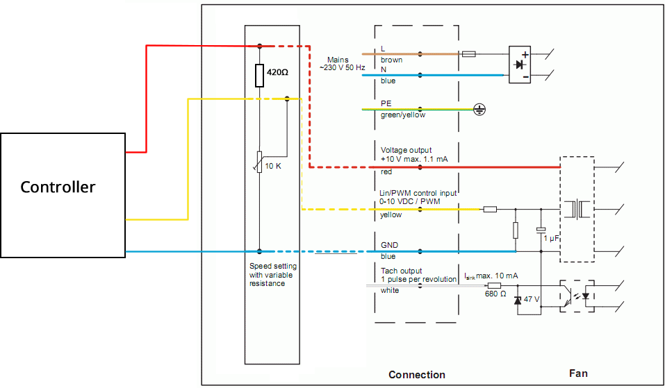

Thanks so much Rjenkingsb, that sounds to do exactly what I want. I just want to confirm,
there's no way of disturbing the original wire voltage and the controller attached? I just want to ensure what I build in will be safe.
Here's a diagram (note I added the 420ohm resistor to knock down the max voltage to 7v as that is what I measured on the signal wire, would this be okay?)
Almost; that would short the controller output though.
The resistor also probably needs to be nearer 3k9 to give the 7V limit.

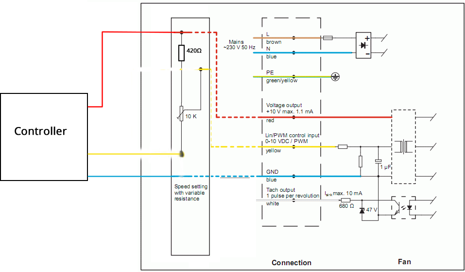

Try this:
Oh thanks yes your diagram makes more sense. I used some online simulator and was manually adjusting the resistor values to give me 7V drop from 10v input, so a 3k instead, great.
All may work well but many industrial sensors are current based outputs and voltage will depend on the resistor values used. 4 to 20mA is typical. Multiplying a 20mA current by 500 ohms gets you to 10v. So resistance above 500 will give you full fan speed if the controller is a 4-20mA style device.
