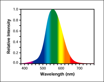

What you want is a high efficiency LED. Typical LED currents are 10-20 mA which is too much for a battery powered application. You need to find one with a much smaller nominal current and further reduce the average current by turning it on with a 10% duty cycle, taking advantage of the LED's persistence.
Use a color that has max eye sensitivity also helps :
Regards, Dana.

As noted, find a high-brightness LED with a low current requirement and run it on just enough current to make it visible.
The eye is most sensitive to color in the yellow part of the spectrum.
You can use a simple astable circuit to pulse the LED at a low frequency to further reduce its power requirements.

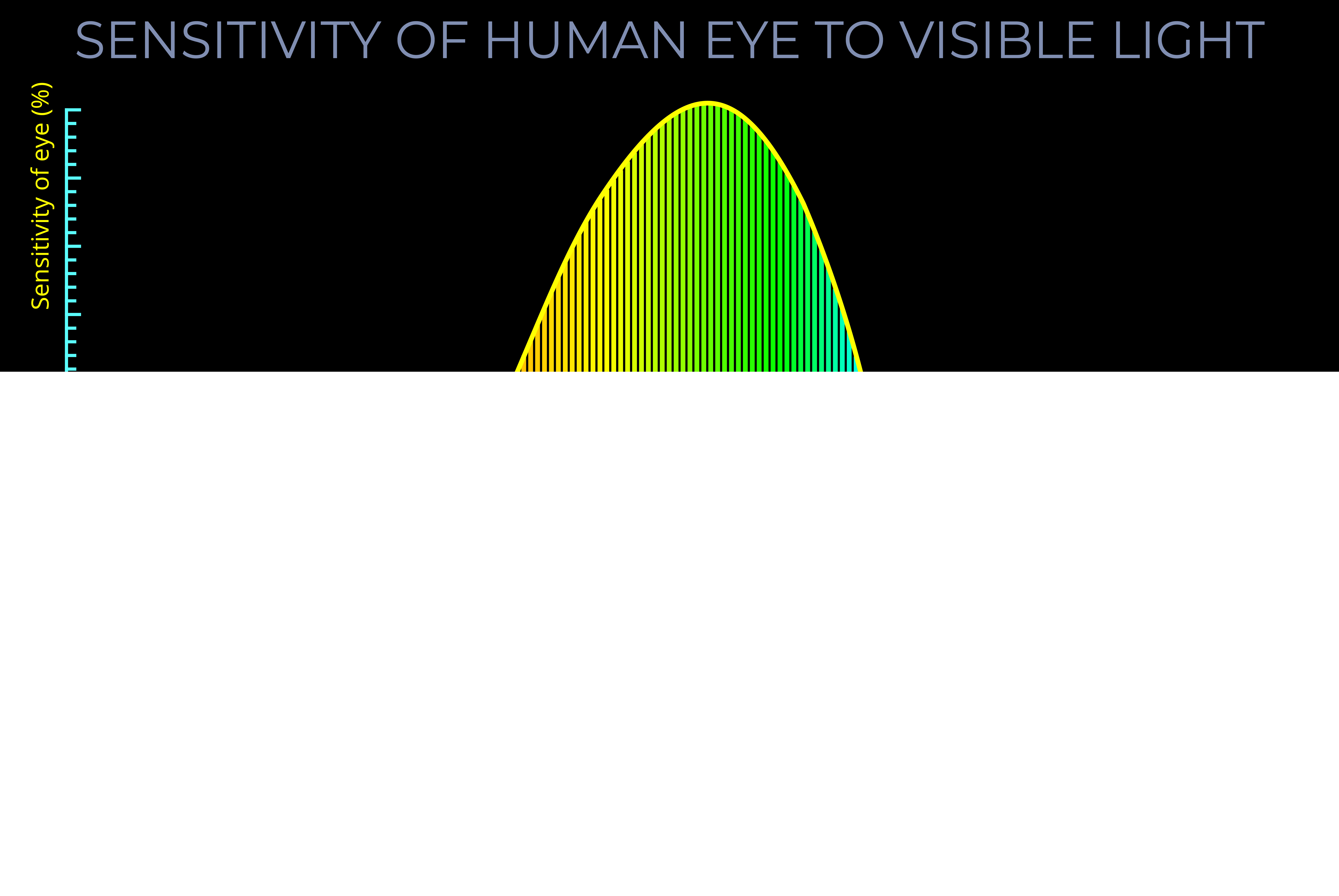

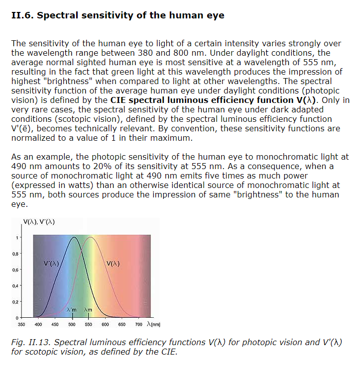

Spectral response eye
An interesting LED test would be which color is still visible at the lowest current level, which is influenced by both the eye sensitivity and the LED efficiency.
Regards, Dana.
Very interesting. While yellow may have max eye sensitivity, in advertising people will choose a red label over a yellow one.
