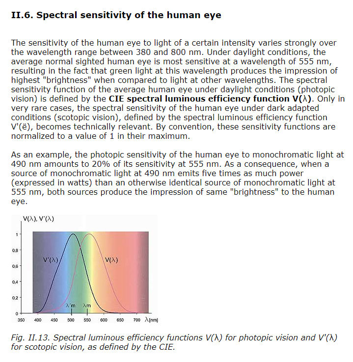

Far more important than the test current spec, is the luminosity at that current.
The part you link to will put out ~64 mcd at 2 mA.
Here is a part that puts out ~1600 mcd at that same 2 mA.
https://www.digikey.com/en/products/detail/kingbright/WP7113LVBC-D/5177420
You can either run it at 2 mA, or reduce the current (and power) significantly, and still get a usable level of light.
