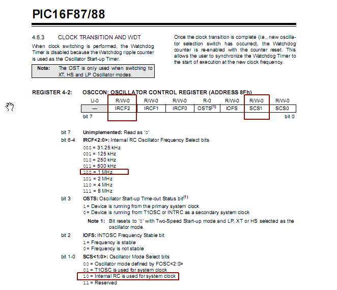

What is the frequency of the PIC crystal or if you are using the PIC's internal osc, whats freq is it set for.

Hi Eric, I'm not sure what frequency I'm using, I'm running the OSCON register at 42. It's my first PIC program, so I have a lot to learn. I have not programmed the chip and test it in release mode, only in debug mode. Maybe I should test it in release mode, it might make a difference. I test it in debug mode, on the firefly, which is an experimenter's board. I would like to do this like Futz set it up. But that'll be after I learn my baby steps.

Is that OSCCON = 0x42 .?
If yes, I make that 1MHz internal.?

That would be correct. It used to be 72, but I changed it. I wonder if it's still too fast.
Where should I add more time?
