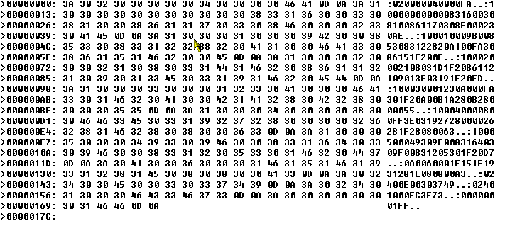

This is the hex file that was in the folder, I think it's the right one, not sure though, the pickit2 only returns 000's
:020000040000FA
:100000000000831600308100861170308F000230AE
:100010009B00853083122620A100FA3086151F2010
:100020002108031D1F2086112109013E03191F20ED
:100030001230A000FA301F20A00B1A280B28FF3E18
:1000400003192528000024281F28080049309F0094
:10005000831640309F00831205301F201F151F1983
:060060002F281E08080015
:02400E00303749
:02401000FC3F73
:00000001FF

The hex file you posted is about 50% the size of mine.! I think it must be the wrong one.?
What assembler are you using.?
