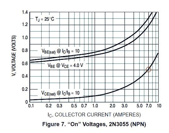

Are there any models that have a low (0.5v) Vce_sat at a collector current of like 8-10A? All the common ones I've seen usually hover in the 1-2v range.
The common 2N3055 has a Vce_sat of 0.5V at 7A collector current, with base current at 0.7A.

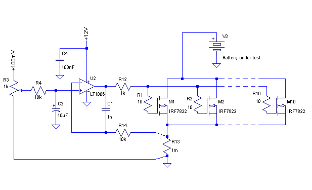

Good catch, LC. "Darlington" MOSFETs don't work!
I changed the schematic to correct this error.
Brian, why are MOSFETs out? I think this topology will work. I simulated it with the parts shown, but you could use a different op amp and different MOSFETs. You should probably get all the transistors from the same lot. I sim'ed it with a pulsed source in place of the control voltage to make sure it was stable (no oscillation) - at least in the simulation. :roll:
Keep in mind that a 1mv input offset in the op amp will cause a 1 amp error in the output.
But now you have created another problem. The measured current value now includes the base current through all the transistors but not the load, which can be as high as 10A for a 100A load. The regulator will work but there is no easy way to know the actual load current.
The following suggestion is what I have experienced in building my 25A constant current source. I metered my constant current set value from the reference leg to tell me in advance what the current value will be so I can set the value up precisely without passing current through the load. Then I use a similar Opamp configuration as yours to regulate the current. As expected, the offset and drift of the error opamp produces error between the set and actual value of 5~10% especially at low current value.
So I would suggest in your present circuit, a X10 chopper stabilised Opamp be used to amplifiy the tiny current signal first. This would produce a drift-free output of 10mV/A of which the signal can also be metered by a DVM to indicate the actual current flow. With this voltage level and a reference of 1V instead of 0.1V, the circuit noise margin increases and the requirement on the drift and offset w.r.t. error opamp is greatly reduced. One problem though is the requirement of a -Ve power supply to power the chopper opamp.
But on second thoughts, if the OP is interested in tens of amperes, a few mV offset in the circuit would still be quite OK for his purposes.
Hey, it was your idea. I just documented it. :lol:
The problem with the original circuit was that Vce(sat) was basically identical to Vbe(sat), given a large MOSFET as the driver. Unfortunately, Vbe(sat) is around 1.5V for a 2N3055.

One problem you may notice is that a proper shunt has 4 wires, 2 to carry huge currents which includes significant errors from the interconnect resistance and 2 measuring wires which carry only minute currents. An op amp's normal configuration would make a signal differential versus the "-" shunt measuring wire. So if you do a 100x gain, on 50mV shunt voltage but there's a 200mV voltage between the shunt "-" measuring wire and the shunt "-" power wire- the op amp outputs 5v but that's versus the "-" measuring input, so it'll actually output 5.2V versus ground. All the rest of the circuitry is probably going to be referenced to ground so this may be an issue.
Good observation. That's why all things are referenced to the shunt voltage connection and not the high current battery (-) connection of the shunt. This applies also to the common of the reference voltage. The voltage between the voltage tap off point and the battery connection does not add to the error in this case.
If you looks again at Ron's circuit, you can see it is done this way already. The end of the 1K POT is NOT connected to ground but to the shunt terminal instead.
