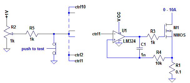

I need an adjustable loading circuit so I can load test various batteries from 1A up to 100A at various current increments. Using resistor networks to achieve the various loads is not very efficient or accurate so I thought using MOSFETS or transistors as an active load could be used for this.
What I'm trying to do is determine the discharge capability and voltage drop of certain batteries at various load currents. The batteries I'll be dealing with are 1.2v NiMH/NiCD and 3.7v Lithium Polymers for use in R/C applications where current draw can be very substantial.
To give you an idea of what I've come up with so far (and to show I'm actually trying, not just seeking an easy answer); Put a precision .01 ohm shunt resistor at the emitter of an NPN transistor, the battery to test as the transistor's supply, and a highly accurate voltage supply to drive the base. As the base voltage increases, it will increase the voltage at the emitter, and therefore across the .01 ohm resistor. The transistor will drop the rest of the voltage. I can then measure the voltage across this resistor, which corresponds to the current. I can then measure the battery voltage to see how much it drops as current increases. However, most transistors aren't capable of 100A and I'd have to take the base current into consideration (which could be substantial) for my driving voltage circuit. The resistor is just an example. I have a VERY large heatsink for the active device(s) already and have a few fans to help cooling. These test measurements will only be for about 10 seconds at a time.
Also, I know the dangers of exceeding the current ratings of these batteries, so I will be careful. The battery under test will be in an aluminum box for safety.
Any ideas on an accurate circuit for this? Can I simply parallel transistors? If I do so, how do keep one from conducting more than the others (due to parameter tolerances) hogging the current until that one blows? Can MOSFET(s) be used instead? There has to be a more elegant solution.
You simply include resistors in the emitter of each transistor, this balances the load across all the transistors. You can use MOSFET's instead, it's really a matter of personal preference, and what you have available!.
If you really want to be sure your load current is equally distributed, this will do it. It will also allow you to control the current predictably by setting the control voltage. You may want to adjust the number of stages. The current per stage is vctrl/R1.
I'm assuming you know how to choose the transistor.

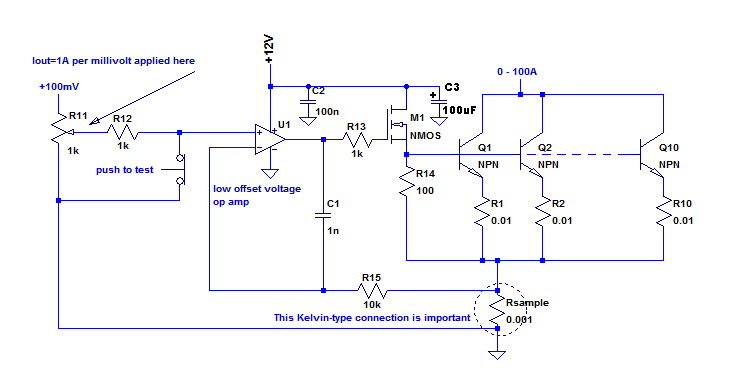

I knew I could put a small resistor at the emitter of each transistor, but that would make it hard to measure the voltage drops on all the emitter resistors at once (to be sure I am pulling the exact current I'm testing). Is there a way to directly parallel each output device (transistor or MOSFET) so I only need one shunt resistor? Since we are talking about high currents, low voltages/resistances, any deviation in tolerances in the shunts will create errors in the current calculations.
Oh, and, I had made a mistake in my original question. I'd have to use a .001 ohm shunt otherwise I'd never be able to draw 100A if the battery falls below 1v (which it will).
I want to use one shunt so I can put my meter across the shunt resistor and adjust the control voltage. The current would actually be the measured voltage x 1000 since I'm using a .001 ohm resistor. Convenient. Another meter will be hooked to the battery so I can quickly get the battery voltage.
The problem with doing it without the op amp in the feedback loop is that your transistors will heat up in 10 seconds, and the base-emitter voltage (or gate-source voltage) will change drastically over that time, causing the current to change over time also. I think the circuit below would work. It still has emitter ballast resistors, but the current is sampled in the 0.001 ohm resistor and compared with the control voltage. The op amp forces the voltages at its inputs to be equal.

Hmmm, I see your point about the feedback. I'll give that a try. Thanks!

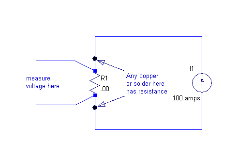

By the way, what's a "Kelvin-type connection" in your schematic? I read a little about it, but all I got from is that there is a sense and source connection and don't know what that means. At a guess, there are two sets of connections; one set for the high current, and one to take the voltage measurement? If so, why not simply take the measurement from the same connection as the high current one? Sorry for getting off track here...
You can use the same connections. The point is that none (or very little) of the measured current flows in the measuring circuit, and the voltage drop in the high current wires is not measured.
Where are you getting a 1 milliohm, 10 watt resistor? :?
Keep in mind that solder connections and copper will have resistances on the same order of magnitude. It is important to measure the drop across the 1 milliohm only, and not include voltage drop of any of the series parasitic resistance. See below.
Keep in mind also that, if you want to make your load as low as 1 amp, you will need an op amp with less than 0.1mv input offset voltage.

Hi Ron,
I think your current regulator would work better if you swaps the two inputs to the op-amp.
eblc1388 said:
Hi Ron,
Picky, picky. :oops:
The change has been made.
Thanks, LC. :)

Some filtering could be in order for the 100mV divider input.. don't want any noise (we dont know how the OP will create the 100mV source)
I would suggest a higher voltage reference circuit (2.5 or so) with filtering that is gained down (with filtering) for a quiet 100mV source.
1mV of 50/60Hz coupling is not tough to get.

Don't mind me, that must have been a brain fart. I haven't looked for a .001 ohm 10 resistor yet - I just assumed one would be available (obviously not). If I can't find one at that power rating, I'll have to parallel two or more larger resistances to get the values I need.
I definitely like that idea about using an op-amp to control the voltage. Thanks Ron!
However, I see another problem. As I said, the batteries being tested are 1.2v NiMH/NiCD or 3.7v LiPo batteries. If testing a 1.2v battery, I'm sure the voltage will drop quite a bit at 100A. Assuming a worst case transistor scenario; if the shunt is dropping .1v, that means the tranistors will have to have a C-E saturation voltage of .7v or less (I figure I can stop the current test if the battery voltage drops below .8v since anything below that is unusable anyway). I can't seem to find a commonly available transistor that has a low sat voltage when passing any appreciable current - and the more collector current, the more the saturation voltage. So, I guess I'll have to use MOSFETs?
If so, do I still have to take the same precautions when paralleling MOSFETs as I do with transistors (using a balancing resistor)? I vaguely remember something in school (15 years ago) that MOSFETs conduct less when they heat up so they in effect self-regulate to keep one from going into thermal runaway. A random check of a datasheet showing Rdson vs temperature seems to confirm this. That said, can I simply parallel all the drains, sources, and gates together and use one shunt resistor?
When choosing a MOSFET, should I simply looking for one that has the lowest rds-on and largest drain voltage as possible? Of course, I will go through the various charts to make that device will work based on my other parameters, but I just need somewhere to start looking. Mouser and Digikey have about a bazillion choices to sift through! (OK maybe not that much, but you know what I mean :))
You have a valid concern in testing 1.2V battery. I think Ron would agree that the drain connection of the MOSFET driver has to be fed from 12V instead of the 1.2V battery under test. You can use more transistors to reduce the collector current of each and thus lowering the Vce_sat.
