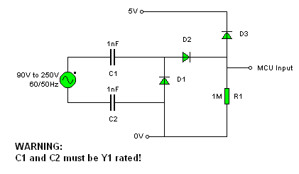

If you know that the live and neutral conductors are not going to be reversed, you could use a couple of Y1 rated capacitors and diodes. The neutral must be connected to C2 and the live to C1, otherwise it won't work if the DC supply becomes connected to the earth/ground connection which could be caused simply by touching the DC supply.

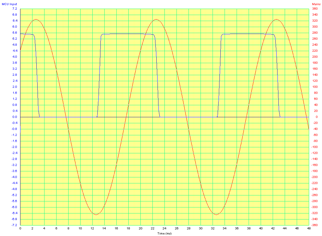

The phase shift is nearly 90° due to the phase shift in C1 and C2 so this circuit shows you when the voltage is at its peak, not zero but it should be easy to compensate for this using software.

No, I think Gayan is talking about a similar circuit to the one I posted but using high voltage, high value resistors, rather than capacitors, to couple the mains to the MCU input.
I've just realised that D3 an possibly the other diodes aren't needed with my design because they're built into the MCU.
Don't worry about using capacitors to couple the mains as long as they're low value and Y1 rated, they're perfectly safe as long as there are suitable clearances between the mains tracks and MCU side.
If you go for the resistor option, the resistors should be able to withstand a 8kV spike without breaking down and turning into a low resistance, select high voltage resistors and look at the datasheet for the withstand voltage - ask the manufacturer if you're not sure.
