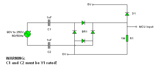

One method is to use a mains step down transformer, say 240V down to 6V rated at 2-3VA, quite small, rectify the output and sense the DC level on a PIC pin..
You can do it with an opto-isolator with a few extra components to give a 50hZ pulse for the PIC.
Thanks Eric. I forgot to mention that I want to mount it within the existing box, so there may not be room for the transformer. For the opto- isolator, would I rectify & then put through a potential divider with the opto led in parallel with the lower resistor (which I guess would be hundereds of times smaller than the upper half of the divider. And if I wanted to turn the 50Hz into DC would it be best to put a resistor on the mains side or the transistor side to smooth it?
An opto-isolator will typically use 2VA.
A capacitive coupler can be designed to use 36µA@230V which is only 8.3mVA.
The MCU will see a 50Hz squarewave when the mains is present.
D3 might not be needed if the MCU has an internal protection diode but it's probably a good idea to add it anyway.
Here's an idea but both capacitors must be Y1 rated for safety reasons!
Do not use ordinary 1nF capacitors!

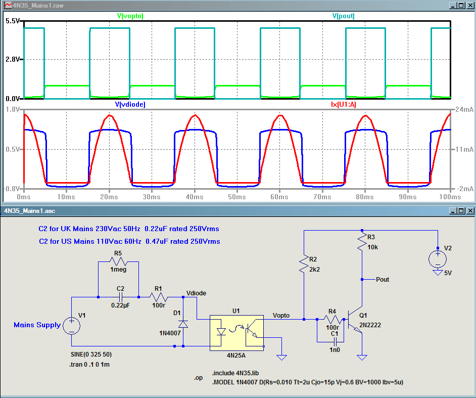

My first question to this forum was for an isolated mains indicator (120VAC 60Hz, US specs) My friend, Eric provided the solution, complete with simulation data:

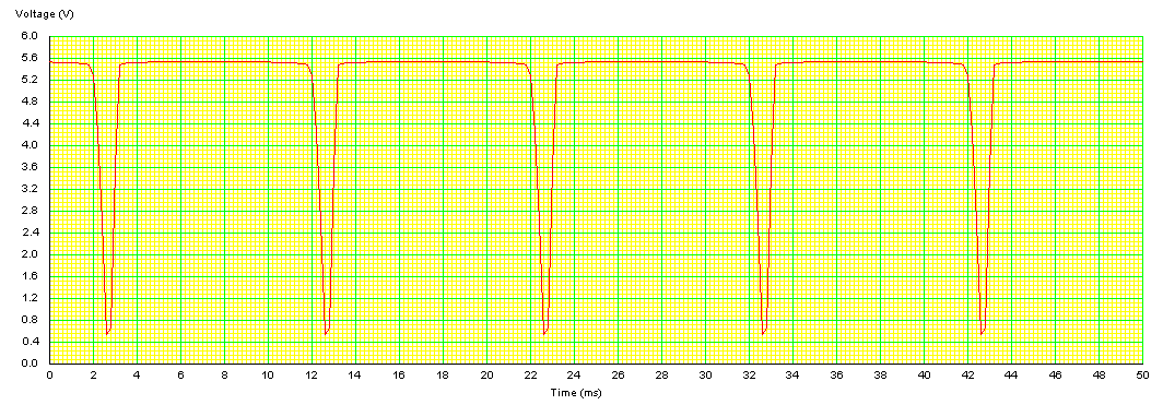

I've just discovered a potential problem with my idea.
The neutral must be connected to C2 and the live to C1, otherwise it won't work if the DC supply becomes connected to the earth/ground connection which could be caused simply by touching the DC supply.
A simple workaround is to replace D1 and D2 with a bridge rectifier.
EDIT:
I've attached plots of the the circuit, note that the phase shift is nearly 90° due to the phase shift in C1 and C2.
Here's the MCU input voltage shown against the mains on the first circuit I posted.
Here's the MCU input to the MCU shown for the second circuit when the DC supply is not connected to earth/ground. I've not shown the mains waveform this time but just as the other plot, 0V occurs just afer the input voltage is 90°, when it's at its peak. I'll post a plot with the mains if you're interested.
The waveform changes to look like the one for the previous circuit when the DC supply is connected to earth/ground so the MCU needs to be capable of recognising both waveforms. Putting a 100nF capacitor across R1 smooths the wavefrom enough for it to stay above 4.8V regardless of which waveform is present.

I had a feeling you'd say that and of course it's your decision but I'll briefly explain why my idea is perfectly safe.
Y1 rated capacitors are designed not to fail under any circumstances and if they do, they fail safe, i.e. open circuit.
A Y1 rated capacitor will be designed to withstand an 8kV spike and not be damaged.
Y1 rated capacitors are commonly used to connect the secondary side of switched mode power supply to the mains at high frequencies to remove and RF noise.
The capacitors used in the above circuit are very low value, at 50Hz the impedance of a 1nF capacitor is 3.18MΩ so the leakage current will be 72.3µA (at 230V) which is well under the maximum value allowed to pass the safety standards for domestic appliances in any country.
How the circuit works:
The tiny current through the Y1 capacitors is rectified by the diodes and the diode connected to the 5V supply (D3 in the first schematic, R1 in the second) clamps it to 0.6V over the supply voltage which protects the MCU input from the mains. R1 is simply a pull down resistor which ensures the output on the MCU I/O pin is 0V when the mains connection is removed.
In short the capacitive coupler has the advantage of taking less current from the mains but the disadvantage of requiring special Y1 capacitors.

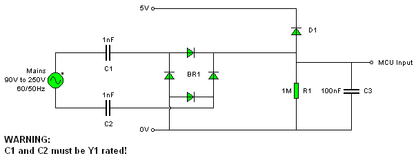

Here's the final circuit with the smoothing capacitor which provides a continuous high when the mains is connected.

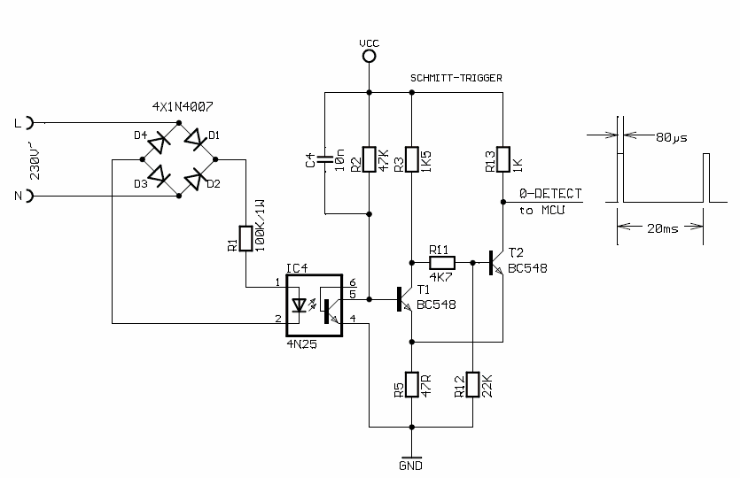

A bridge rectifier can improve the op-to coupler circuit by reducing the current consumption by half.
I used this circuit for a zero-crossing unit to be connected to an ATtiny2313.
You might omit the Schmitt-Trigger.

Boncuk;
I like your circuit. I'm fond of discrete circuits, even if its only because of nostalgia.
One question: What is the purpose of the capacitor in parallel with the collector resistor?
Hi schmitt trigger,
I was in need of a very short pulse to automatically adjust triac firing between 46 and 54Hz mains frequency. The cap takes care of those short pulses.
Boncuk
