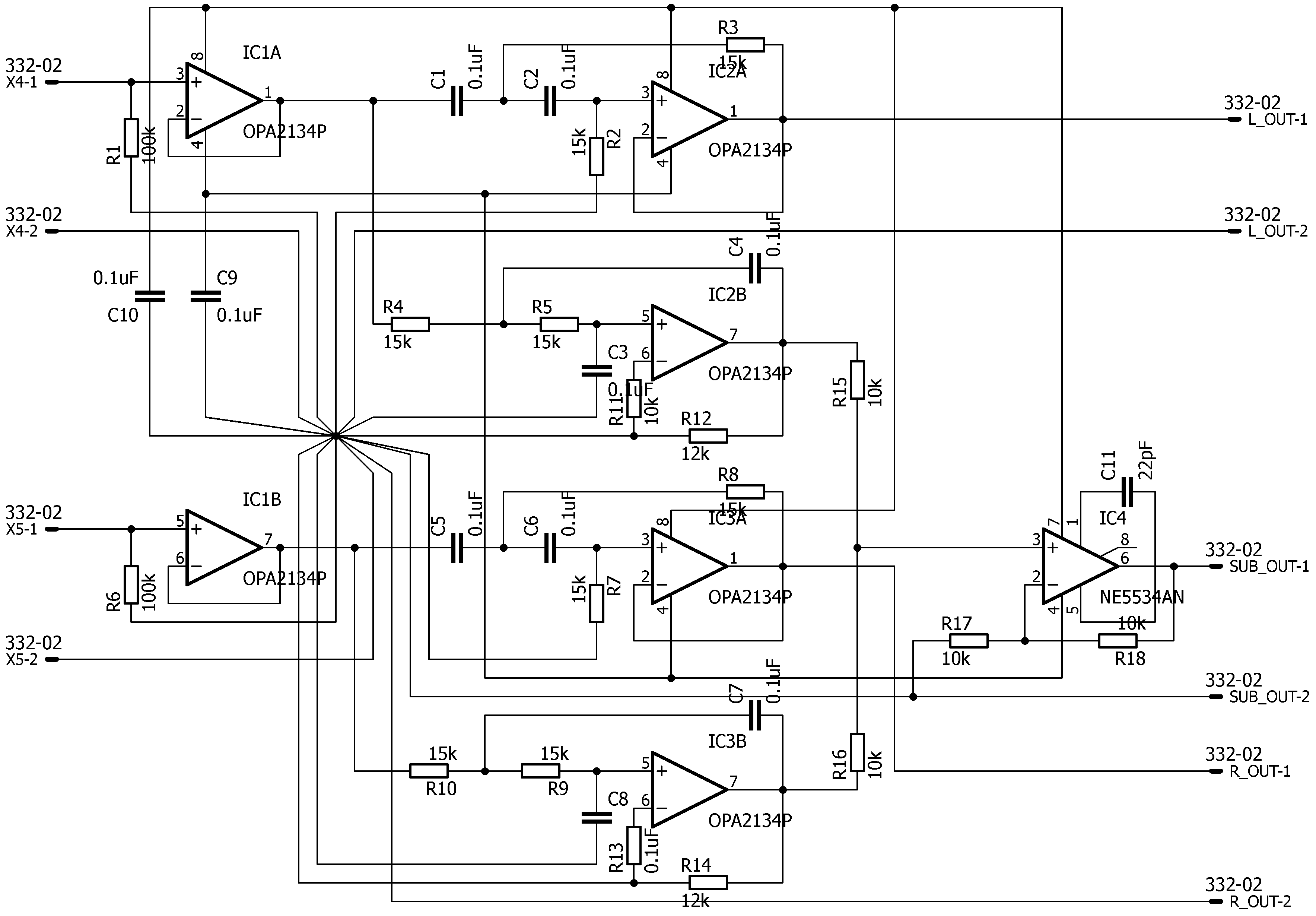

My active crossover, certain has many error:
Impressive and well executed.:cool: A good schematic layout helps a lot to understand, check, analyze, modify, and fault-find a circuit.
Suggest these minor amendments to reduce cross-talk and possibly improve PCB layout:
IC2A change to IC1B
IC3A change to IC2B
IC2B change to IC3A
IC1A and IC2B need a 47 Ohm resistor between their outputs and the high pass filter inputs.
Are you planning on combining the filter function and preamp all in one to reduce the number of gain stages that the audio signal goes through?
One thing I did notice is that you have two low pass filters where one could do the job. This can be implemented by combining the left and right audio channels, for the bass channel, before the low pass filter. On reflection I am not sure if it is better as the signal overhead may be less with a single low pass filter- something to think about.
In an amplifier chain there is always a trade off between distortion, dynamic range, and noise and active filters are notorious headroom thieves so this is an area to be investigated.
Why have you suddenly changed from an OPA2134 to an NE5534 for the bass sub output?

Hy Nicolai,
I have had a more detailed look at the filter and preamp designs.
This is what I suggest:
(1) Combine the preamp (mine) with your filter circuit.
(2) Replace the two filter input opamps with the two output opamps from the preamp (left and right channels) in the preamp.
(2) Delete IC4
(3) Delete IC3B
(4) Connect R15 top to IC1A output
(5) Connect R16 lower to IC1B output
(6) The output of the IC3A is then the output to the sub amplifier
That will leave one spare OPA2134 opamp (I think).

About earthing and star points: While it is good that you are attending to the earths and hopefully supply lines, it is a little more complicated than just connecting every earth line to one point. The important thing is to visualize what the opamp sees at its non inverting and inverting inputs and also practical implications. Tony Stewart mentioned similar.
As a result, you may have a few earth star points. Don't let this put you off though. The earthing can easily be sorted. The main thing is to get the topology and functionality correct. The next stage will be fine-tuning and optimization.
It is quite handy that you have posted the filter design because it will be useful for me on another project. I hope you don't mind me stealing it?:)

This is what I was thinking about for the combined preamp and filters:
ERRATA
(1) Change R16 to 10K
(2) Change R24 to 10K
(3) Change R25 to 10K
(4) Change pin identity from, 'LEFT MID OUTPUT' to 'LEFT MID/HIGH OUTPUT'
(5) Change R10 to 47R
(6) Change R1 to 47R
(7) Change R19 to 47R
(8) Change R22 to 47R
Why call output of high-pass filter is "mid"? I think should be "mid+treb.", may I am too stupid fastidious? :D
And only need one opamp in low-pass filter section, so go for NE5534?
Oh, your design not only help me to save money, it also reduce the duty on power supply, also save more PCB and space too. One dual opamp has been kicked out :D. What will happen if 12K5 arenot available in the store? Any answer if it happen?

Oh, your design not only help me to save money, it also reduce the duty on power supply, also save more PCB and space too. One dual opamp has been kicked out :D. What will happen if 12K5 are not available in the store? Any answer if it happen?
Those are only notional resistor values at the moment and not worth worrying about. You can make any resistor you like by parallel and series standard resistors.
The formula is, (R16/2) + R25= 15K
