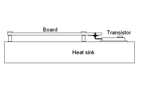

But there is too much space between 2 output transistors as your can see, even enough space for fat guy like 2SC2922/2SA1216.
Mounting board and transistor in this way, well?
It is just the mounting method, of course the heatsink will be raise up vertically for best air flow.
That will be OK, and what you have shown will be fine for an audio amplifier, but to get the optimum performance, it is best to mount the transistor in the middle of the heat sink and to have a free flow of air around the heatsink, both sides.
It is also better to mount the transistor in the center of the heatsink rather than the edge. If you do need to mount the transistors on the edge of the heatsink they should be mounted on the bottom of the vertical heat sink.
Remember that the case of the VBE amplifier transistor must be mounted in contact with the case one of one of the output transistors.
It is also better to mount the audio amplifier PCB at 90 deg to the heatsink to avoid heating the board and possibly introducing distortion. As a general rule, always allow access to all parts of your circuitry. With your present layout you cannot access the bottom of the PCCT board.

If I mount like the shown, I cannot access the board without unscrewing the output transistors?

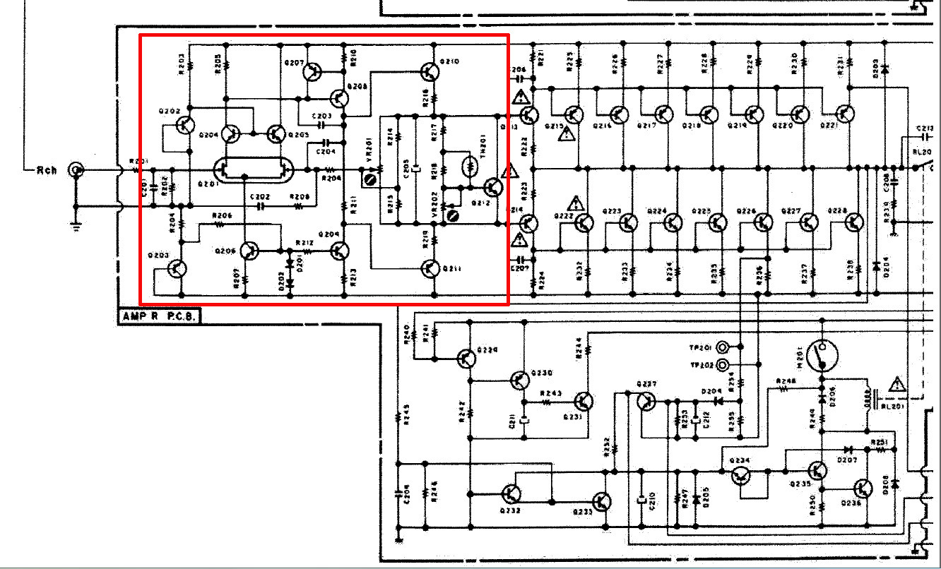

This excellent Nakamichi design, above, which I Just found on web using your transistor part numbers, does what I just wrote.
Mounting board and transistor in this way, well?View attachment 100037
Heatsink should have vertical fins and long for best convection air flow, otherwise use a quiet 35 mm fan to get a plenum of air moving at least 1m/s , volume of air like 10 CFM can be small and quiet if low RPM.
BUT air Speed is most important, so for convection , heat rises , make use of free air rising to cut thermal resistance in half and with ducted tiny fan , 10x better.
If heatsink is under board and horizontal , you just made it at least 2x hotter temp rise on Transistor Case.
Study commercial Power Amp layouts for heatsink. Fan can be avoided to prevent dust, but requires understanding of how heat rises and airspeed, with vortex and vents below and above to create chimney effect. Otherwise, use more parallel devices to spread heat.
There are many reasons this Japanese design is superior to other designs. It has only 4 gain stages, yet many transistors to with cascode , current limit and constant current front end with feedback. This results in least phase shift and most power gain*bandwidth product with ample current sharing.. Small emitter power R's with tight tolerances compensate for wide variations in Rbe , so they share current equally. Essential pots control Null Dc out and null crossover distortion.
There are many more details you should study to have an Amp that will last 60 years or more

Yes, I am going to make a thermal controlled fan speed for better thermal protection, it is also available to control speed by hand. If the fan can't cold down heatsink in some condictions, the mission is for thermal fuse..........
The pic I have shown only tell the mounting method, of course I never fool enough to turn my amp into a toast.
I have known about this way since I have learn about thermal and airflow. This way is much more benefit than using more output transistors in parallel.

Yes screwmount to your heatsink blocks access to PCA bottom.
With test vias on top, that should not hamper testability but certainly repairability if parts on bottom.
If only 1 sided board, with Cu on bottom, then design no good with heat sink under. If Cu on top only, delaminated tracks can occur easily if not careful with removing solder befor parts, so no good either, but possible for 1st attempt proto.
Why not study good layouts and build it right first time or buy surplus, garage sale
