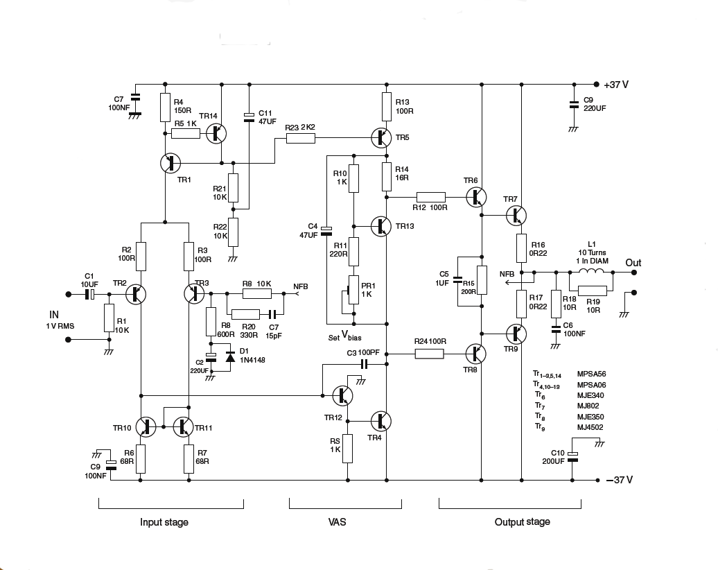

Nikolai,
I suggest that you use this schematic as the basis of your power amps. It is a classic Douglas Self design and has been optimized for high quality and simplicity. Make no mistake, it is a nice amp without being overly complex or expensive. Yes, it does use a few more transistors than simpler designs, but what is a few transistors here or there between friends.
The circuit can be inverted if required so that the two input difference transistors would become NPN instead of PNP. The performance of the amp would be exactly the same with either sex configuration.
It would be nice to get rid of C2 and replace it with a short. I will think about doing that.
Likewise it would be a good move to replace the input electrolytic capacitor with with a hifi solid type.
C9 and C10 would be better at 2m2F with pollycarbs across them.
The layout should be as shown with the similar amps in the transistor equivalent thread.
More decoupling also shown on the amp schematics of the transistor equivalent thread would also be good

VAS= Voltage Amplification Stage
The earth symbols on the schematic are misleading and should be OV supply line

Nikolai,
I suggest that you use this schematic as the basis of your power amps. It is a classic Douglas Self design and has been optimized for high quality. Yes, it does use a few more transistors than simpler designs, but what is a few transistors here or there between friends. View attachment 95493

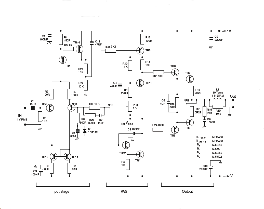

Hola Spec,
Strictly speaking, would you call the input a long tailed pair?
I would like to see the amplifier's rated load impedance and rated output power driving it.
I would also like to see its harmonic distortion at its rated power at 20Hz, 1kHz and 20kHz.
IM distortion?
TIM distortion?
S/n ratio?
I assume that its frequency response is flat from 20Hz to 20kHz?

Hola Spec,
Hola atferrari,
Indeed, that is exactly what the input stage is: a long tailed pair. But it is enhanced by having a constant current generator in the tail which improves the difference function. The difference being between the input signal at the base of TR2 and the feedback signal on the base of TR3. The funny transistor pair (current mirror) in the collectors is also a constant current generator providing a current drive for the next stage (VAS) and a high gain. But it also has the important function of keeping the current through the two difference transistors identical, thus enhancing the difference function even more. The two difference transistors and the current sharing transistors should really be matched pairs and in thermal contact with each other.
You may think that all this is overkill and so it is for an average good audio amp but even so there is more going on inside a BJT than you might imagine. One of the main factors affecting the difference amp is the transistor re. re is the effective resistor in series with the emitter inside the transistor itself. To a first order approximation re = 25/Ic Ohms. Where Ic is in mA.
As you probably well know, a resistor in that position causes negative feedback and not only dictates voltage gain but also base input impedance and other parameters. Bu re varies with collector current so it is a source of distortion. So what the designer tries to do is to make sure that both difference transistors in the long tailed pair have the same Ic, and thus the same re and thus the same characteristics.
Also the designer tries to minimize the changes in Ic for change in input signal. This also improves difference transistor performance and minimizes distortion. How is this done: by providing a constant current load in the collector. Another benefit of this approach is that the voltage gain is enhanced radically and not only that but the linearity of the VAS is improved because the input transistor base is fed from a constant current source rather than a voltage source which is more normal. So it is a kind of win, win, win situation. Of course the downside is complexity.
The type of feedback used on this amp is known as voltage feedback which has advantages and disadvantages. If you had a single transistor at the input and the feedback to the emitter that would be current feedback which has other trade-offs. Current feedback is much better in terms of open loop frequency response.
Audio designers go to extreme lengths to ensure that the input difference function is as perfect as possible. Here is a schematic showing an example of a mid complexity input stage to give you a feel for what is involved:

Nikolai,
The earth symbols on the schematic are misleading and should be OV supply line​
