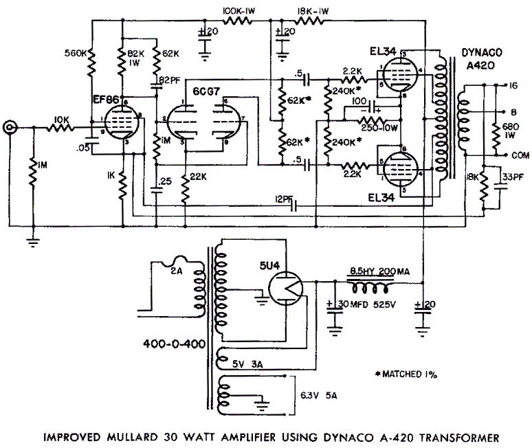

Oh no! My amp now is solid-state, I don't have money build any Western valve amp above 5W. I will build GU-50 50W amp. :D
If it is solid state then it is not the same amp. Dynaco made some wonderful tube amps, 30, 60, and 120. They were the master of that time in excellent quality kit amps. The 30 was plenty loud it made all the sound I wanted and then some.
Thank for info. I am interested in solid state amp more than valve amp. I only like using valve amp as guitar amp, where than valve distortion is more interesting.
