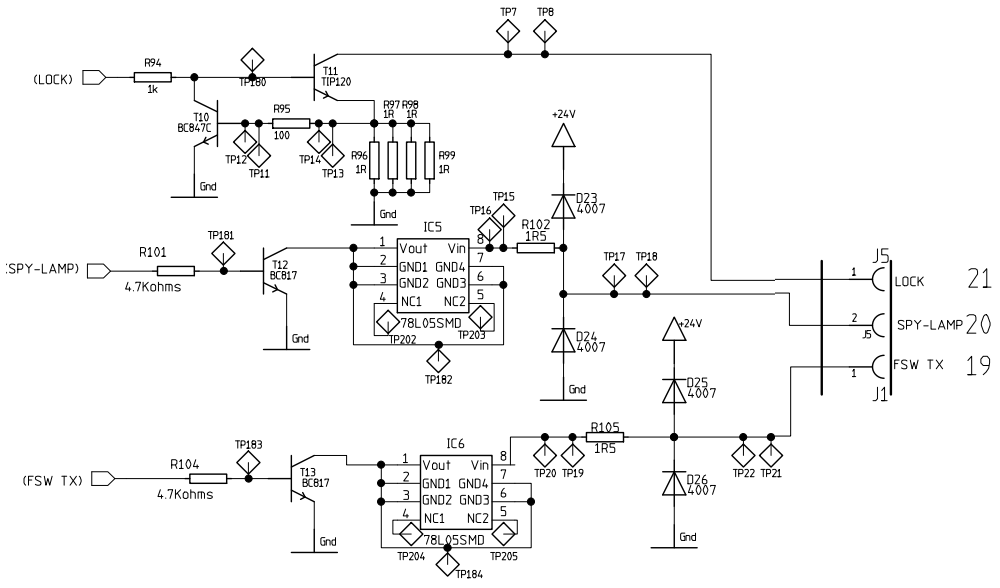

Hi.
I find a very strange circuit (gate operator) diagram.
Can any one have any clue how this 7805 work in this very strange application?
Or maybe there is a error in the diagram.

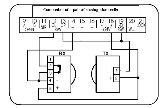

How is the load connected at LOCK, SPY, & FSW?
What kind of load(s) are they? LED? Relay?
For FSW is s "minus" for the photocell
SPY - "minus" for 24/3W Lamp.
LOCK - "minus" for electric lock coil

Looks like they are configured to work as basic constant current sources or limiters.
@tcmtech, That was my first impression too. Spent the last hour trying to find another example on Google to no avail. That regulator does have 100 mA internal current limiting. I looked at it as a limiter rather than a current regulator , which typically has a resistor from output to ground.
John
Jp: I think your assumption is correct.
The output is connected to ground.
So essentially, they are using the regulator's self-limiting output current feature, to act as current limiter for the load.

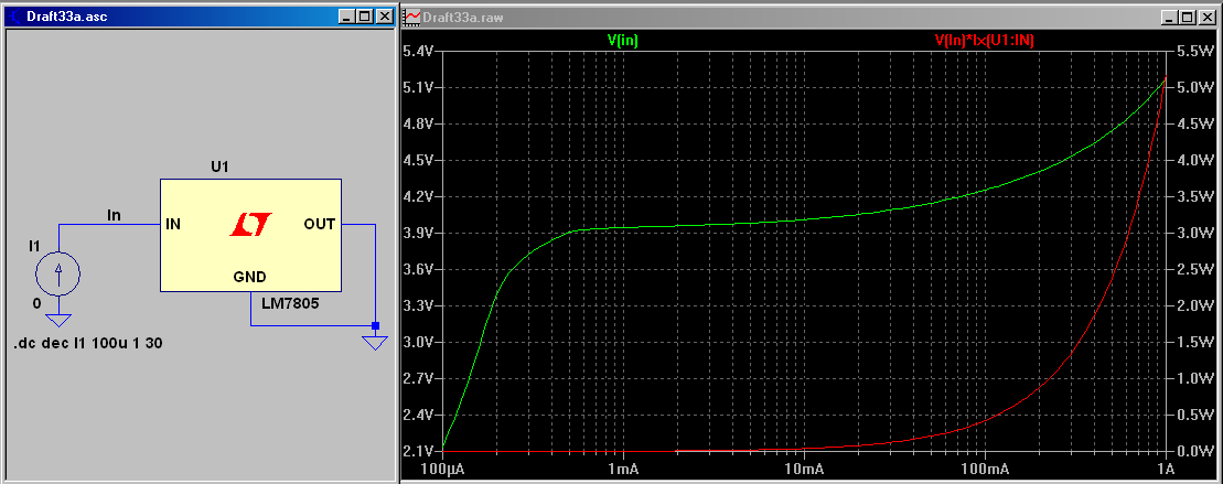

I'm not sure that this LTSpice model for the LM7805 faithfully behaves correctly when the output pin is shorted to ground, but here is what a sim shows for the voltage vs current. I know that the modelling is not realistic for input currents in excess of ~500mA because the chip would go into a self-protecting thermal shutdown mode.
The loads connected suggest that the 7805 are being used as some sort of voltage clamp during lightning. Since this is a gate operator, that might be the case.

In your original post, you ask rhetorically whether there might be an error in the diagram. Have you confirmed by direct examination that there is no resistor from the output of the 7805's to ground?
John
But if this type of a circuit is really necessary in this specified application?
Like I said earlier. I think it is for surge protection (during electrical storms).
I believe it's pin protection to protect the whole device (and possibly the PSU) in the case of an output pin directly shorted to V+.
I don't think they are designed to be "constant current limiters" during normal use.
I wrote the American company, which referred me to its technical service in Florida. Those phones were out of order until early this afternoon (03.26.13 EDT USA). The person I spoke with in Florida gave me the email address of the company in Ireland that actually designed and produces the boards. I contacted that company and am awaiting a response.
John
I think Mr. RB has is right. It looks like they are really concerned with over current as they protected the top circuit as well. May just be a poor mans current limiter.:rolleyes:
No don't have access to the PCB. I only have a circuit diagram. I hope that company will answer our question.
PS. I ask my friend and he check this on the PCB. And yes, he confirmed that the diagram is OK. LM is indeed connect in such a strange manner.
Doesn't "current limiter" imply something that limits current that flows though it? This is used to shunt current to ground, therefore it is a "voltage limiter".`
Sorry Mike you have misread the schematic. They are placed in series between the collector of the output switch device, and the output pin. (The pins on the 7805 are labelled "GND" but do not actually connect to circuit ground).
It looks to be fault current limiting to me and it's not atypical in some commercial devices.
