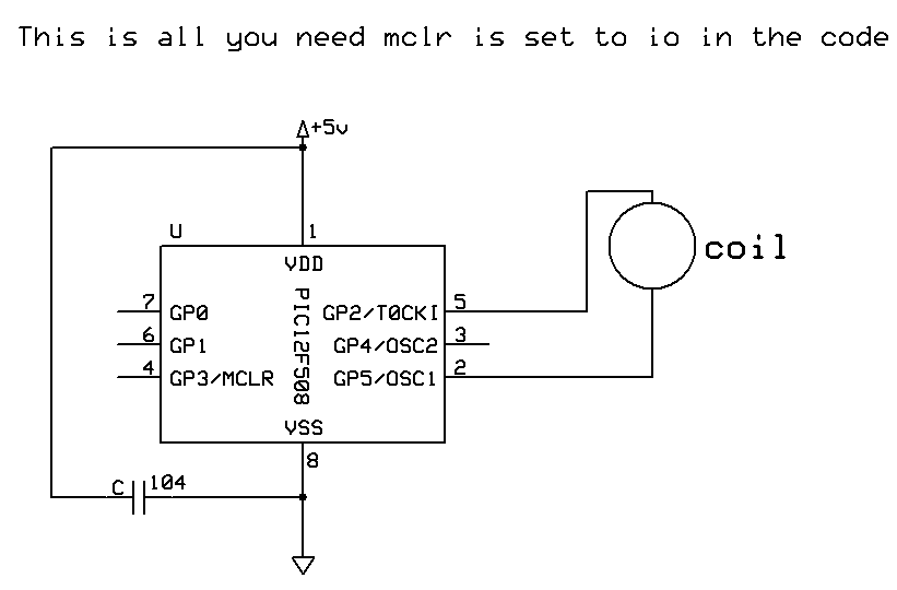

I need to learn how to connect the coil to a PIC.

That's the hex for it the code in basic simple
for a pic 12f508
@ movwf OSCCAL
lowO var GPIO.5
highO var GPIO.2
TRISIO =%00000000
GPIO =%00000000
OPTION_REG.5=0
while 1==1
         HIGH lowO
         low highO
      pause 1
         low lowO
          high highO
      pause 1
wend

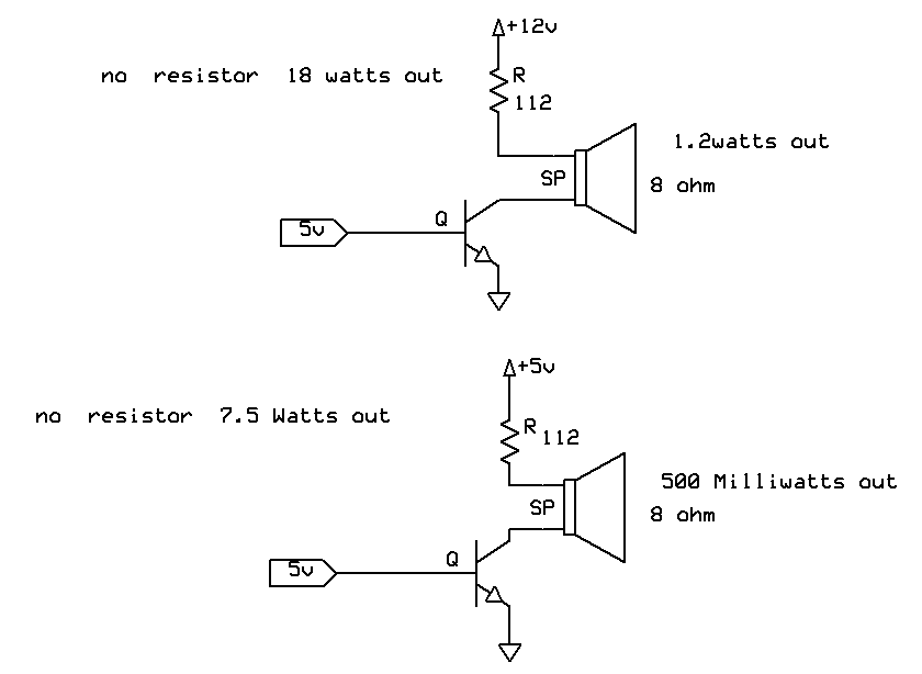

Not meaning to hi jack thread but in need of more advice
here is the H bridge I have
https://www.electro-tech-online.com/attachments/combo-hot-png.44887/
the top two Mosfets get warm after about 15 miniutes.
not allowed as this is going under a car hood - no chance of fire allowed.
any suggestions?
present suggestion is to replace the 1k resistors with 330 (going to use a 470 in parallel with the 1206-1k smd resistor on the board)
reason for diodes across mosfets?
found this schematic but no being at one with mosfets, why the diodes?
maybe prevent a warming effect?
And some one said that will work no way it's going to get hot when them bottom fet's go high. And you don't need all that to
drive a piezoelectric speaker. here **broken link removed**
borrowed computer, can't open a pdf. no adobe installed.
gonna have to wait until I get home.
am beginning to think the "amp" is over engineered.Works great but can't be getting hot.
MrDeb why can't you see simple
Think about this a amp it's little power turning on bigger power

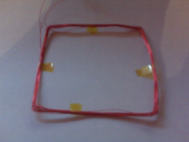

I got 15ma could get more by raising the voltage could push it to maybe 100ma @24volts ac maybe as much as 144ma
Also i was tinkling a iron core to wrap the pick up coil would work better
An iron core would add too much weight.
I interpret from reading the links to this wireless voltage transfer that an iron core would be going in the wrong direction.

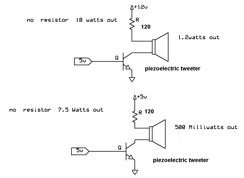

On the amp, I started out with the schematic you posted but used a base resistor and 8 ohm speaker.
As I understand it, the piezo tweeter has no impedence so the schematic you posed won't work. WHY ??
I just followed Audiogurus advice. Found several circuits using a piezo device and an H bridge to boost the peak to peak voltage.
for get the speaker use your piezoelectric tweeter with a 120 ohm 1/2 watt resistor like i drawled it then try it at 12 volts with a 120 ohm resistor 1 watt see what happens
