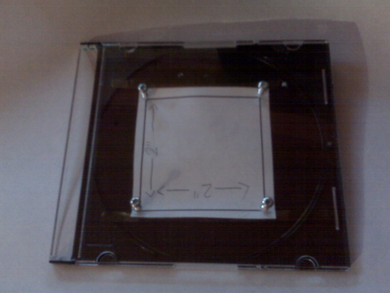

how about less turns and larger wire? like 22awg and 40 turns? Can you supply a tiny schematic on how you set this up? I dont want to burn anything out. Here is my setup for making the coil...

you should use a section of PVC pipe then you could slip the coil off easily. using screws you need to put bushings over the threads so that one or two screws can be removed to remove the coil.
I would think larger diam wire on the powered coil and smaller diam wire on inside coil. wind as a step up transformer = 200 turns on outside powered coil and say 50 turns on inside coil.
might up the current? and or voltage?
regulate afterwords=remember you need to convert to D.C so plan on at least a 2-3 volt or more drop in voltage(worst case planning).

I used the cd case cuz it small. And i can easily remove 2 screws to remove coil. PVC i dont have so im stuck on trying that. I can get but not worth a test run heh. (im too lazy)
