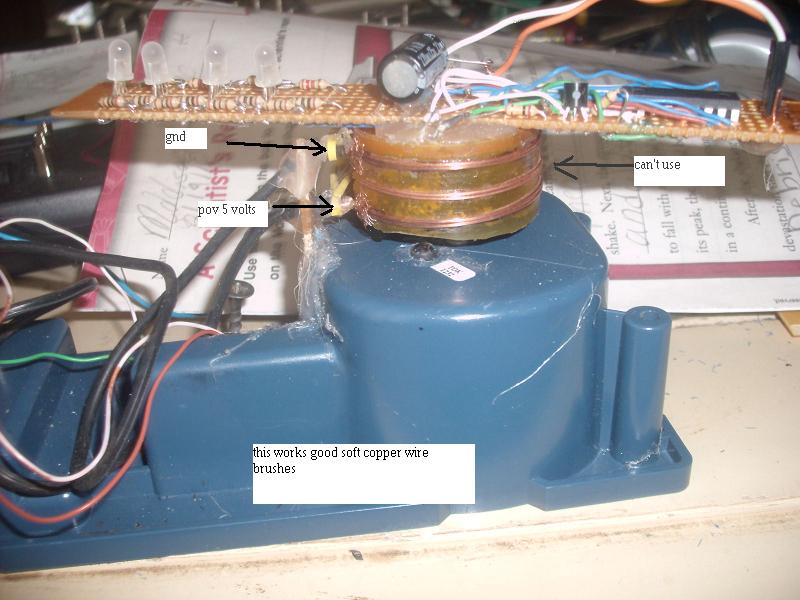

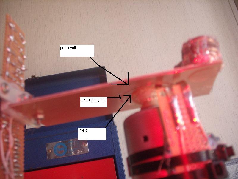

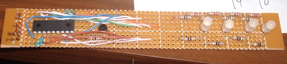

I made this last sunday using swordfish basic and a pic 18f120 and lot of hot glue
Here the spinner
pic2-jpg.46227
and board
pic1-jpg.46226
And here she is spinning

The code I have right now is real simple. I'm working on a color engine . The code is in Swordfsh basic

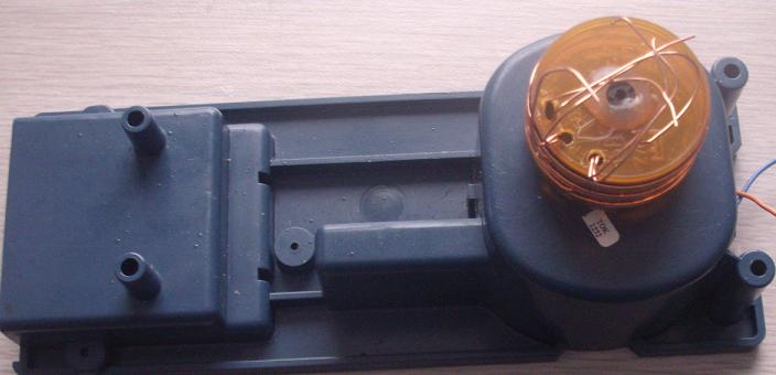

The hard part was keeping power to the pic18f1220 I made it with three brushes two for power and one that clocked the rpm of it spinning they put to much stain on the motor and it got hot real fast.
It's hard to believe you can get as many colors from just four RGB leds
I made one that scans a 6x32 using just green yellow leds but the brushes are not staying on track.
about set the thing on fire LOL
You would not believe how hot 4 AA can get don't pick them up when hot is all i can say LOL
She was just on long enough to see smoke LOL. Good thing I was using batteries if it had been my power supply and it's
15 amps who knows what would of happen.

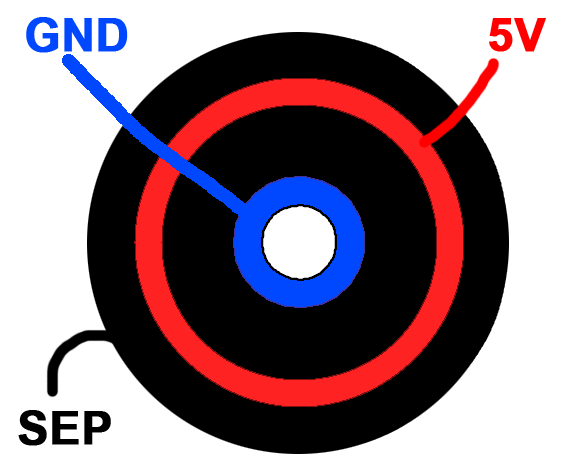

Thats the puzzler right there. How to power it heh. I guess if i make a PCB i can make 2 round traces and have one 5v and the other gnd like:
power-png.46275
The SEP = separator which will be most likely plastic or glue. And a wire on bottom or 2 small pen springs to touch the trace. and a nice cap to clean the supply spikes.

That's what I did but the 5volt + moved in to the gnd and shorted it out.
Here some pictures

what about using a motor armature and brushes. similar to an automotive alternator.
using a slot interrupter switch to control speed (count rpm)
best solution is a disk with copper on both sides(one side for 5+ and one for grd) then a slot for rpm control. Use some brushes from old motor.

my 5 volt positive brush moved over to the gnd and shorted it out. It was on maybe 30 sec. and I saw smoke coming from the 4 pack of AA. I was looking to see why it wasn't powering my pic 16f88.
Little more and I would of had a fire LOL
