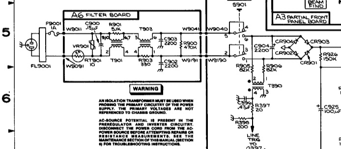

had a look at the power supply and the extract is attached.
You said a 'thermal resistor' and I took this to be the item RT901. There is a VDR item VR901 which maybe you referred to. My guess is that it is unlikely that VR901 is faulty
I couldnt find the 2 x 0.068, which sounded to me like a noise filter arrangement in the mains power supply leads. The drawing shows C902/903 which are often a 2 x capacitor with 3 leads.
Assuming that the blown thermal resistor is the RT901, then it may have failed because of a fault. I would suggest you go through the power supply and check out the bridge rectifier for shorted diodes before reapplying power after you get your parts. By using a series resistor of say 20 ohm in series with the power supply leads when you power up after the repairs, you will limit any fault current to a manageable value. This is just to get it started to check for an insanely wrong condition. If things look OK, then remove the resistor.

Yes you're right, it was RT901 on the filter board. The 0.068 cap that died was C904 on the main board. a couple of the other paper film caps in the region look a little bit suspect with their outer casings showing heat/age cracking, but no swelling. I'm going to go through the whole region and replace the caps just to be sure.
