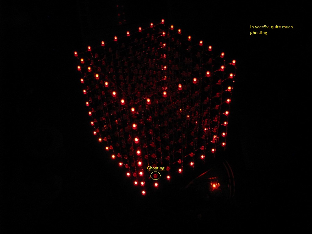

So, i made this big-ish project, and now i encountered annoying phenoma: When lower leds are lit, they light also upper ones.
Currently current for each led is about 6mA (5volts supply voltage and 470 ohms resistor)
I made earlier smaller, 4x4x4 cube, but in that ghosting wasn't big issue as cube was inside enclosure covered with mirror-plated plexi, so that forgave some ghosting. Besided it has RTC clock so main purpose is clock, but cube is decoration.

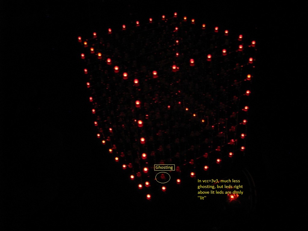

Now, with bigger cube, it looks quite stupid and messy. I noticed that ghosting decreased when supply voltage was lowered to 3v3, ghosting was tolerable.
Led current would be ~3mA.
So, i was thinking possible cures for ghosting, and i'm now asking if anyone of you would know other alternatives and feedback for these (google did show other people with similar problems, but i really don't feel like painting leds undersides now that cube is done....)
1: delay and blanking in code
no other leds have ghosting effect, only the ones right on top of currently-on ones
2: change bigger value resistors
doable, don't have currently enought suitable value resistors
3: PWM drive to layers darlington array with fet (whole cube dimming)
This would save trouble of changing resistors, but i never pwm-dimmed darlington array, so any issues in there?
4: painting undersides of leds
Yeah, 512 leds to be painted, well doable if nothing else. I did try with external led, placed nail polish and it didn't help that much

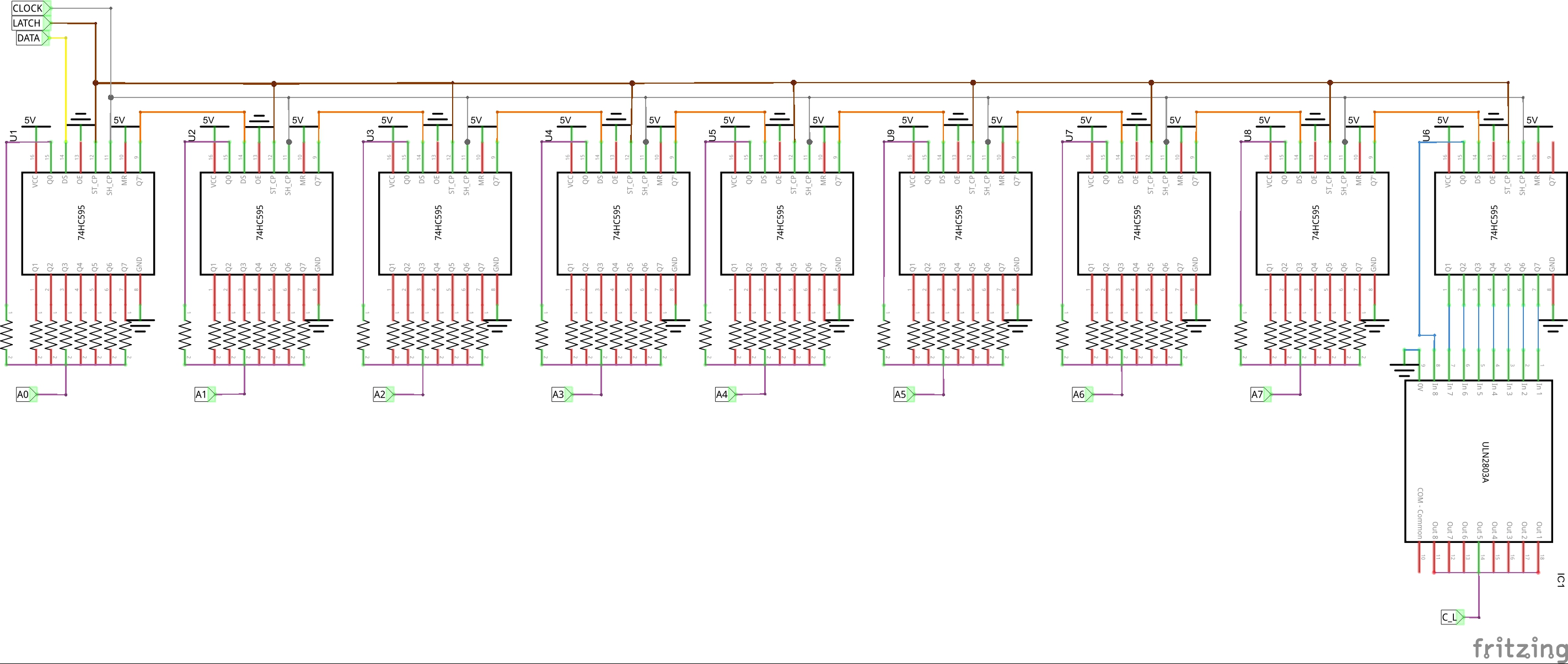

So, for help, video as well as circuit & code
in circuit AX means anodes, and C_L means cathodes_layers. Didn't wanna mess up drawing whole cube

furher tested with enamel paint, didn't have any red alcydic paint, and it did give better result than nail polish.
Since ghosting is present even in still image, painting seems to be only way....

You don't say what chip you are shifting into. Most should have latch high during shifting and then toggled low to latch the new values.

in day light and 3v3 ghosting ca't be seen pretty much at all
i use 74595 from texas instruments
https://www.ti.com/lit/ds/symlink/sn74hc595.pdf
i drive latchpin low->send data->latchpin high
Hmm, now that i read datasheet, it mentions that latchpin (RCLK, pin 12) is High-edge triggered.

After watching the video again, is the "Ghosting" caused by proximity rather than electronically?
Proximity, nearby lit leds cause other nearby unlit ones to appear dimly lit. If i block unlit ones with finger, they appear ''off'' as they should be
directly up coming light from lower leds seem to cause bigger ghosting than sideway coming light
Took couple shots to show better that issue:
I see what you are trying to do, but the ghosting is really not that bad. In your earlier video, the sine wave was quite clear even with the ghosting. On the positive side, ghosting gives perspective. You may want to consider reducing, but not eliminating it. In terms of spectroscopy, reducing it by 50% to 90% will make a marked difference, but you may still see enough scatter to give it three dimensions.

Doggy, they are reflections. I made video when testing scrolling-vu meter, this video is taken through 2-way mirror and it did eliminate ghosting quite bit:
And I also tested that they are reflections by placing finger under unlit leds, then they appear as intended (unlit)
Thanks for pointing out sand-paper :)
